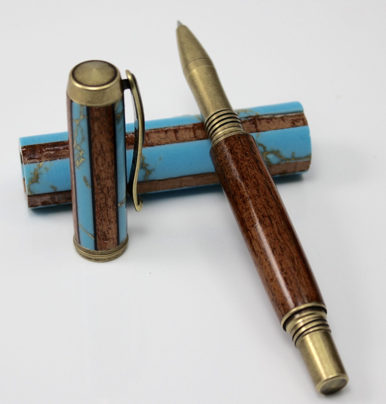

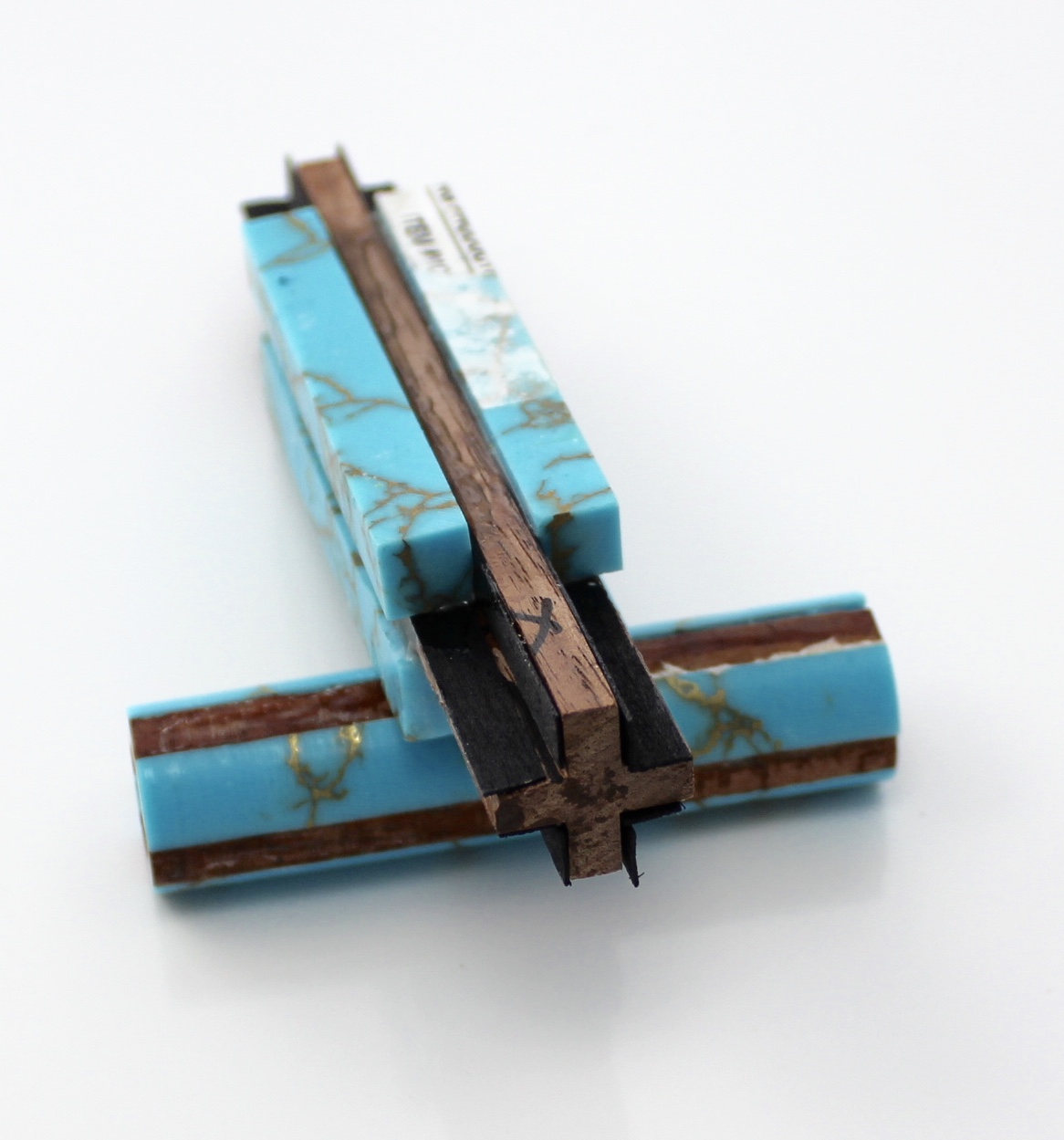

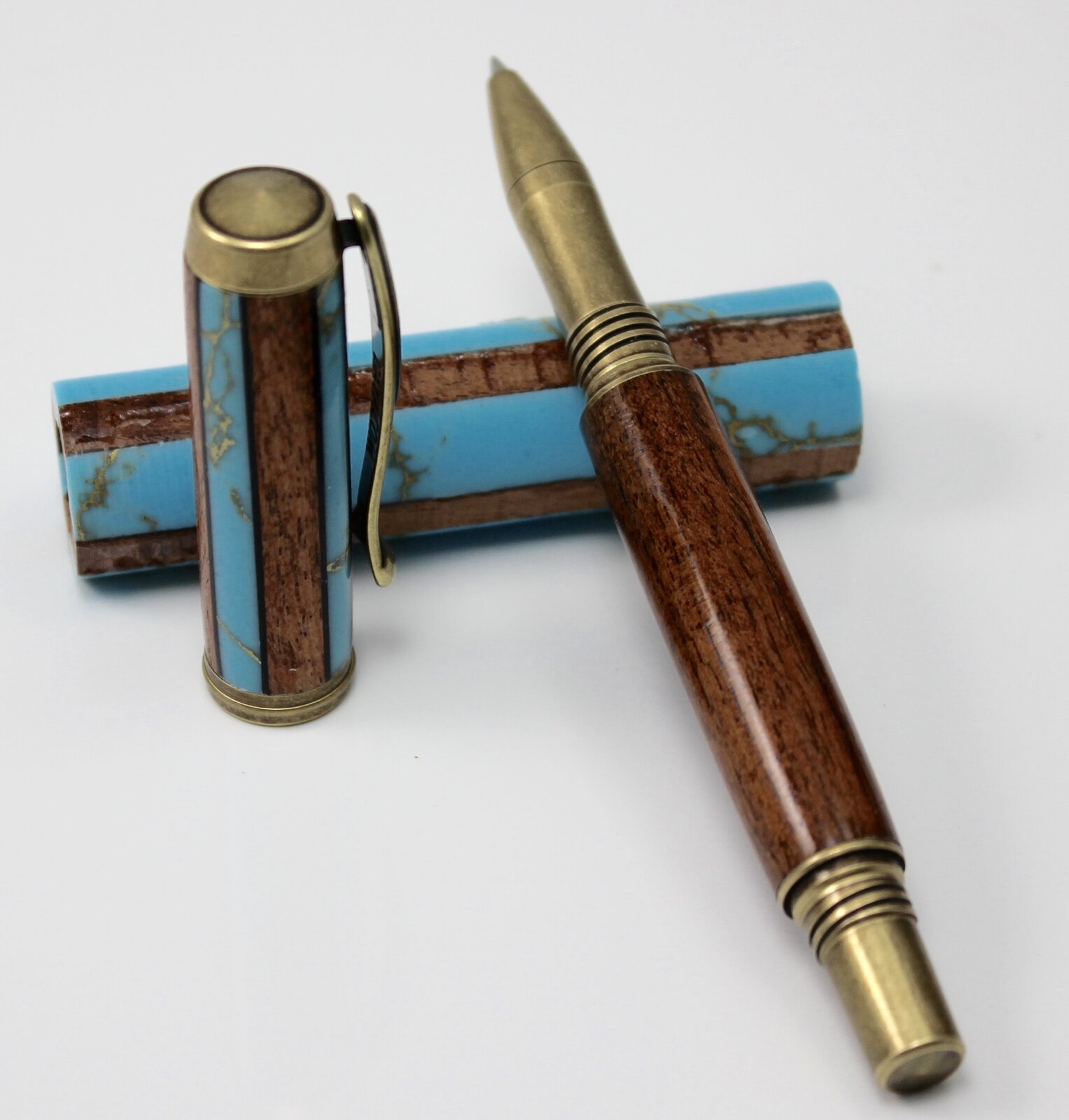

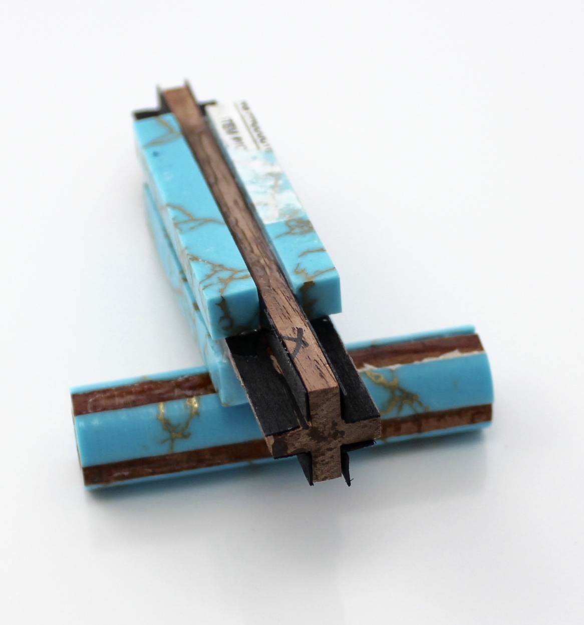

Mesquite and Gold Matrix Tourquoise Trustone.
I used 2 part epoxy, let set overnight. Went slow with drilling and turning, but did nothing special to support the sections.
