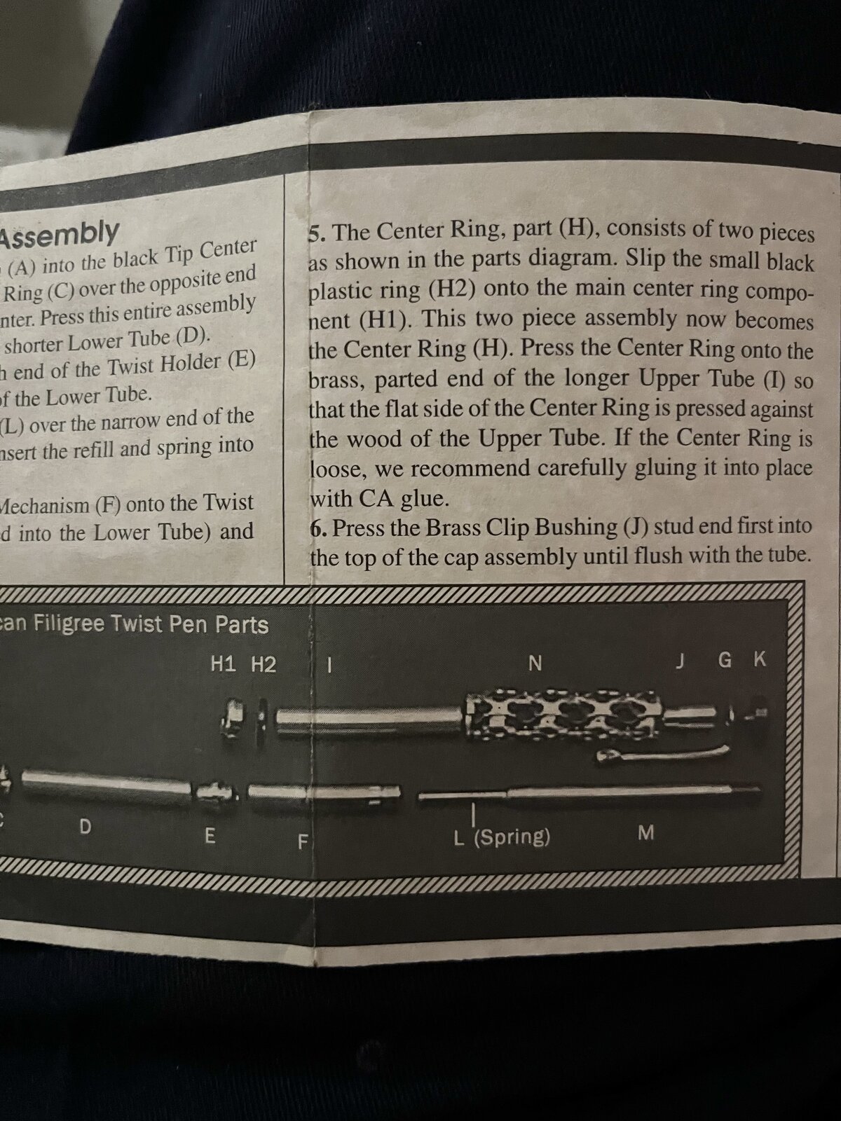

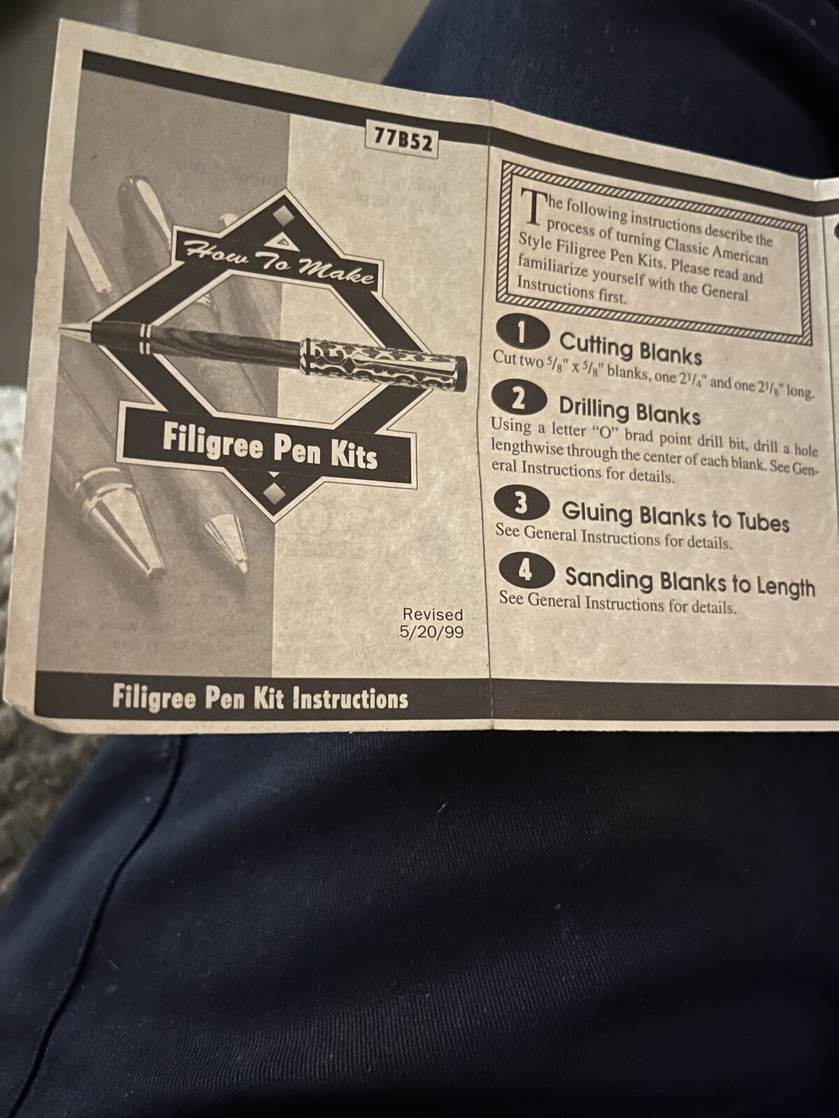

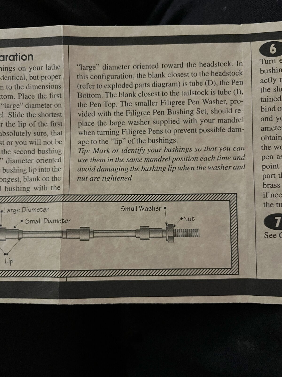

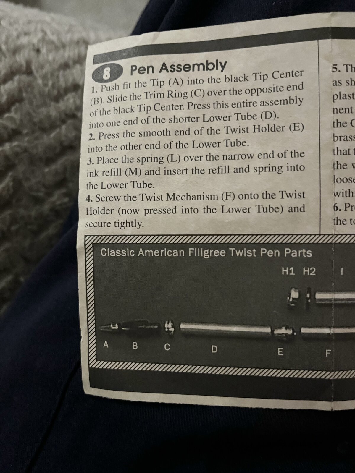

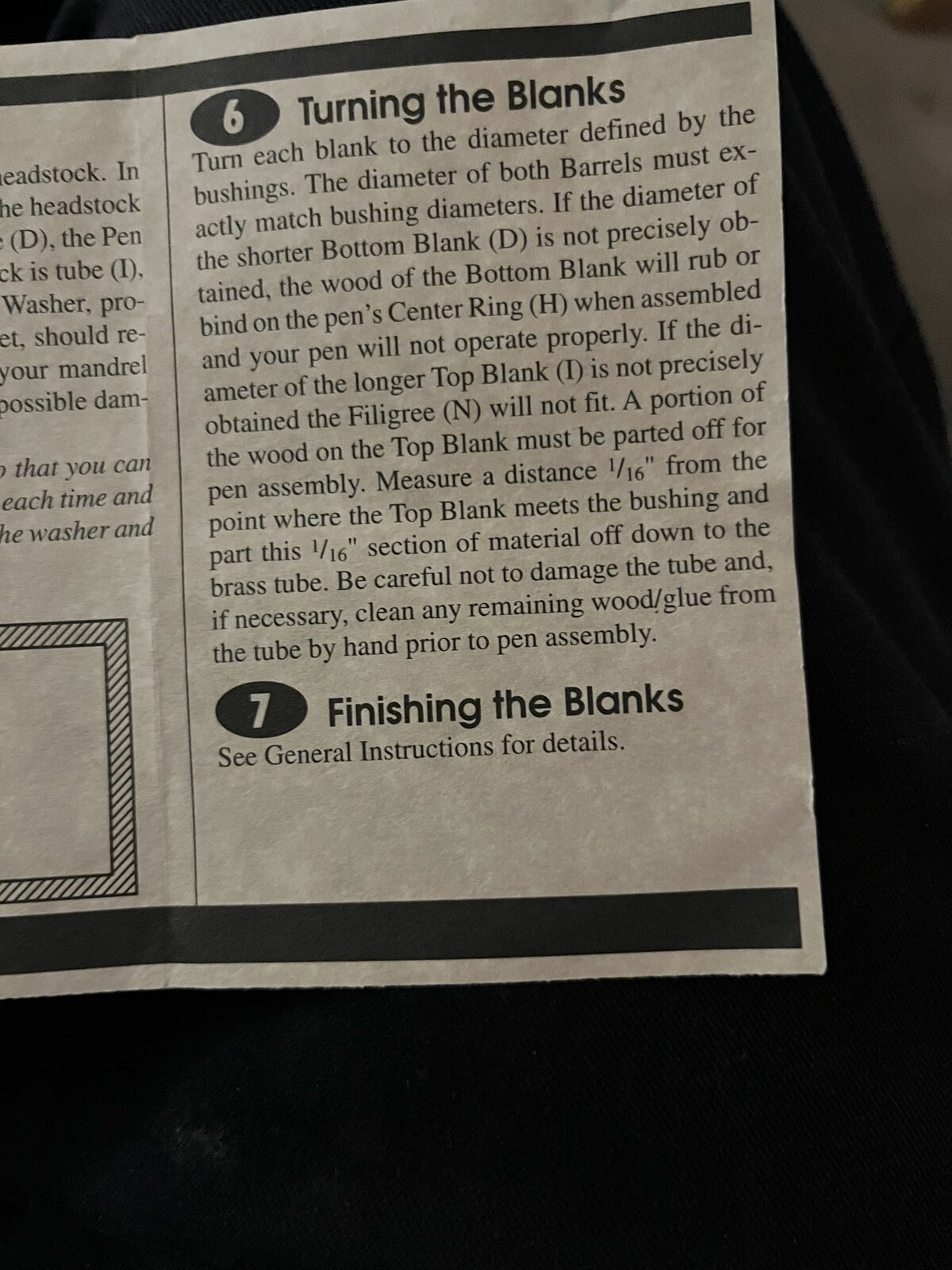

Surprisingly I found them. These are 20+ years old.

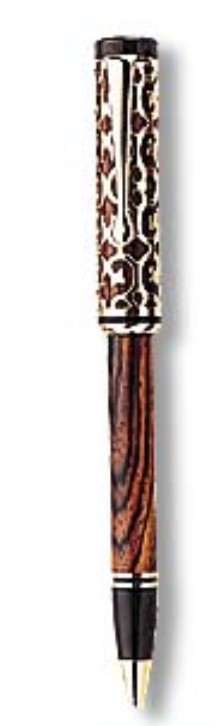

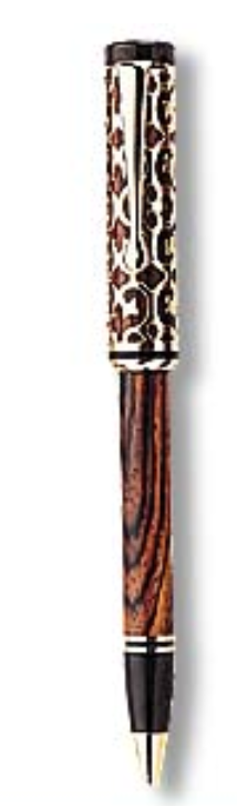

Thanks, Paul - I can tell from the 77B52 that it appears to be a Woodcraft kit. I found a photo of the pen and a 2003 version of their instructions in pdf format on the Wayback Machine. Probably not the exact kit that Peter has, but at least now we have 3 sets of instructions for these kits. Hopefully they will do the job for him.
All 3 are being added to the Bushings & Tubes app database.
