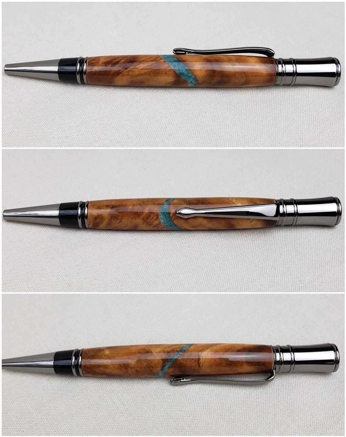

I am about to attempt a rollerball (Jr. George) with Unakite inlay as a special request. I've done this with Rose Quartz and Apatite, but both were on items with a little thickness left in the wood. I'm guessing it will be challenging to cut this down closer to the tube without destroying it. Some of the barrels end up being nothing more than a layer of veneer, though I can, and probably will, leave a fair amount more wood on it if possible. The Unakite comes in at 6.5 on the MOHS scale, so a little softer than the Rose Quartz. It will be going into Bubinga unless I can find some Beli before I start.
All I know for sure is that I'm going to grind up the stone quite fine and use a carbide cutter. Planning to use CA on it as I have done in the past, but guessing there may be a better way? The plan is to drill first, cut and glue the wood to the tube with space between the pieces, carve it down part way, then to glue the stone directly to the tube in the spaces.

@Chasper - I was planning on doing something asymmetric like the one below, though a bit wider, so the parting tool won't quite work this time. This one does have quite a bit more "meat" on the barrel by the inlay. I've used the parting tool to inlay a few magic wands and it worked quite well. No tube on those to worry about.
