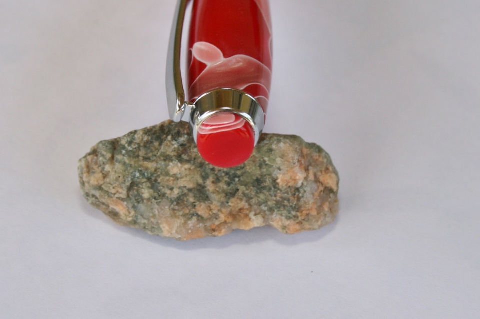

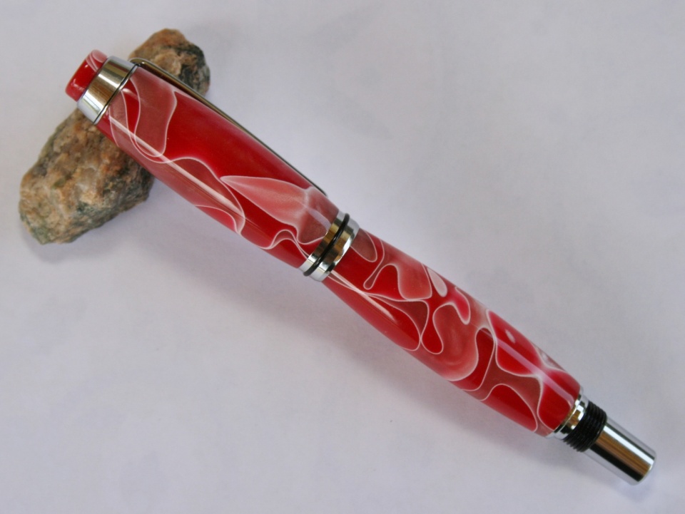

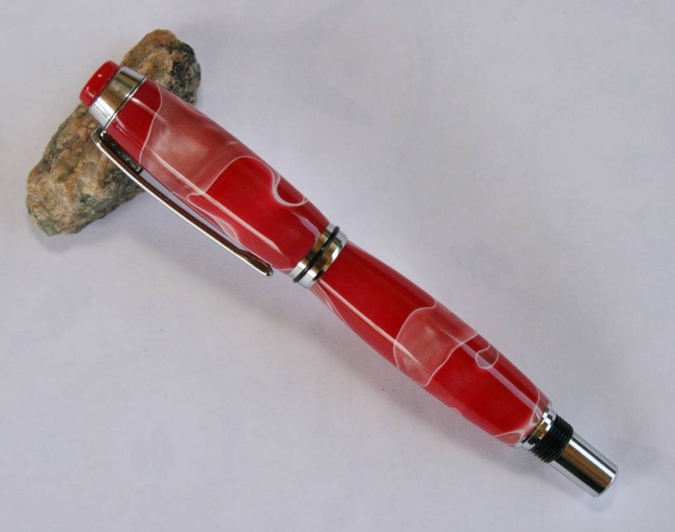

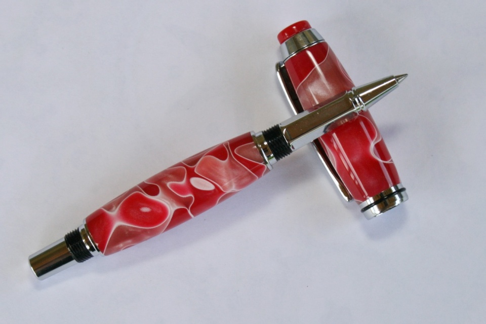

This blank really has me seeing Red and a little white. This Buy Acrylic Pen Blank - Fire at Woodcraft.com blank is one Evelyn picked out. I back painted the blank sliver and paired it up with a chrome Timberbits Baron II and added a matching finial. I really happy with the way it came out. All C&C are welcome.

Silver is a good "go-to" reverse color Dan...really pops blanks! JMHO...but the finial seems a bit tall and out of place.
I think the pen looks great up to the finial. This is personal opinion, but I think the transition from the taper of the kit back to a tall shoulder look (finial side profile) is a touch distracting from the pen.
Replacing a finial is a great upgrade, but if it were me I'd taper it a bit more and/or bring the overall thickness down a bit to keep the proportions of the cap.
Otherwise nice job.
Thank you Charlie Jim and Carl for your nice comments, I've started using sliver after a tip from Fred (PTownSubbie) he told me that it makes the blank color pot. Jim and Carl thank for the comments on the finial, I wanted to keep the small while lines to match those on the blank.
I had a feeling that might have something to do with it. I was going to say if you tapered it off or shortened it you'd lose those lines. Do you have any more of the material left?
I like the blank and love the finial but would have to agree with Carl. I would have taken my skew an used it like a scraper and tapered it down a bit. I would also skinny up the barrels just a bit and get those lines straighter but that is personal preference. Overall though nice job..
Fine....the finial is to big......the pen is to fat.......:frown: Fine then I'm not playing with you any more I'm taking my pen's and going home.....wait I am home never mind.:biggrin::biggrin::biggrin:. Thanks so much for your comment and critique. This is the first time I've turned this style of blank. I got to the point it is now I really liked the look, I didn't want to take the chance of remove any more material that could change the look.
