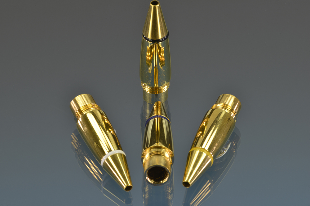

I rather simply use the sections that come with the Jr series pens roller ball pens than to make my own. I am also willing to measure the the threads. I did buy one die but it fit one pen, but not the other. I know there are tools that measure threads sizes ( I guess metric and imperial). I am happy to buy a few dies, I just want to buy the right ones. Can anyone recommend a thread measurement tool please?

I'm a machinist, and for anything metric or standard I simply use thread gauges. They are like $7 a piece and tell you everything you need to know for TPI if you already know diameter.

I just measured the threads on the Jr. Harold RB section. The pitch was .75. I still don't know if the OD is metric or standard.

measure the od in mm. The od for the tap should be a little larger. Since the depth of the threads will be the same as the pitch, you will probable want the tap to be about .15 to .25 mm larger. Too close to the od of the section and it will be too tight. Too much less and it will be too loose.

The silver and black section is 10.0 x 1.0. The all silver cone and section is 9.0 x 0.75
Both accept a Schmidt roller ball refill well. I didn't try a g2.

Are those the thread sizes for the ipenstore sections? If so it looks like you're in business, Those are both standard tap sizes.

Hi yes. I reported that they worked a few days ago. They are what I will use. One is 10mm x 1.0, the other is 9 x 0.75. I am going to buy more. My kitless wont be 100% without manufactured parts, but I will take it 😊

Both what ipens calls the ballpoint and rollerball section (links above) fit the diameter of the schmidt 5888 rollerball refill. I don't remember if I tested them with a G2 refill. Enjoy!
