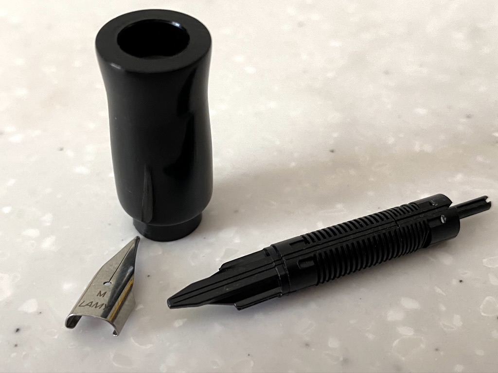

I have a brand new Lamy nib and managed to source a feed from China (by way of Etsy).
I now have both but found the feed a pressure fit (no threads) and I've never done that before.
The majority of the feed that will sit within the section is 6.3mm OD, but it has one "bump out" area that is 6.5 OD.
The closest bits I have are 1/4" (6.35mm) or an F (6.527mm).
I'm afraid that if I just drill a hole and slide it in that it will rattle or sway in the section. My worst fear is that it will fall out.
How do you guys handle pressure fit feeds?

I found some scrap blank and drilled both the 1/4" and F and tried to slip the feed in.
The F was a bit loose but not as bad as I described above (move around or fall out). I did find that when pulling the nib off the whole feed pulls out.
The 1/4" is pretty tight. The nib isn't going anywhere. I found the feed is entirely 6.3mm OD and the 6.5mm is sort of a graduated fin so it fits tightly. Maybe too tightly, though. When trying to remove it I glubbed it up. Luckily I bought a bunch of feeds.
TLDR; 1/4" functions, but between 1/4" and F there is likely a sweet spot that eludes me.

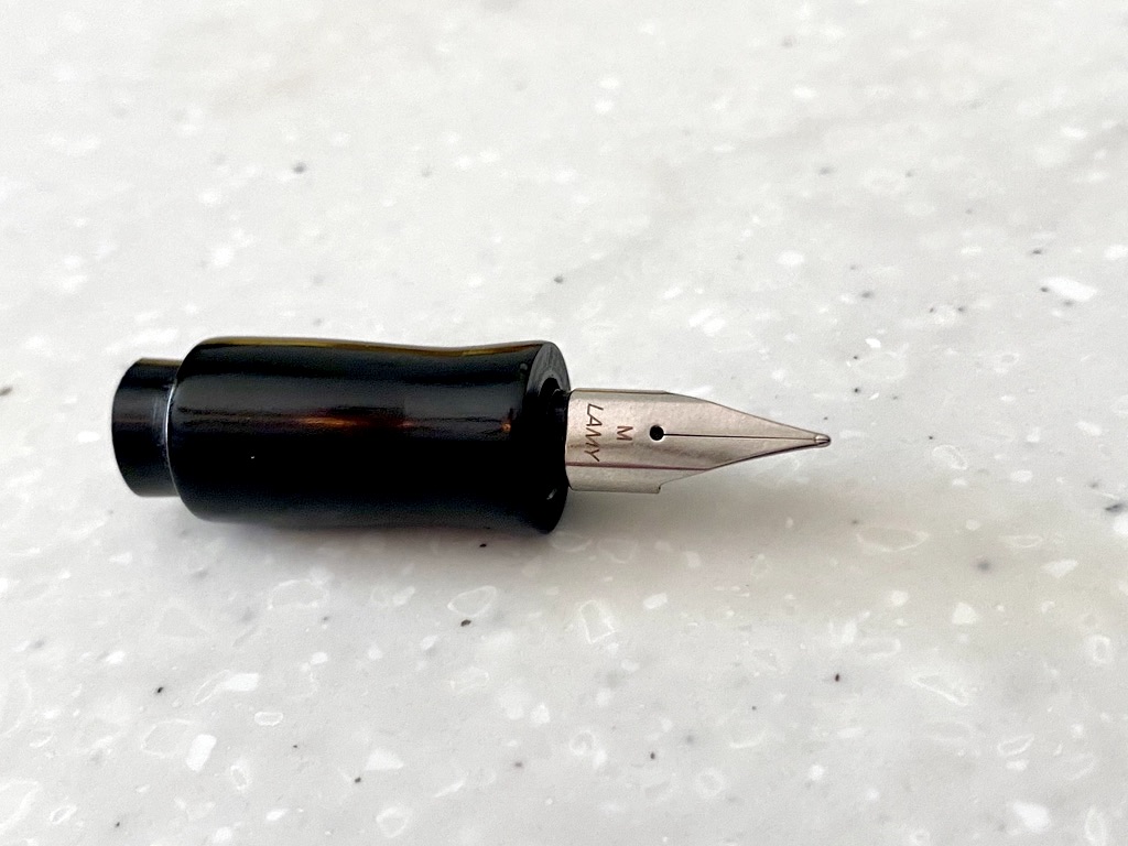

I put together something that seems to work. It works with the Lamy T10 refills. I have a Lamy Z26 converter that should arrive tomorrow. That will be the moment of the truth.
I haven't put threads on it yet, but I have plenty of material to work with.
Drawing notes: My drawings aren't to scale, and I work in MM.
