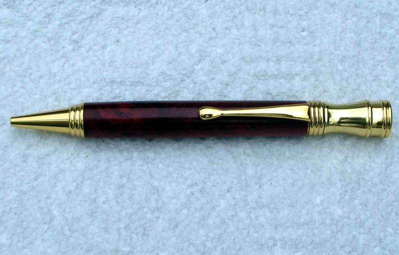

Yorkie, That is a Rizheng kit, $2.60 each. You can see it here http://www.penkits.com.cn/login.asp Part # is RZ-47. I have included a user name and password if you want to check it out. Gold is the only finish available.Way bigger than a Retro, its about the size of a Sierra. The bushings are 94 cents plus airfare from CHINA :O
