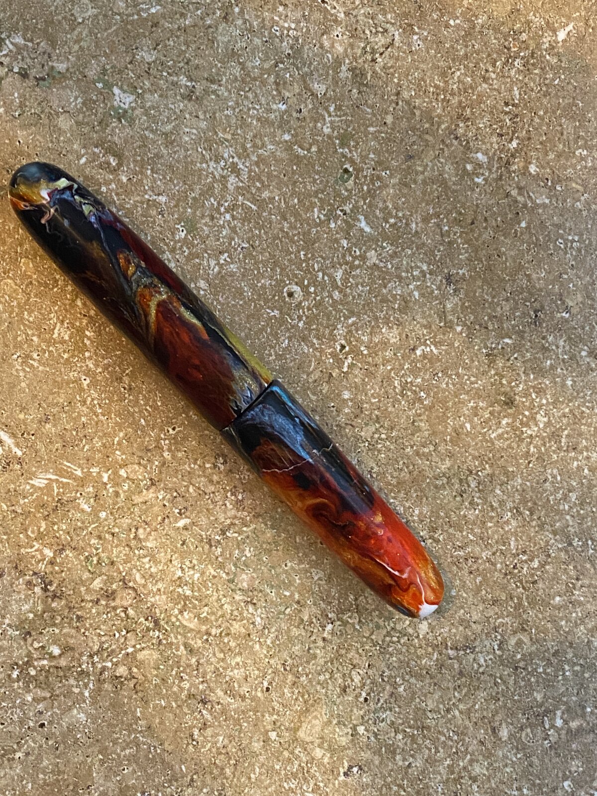

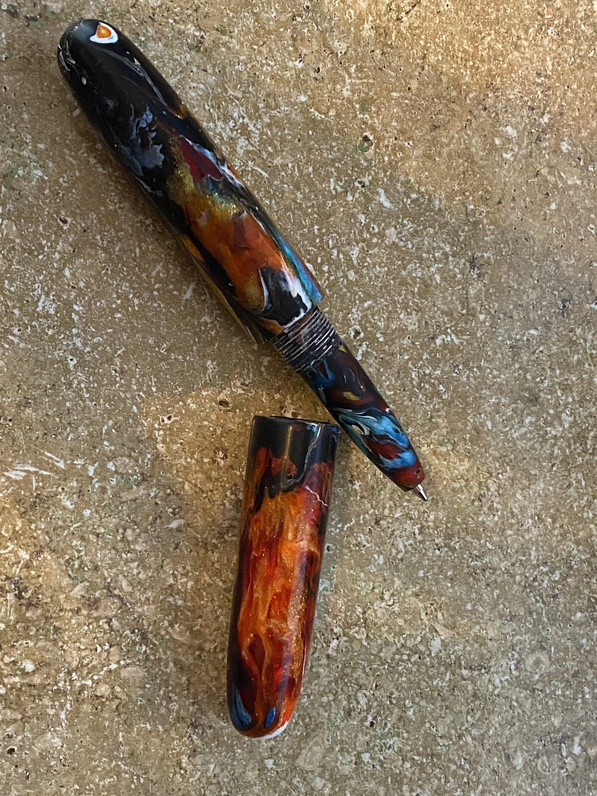

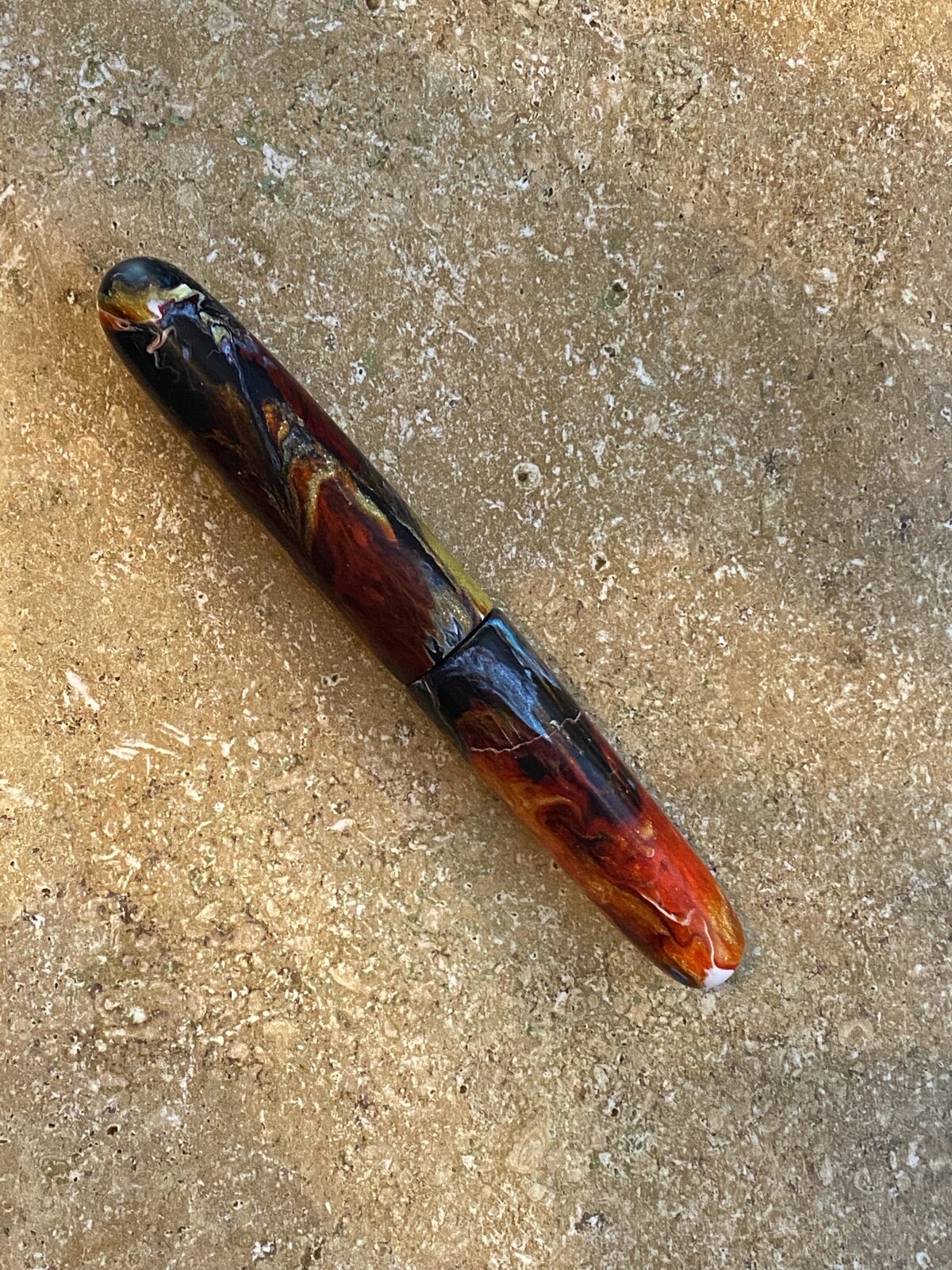

I used a blank from Turnt Pen Co. It cut like butter and is gorgeous. I had issues cutting threads with the tap. I was careful with my measurements. The tap would go in but actually chewed up the plastic rather than cut the threads. I then used the next sized up bit. The tap cut very shallow threads that would not hold. I was able to fix it using UV glue and re-tapping the threads. Any suggestions?????

I used a blank from Turnt Pen Co. It cut like butter and is gorgeous. I had issues cutting threads with the tap. I was careful with my measurements. The tap would go in but actually chewed up the plastic rather than cut the threads. I then used the next sized up bit. The tap cut very shallow threads that would not hold. I was able to fix it using UV glue and re-tapping the threads. Any suggestions?????View attachment 338844View attachment 338845View attachment 338846
That looks like a piece of "Inlace" I have had no success threading, I like the stuff so put in an acrylic sleeve that can be threaded easily.
