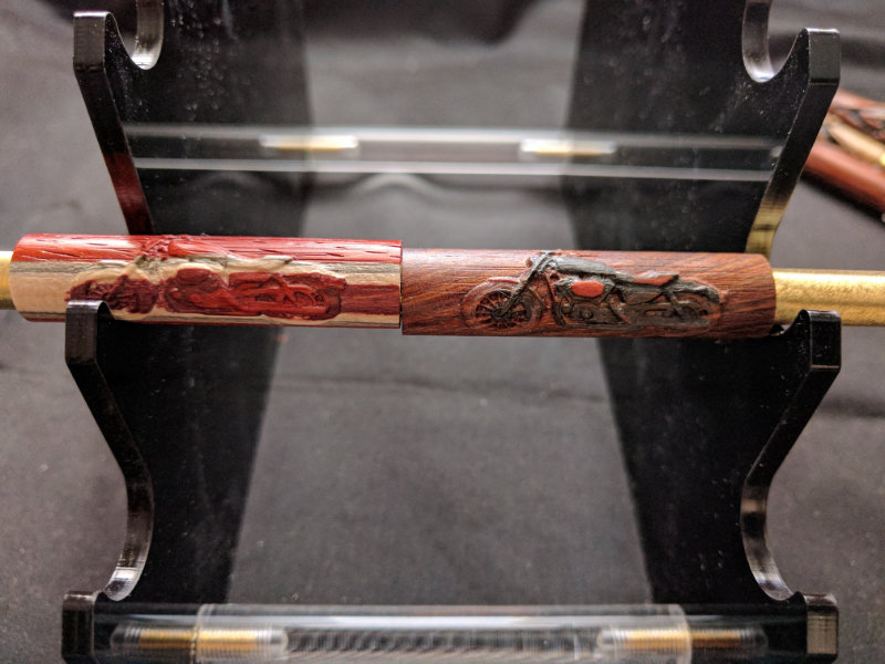

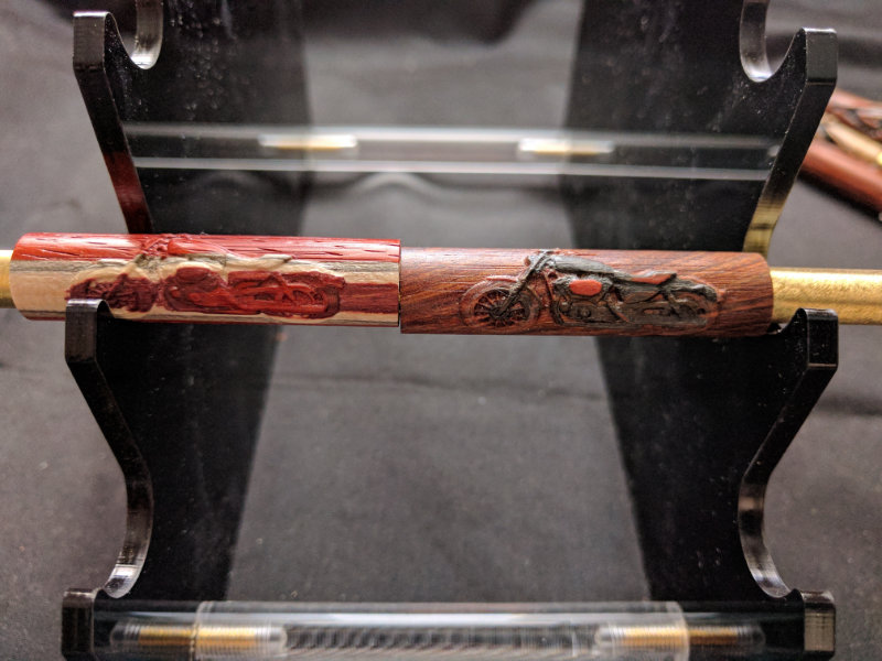

Blank on right heading in the right direction. Still needs improvement and I introduced another issue that needs fixed.

Smik, both look great, just curious, how'd you do it? hand carved?
Thanks. I purchase the artwork then use a cnc router with a 4th axis to cut the image. I was trying to find a way to enhance the images and recently thought of using this method. Its still a work in progress.

I see you must have painted the blank red before carving, then the parts that you want to be red must be the high spot?

The blanks are all wood. I have to look at height maps and determine what veneer thickness will leave what after I cut. I'm sorta doing segmenting. At the last Ohio meet Mark James showed the equipment he uses to make his blanks. I ordered that drum sander and waiting on delivery. I attempted some aluminum this afternoon to try to give some chrome appearance. No go, need to change the method. I'll try to make some blanks without the veneering, certain patterns seem to work out.

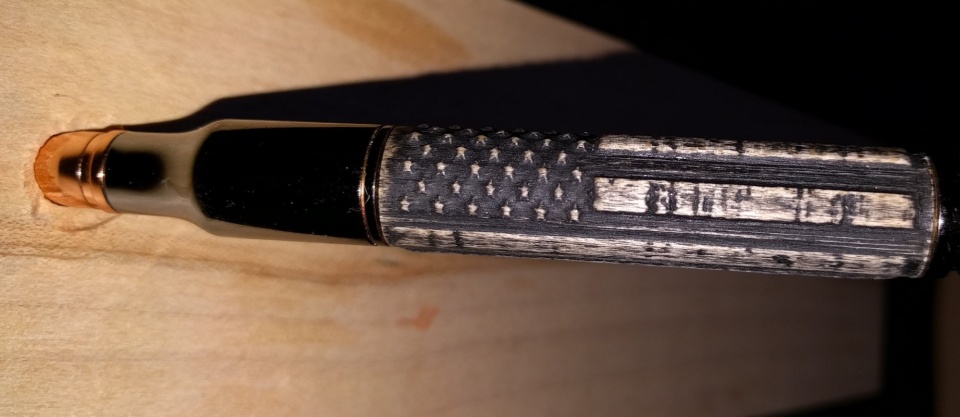

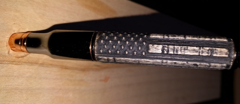

Here's a first cut try at a blue line flag with grunge look. Unfortunately didnt have anything blue around, dye or wood. Let me know what you think of the pattern. The blue line will be on the stripe under the stars same width.
