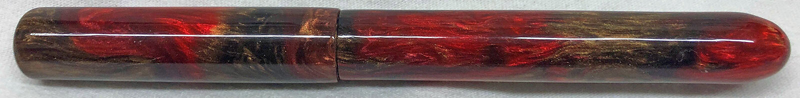

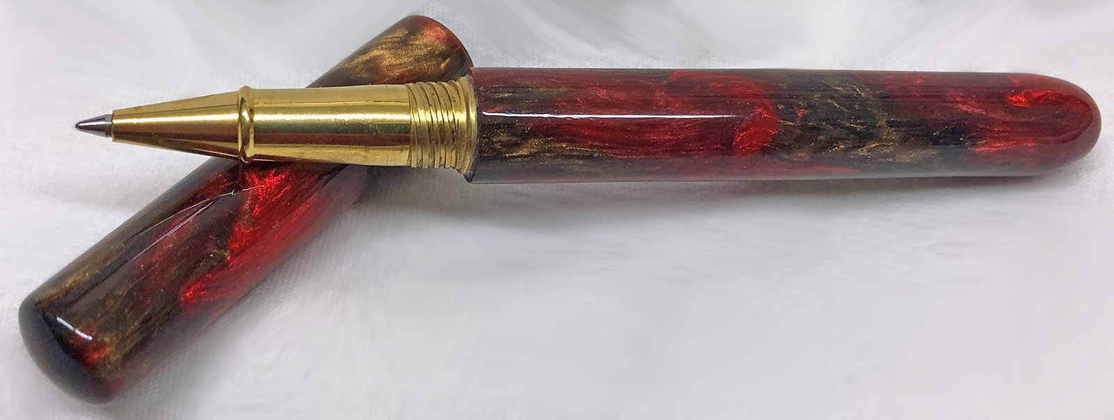

Greetings from Nebraska.

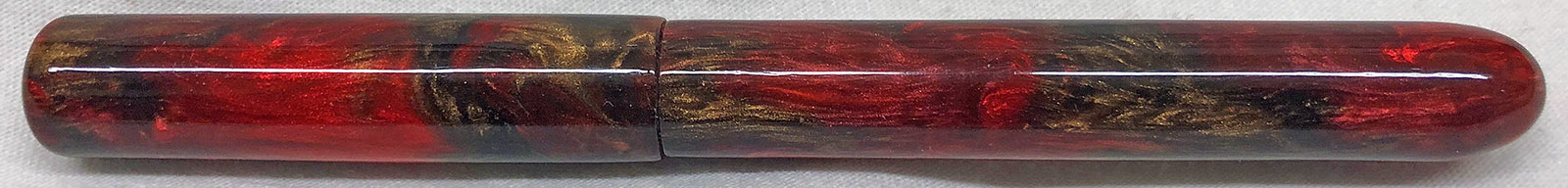

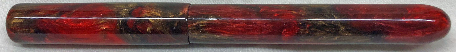

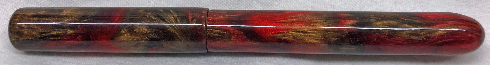

This is the second Apollo kit from Bullseye Turning that I have made. I think it turned out pretty good. It is a brass rollerball and I used the first blank that came out of the new mold I built about a week ago that I named Ruddy Brown - this is a link too that post "First Cast in New Mold". I had a few issues with gluing the components in but fortunately my fixes were successful. I also tried a little flatter shape on the top of the cap instead of just a round nose and I think I like it. I finished it with 2 coats of GlueBoost Blue (medium) followed by 2 coats of GluBoost Orange (thin) then I wet sanded with MicroMesh and finally I polished it up with a drop of the Step 6 Stadium Pen Blanks Magic Juice Polishing Compound.

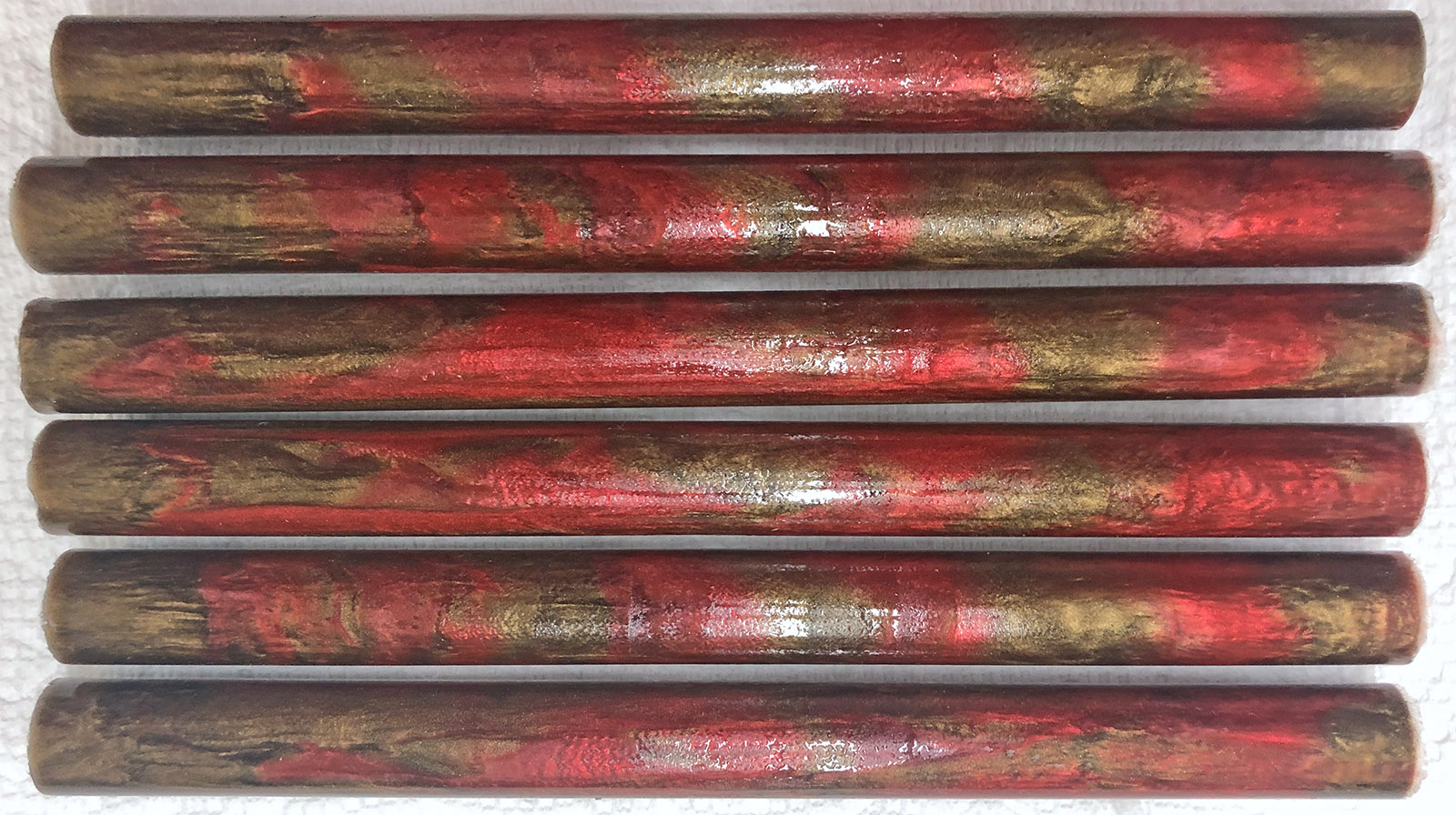

Anyhow, here are the pictures of the pen, followed by a picture of the blanks when they came out of the mold. The color separation, depth, and swirls really come out in the turned pen.
Dave
EDIT: PS The Mini Lathe Steady Rest I bought from Little Machine Shop and the adapter I made to fit my JET 1221VS worked just great for supporting the ends when I was turning them to shape -- no vibration and no chatter at all. Plus the marks on the blank from the bearings were minor and cleaned up with a quick sanding using 600 grit.

The Blanks as they came out of the mold.
