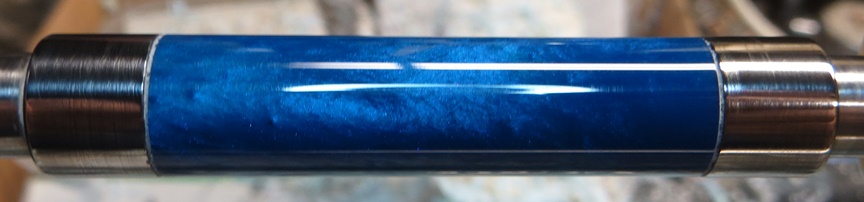

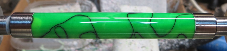

Now for the blank being turned bushing to bushing as it is called, comes down to your eye and experience but a little trick which I have mentioned here numerous times is the use of a straight edge. If you think you are close to BTB, take a straight edge such as a metal rule and place it on edge across the bushings. This will give you an idea if there is a hump or a dip too far or the ends turned down too much or not enough. When the rule can lay straight across from bushing to bushing it is perfectly straight. Now some will say, hey wait a minute. My bushings have been turned down some. Maybe one more than another. Does not matter because when you lay the rule on the bushings it lays across the entire busing and the ends nearest the outer edge will never be turned down. This is how I do all my pens except the Sierra line because the shape requires a bit of curve. Not much. Sometimes the cigar kits also but the eye will adjust for that.

I don't think perfectly straight is worth the extra measuring it would take. I make pretty straight barrels and go mainly by look and feel. You can turn the ends down to match the bushings and then flatten out the barrels without worrying if you will turn too far.
Use calipers, or even a crescent wrench, to see if you are too bulgy. Your fingers should give you a pretty good sense of how straight barrel is. Some people love the extra curves, some can't stand them - pick what you want to make.:smile:

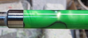

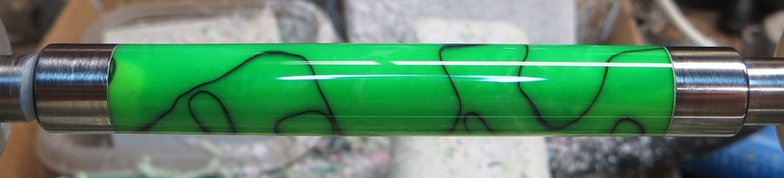

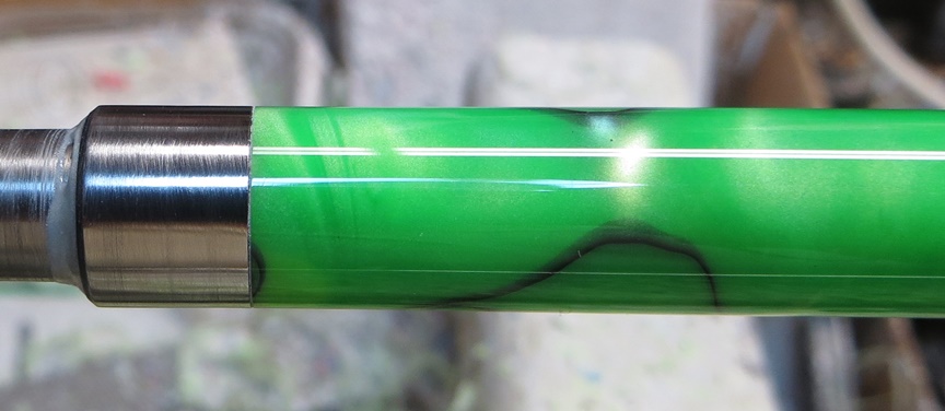

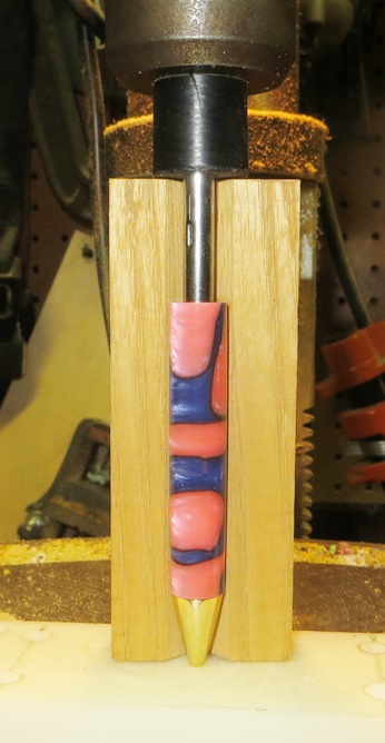

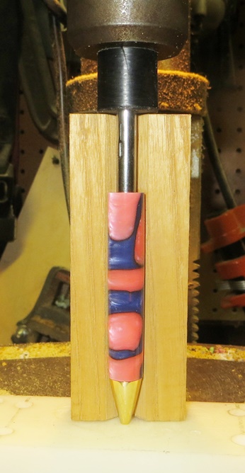

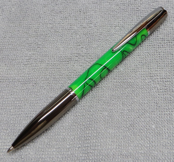

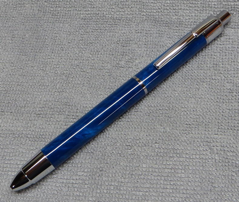

I have a v-block I made years ago for pressing transmissions into slimline and other 7mm pens. It helps keep things aligned, and also helps press the transmission in to the correct depth. I've always used my drill press to press parts together, I've never tried a clamp. As for straight barrels, I turn them to the bushings, then use my Mark IV eyeballs to remove any bulge. I've never tried a straight edge, I didn't think it was necessary.

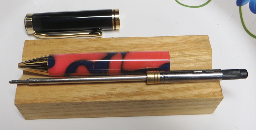

7mm transmissions seem to be the worst to press in. One thing I have started doing, after chamfering the ends of the tube is to wrap a punch in 320 grit, chuck it in my hand drill and sand the inside of the tube. This gets any last bit of adhesive, etc. out and loosens up the fit just a bit. I then run a a brass gun cleaning brush through to remove sanding dust.
Components press in without much "drama". I do use a drop of blue Loc-Tite just to make sure parts stay where they are supposed to.

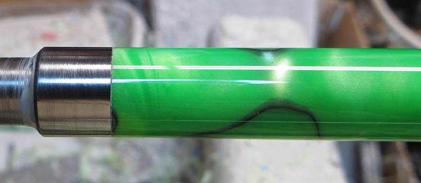

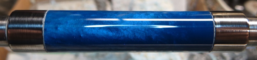

As suggested above, I take the blank down to the bushings on either end once I get close to final dimensions, then remove the center to the extend I want.
