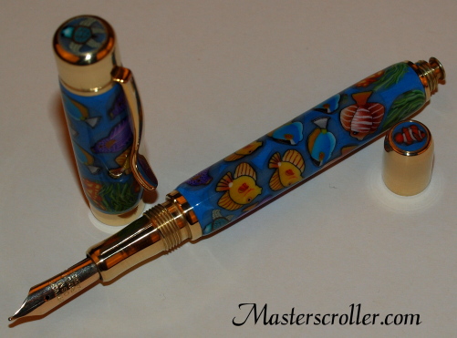

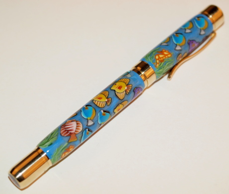

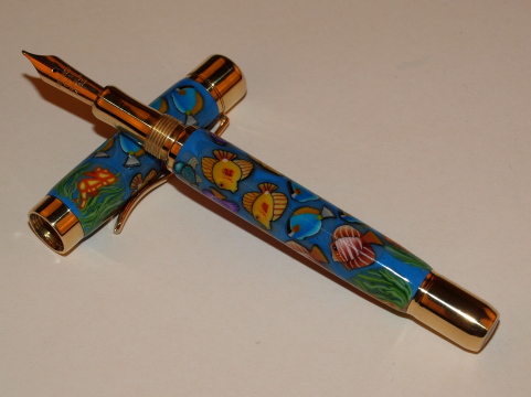

Well how about that, I did have time to crack out one more pen! I don't have any pen kits other than a few cigars and something like this sure wouldn't look good on a cigar. This is my first PC pen. It was a 10 hr build. Half that time was messing around with the PC and especially the fish canes. It is way more difficult that you'd think, first you have to get the clay on the tubes, then you have to slice these thin as you can and apply them to the pen and roll them in. I destroyed a cane trying to cut it with a polymer clay knife. I had much greater success switching to a square box cutter type knife like the ones you scrape windows with. I still think some of my fish where a bit too thick, and that I needed to bake the pen about 4-5 min longer perhaps
I bought this button filler pen on Ebay a while back because of the 14k gold nib on it..it was a dirt cheap find, the clip all mangled on it. The sac inside is gone and the mechanism that squeezes the sac is a bit rusty. I used the parts from that pen to make a completely new pen. This pen does not yet function because I ordered some sacs but don't have them yet. I am hoping maybe someone at the Chicago Show can fire this pen up on site.
The body of the pen is Brass and the finish is CA. The clip is something laying around here looking for a home. The finial cap to hide the button filler is M8x1, the pen cap is 10x.75. It is a tiny bit long, about 1/2" shorter would have been slick, but it is at least not a girthy pen. The cap is 1/2" diameter. Thanks for looking.

This is a better pic, and it shows the button filler cap removed. Took me a while to get a better pic, I can't seem to remember how to lower the shutter speed and increase the focus zone.:confused: I hate cameras!!!

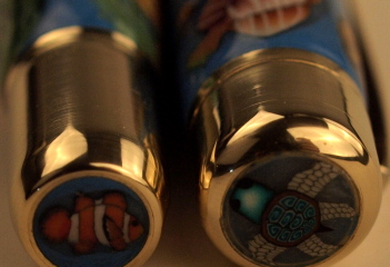

Yes, thanks Toni, those are finials. They are not glued in place either. I just drilled a hole the size I wanted it to be then filled it with clay, the hole being no different than if you were to remove the disc off a Jr Gent cap. After baked, the clay stuck just fine and then I used thin CA to seal them. I had to roll the sea turtle to make it a bit smaller and that cane became mostly trash. The square blades you use for scraping windows work really well...like a razor blade. If I was going to do this regularly, I would build a little jig to turn that blade into a guillotine and I would get or make some tubes to put the canes into. I think if the cane was inside a tube, you push the cane out from the tube just a hair then plunge down with the home made guillotine, then you would get perfect even slices and the cane can't deform because it would be surrounded by a tube. That's my theory anyhow.
