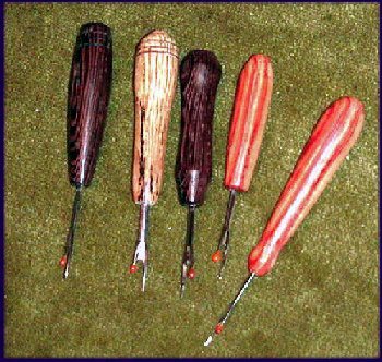

Here's an old picture I found of a few seam rippers. Sorry the photo isn't any better, but I can't take a new one because the seam rippers were sold long ago.
<br />
Happy turning,
txbob
