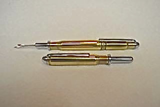

I use PSI. No problems w/theirs. I make em' on shell casings.
