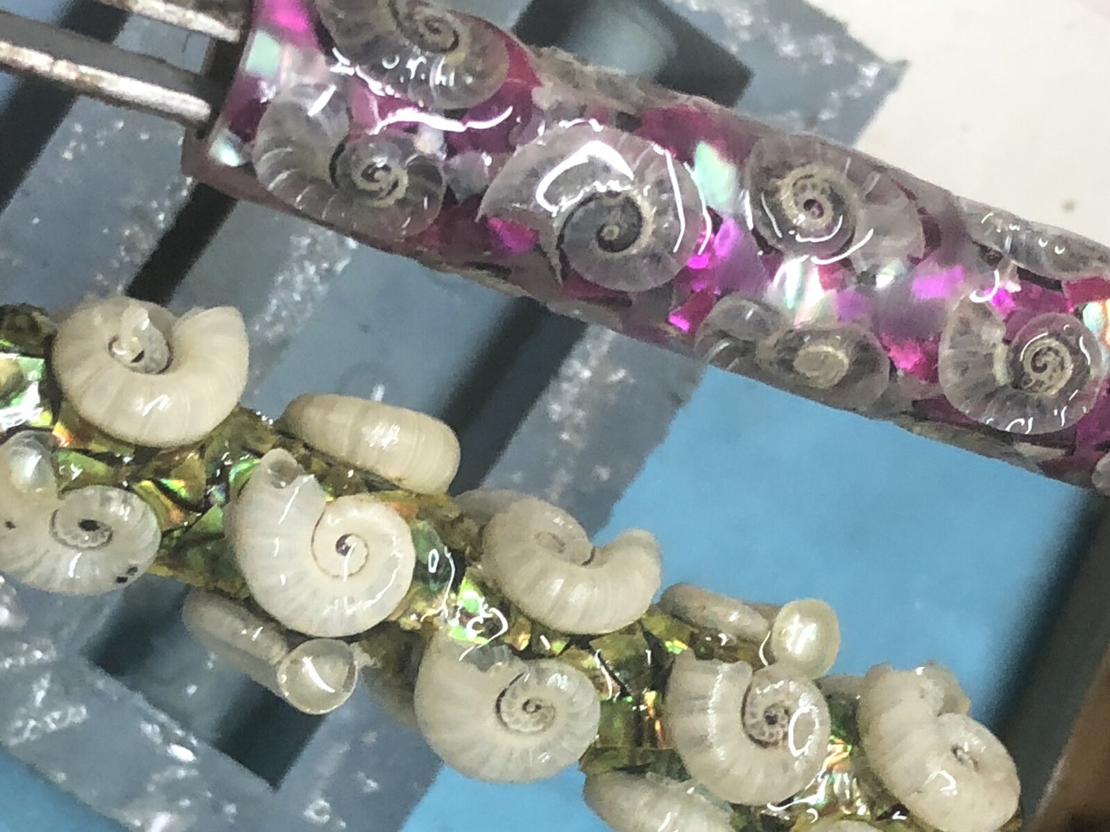

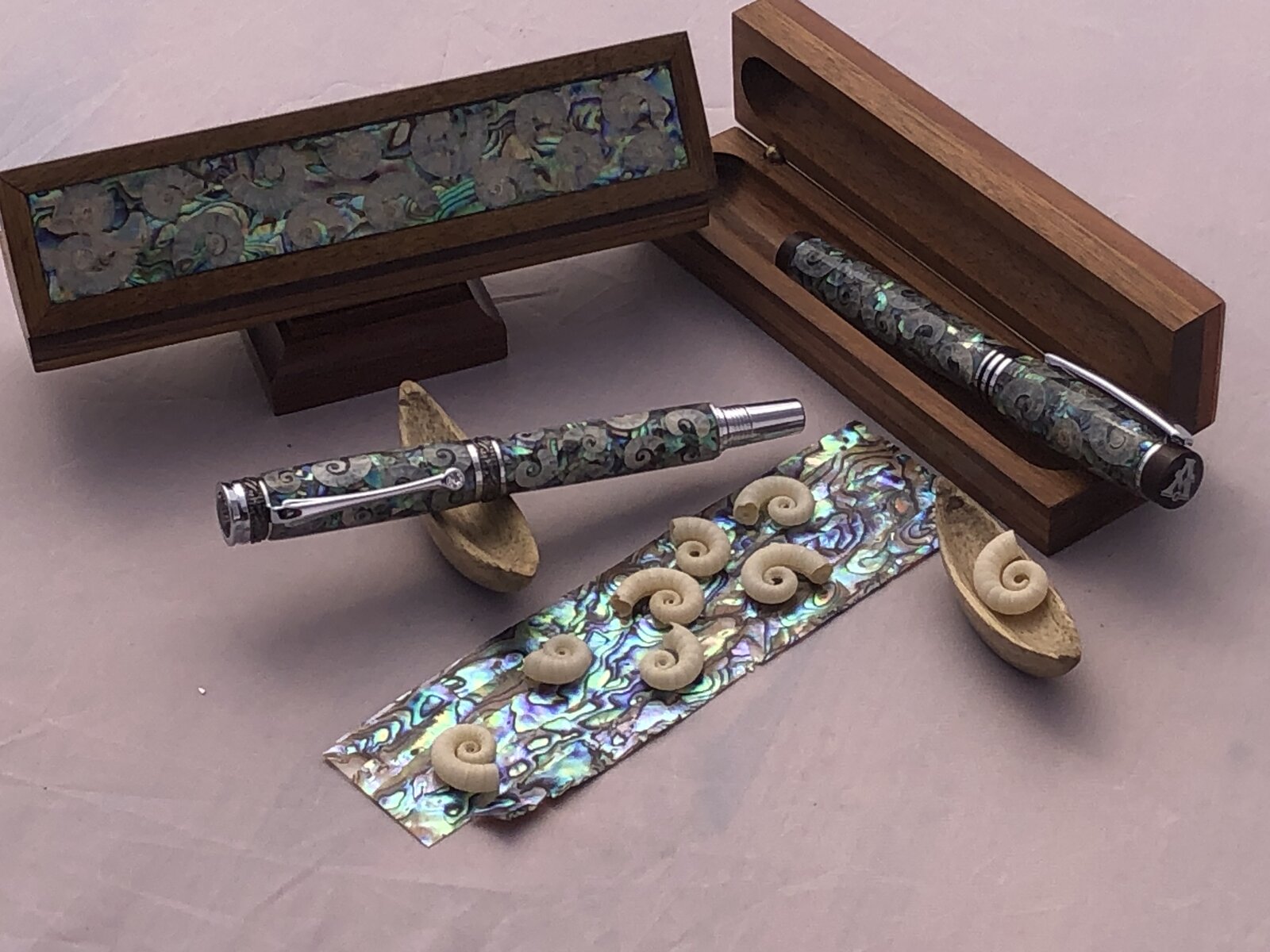

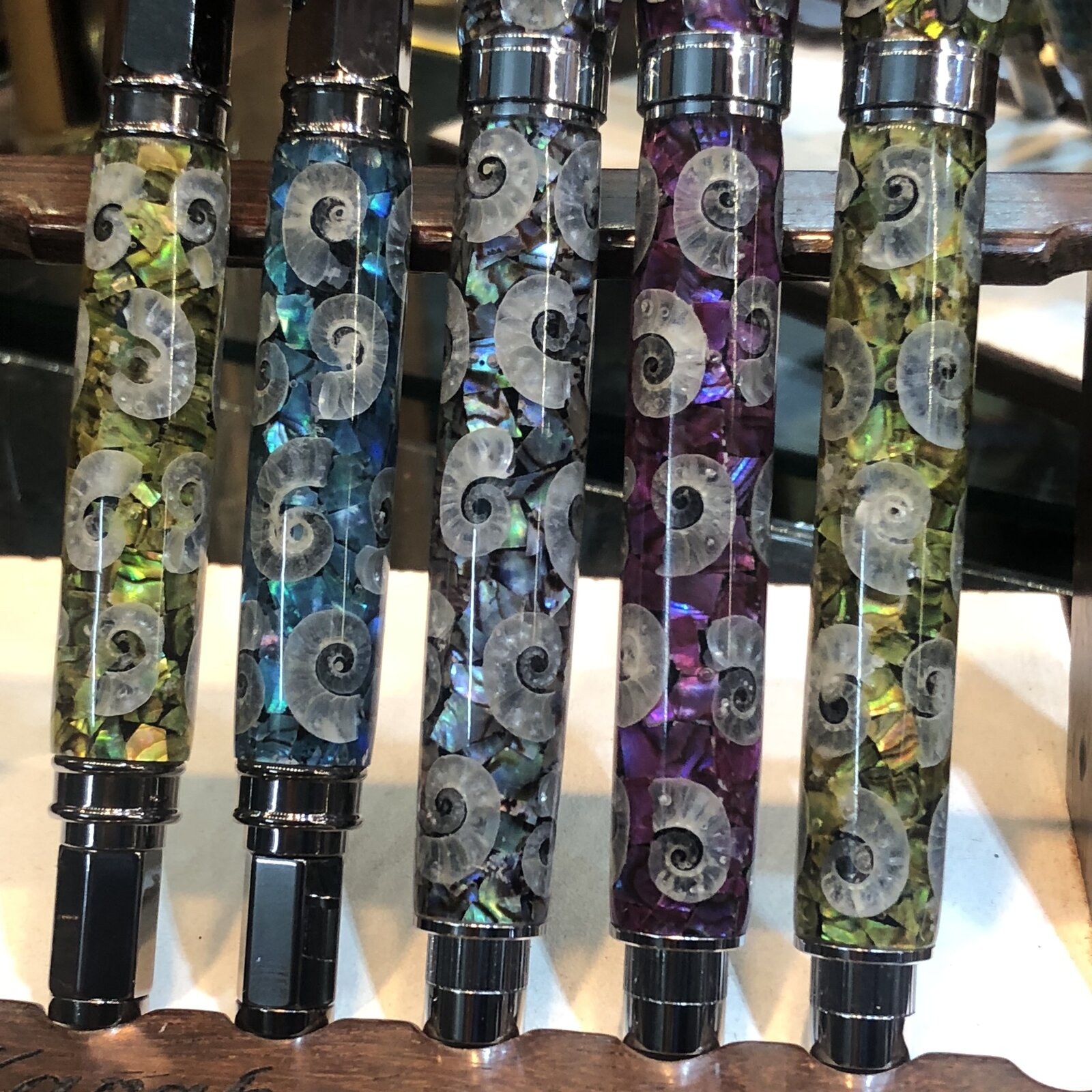

Amazing Sea shell recovered on the beaches, with Abalone, and his special box
This work is done for a VIP client who only wants unique pens in the world
I've never seen this combination before; truly unique. I suspect turning was a challenge. Superb. 👏 👏 👏 👏
Dear Mark

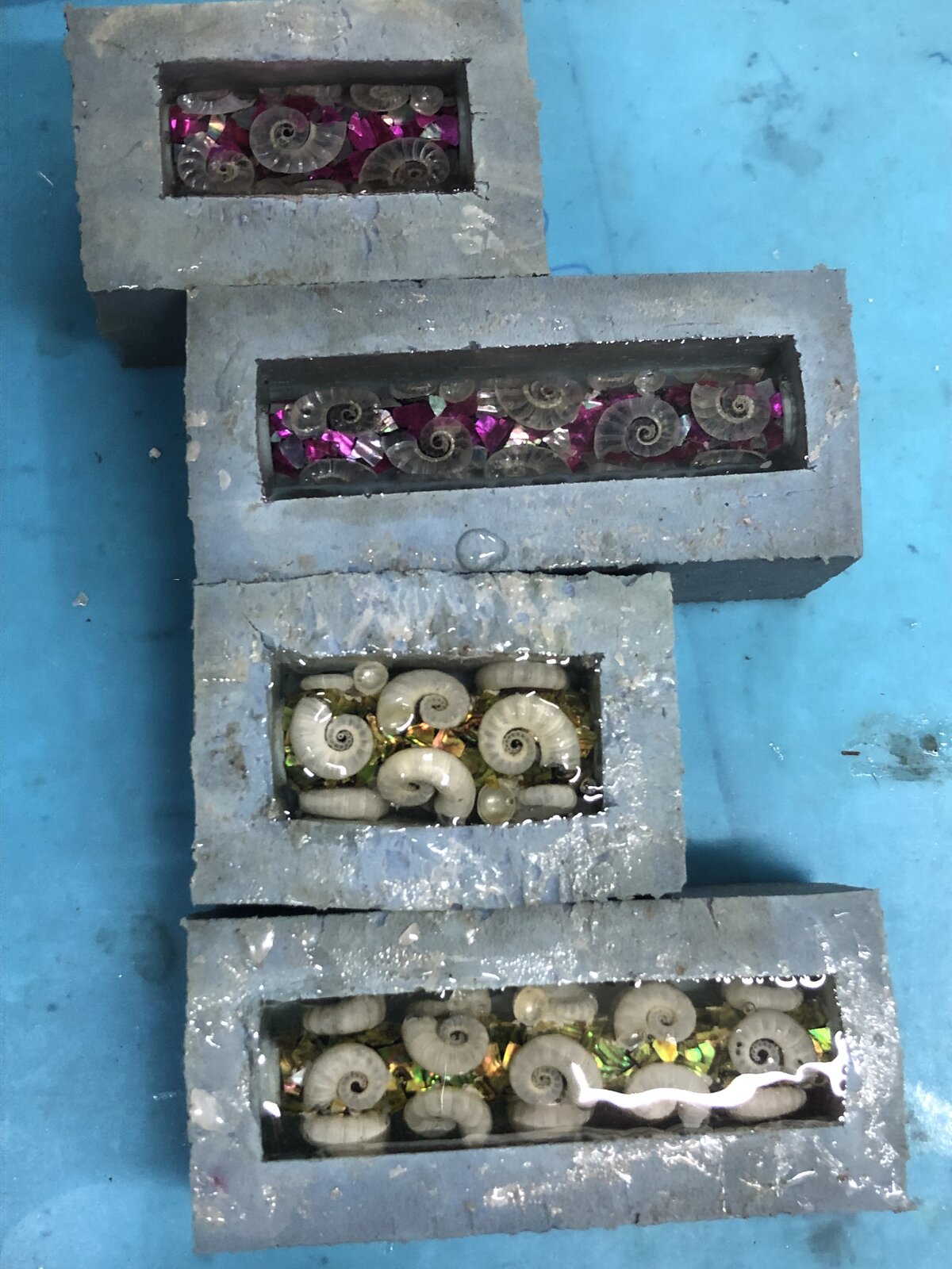

It is not possible to do the turning in one go. We must work by step and re-resin at 50%. The shells are hollow and compartmentalized. It is certain that some expertise is required

Dear Mark
A few years back I bought a blank cast with shells - very attractive. It was the most difficult material I have ever attempted, and in the end it was a failure. Never tried again. The double cast makes sense to me based on my experience. I was repeatedly filling voids with CA until it finally shattered. Yours are beautiful.
