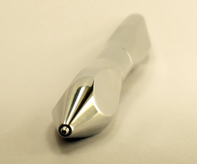

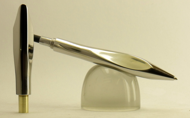

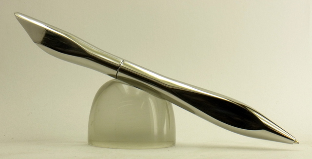

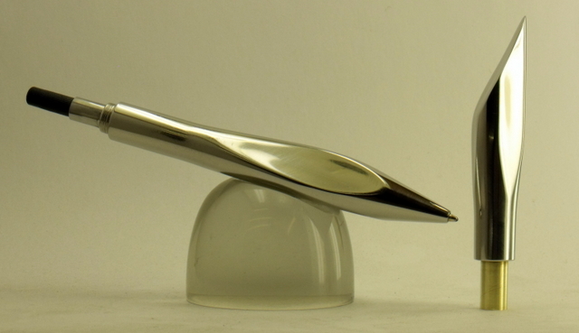

Fresh off the angle grinder !!:biggrin:
I think the only straight lines on this pen are the sides of the holes down the middle. The outside is Tri-lobe shaped with convex and concave curves.
If the humble slim has an Achilles heel, then in my opinion it's the moving joint in the mech. To give the mech a fighting chance on a fairly heavy pen like this, I overlapped the tubes and blank halves. Also put a small tennon between the blanks.
I spent hours with the 6 inch angle grinder and even longer with the sanding and polishing....but when I showed my dear wife....guess what she said..?
'Mmm...that's different.....looks like a medical thingy' :eek::mad:

Looks like it feels great in the hand!
Yep, it is nice to hold. The first time I saw a Tri-lobe pen was Bruce Boone's Flame Pen. ( I still love that pen !!:wink: )
One of the (many ) complaints the LOML has about steel pens is that they are slippery and sometimes difficult to hold. This shape makes it a lot easier. :biggrin: Keeps 'her' quiet too...:tongue:

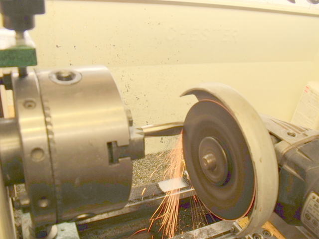

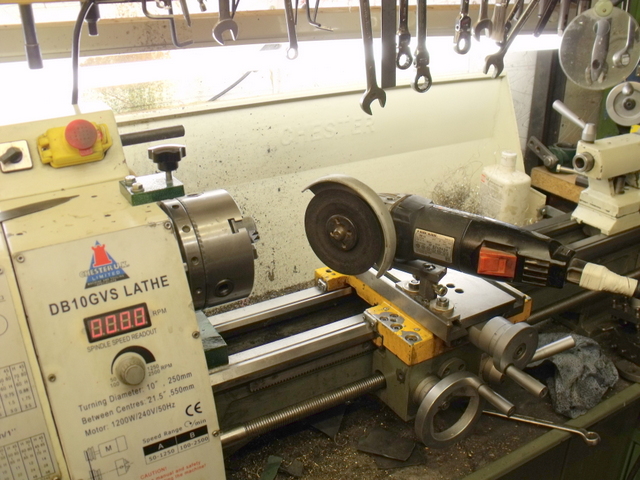

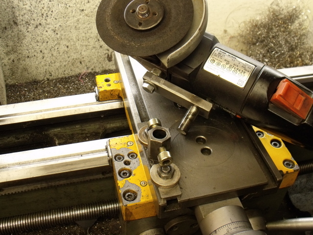

Here's a couple of pics showing how I used the angle grinder.
The lathe is off, of course and just used to hold and index the work.
The pivot point can either be locked with the cap screws when using the carraige, or left loose to create arcs.
