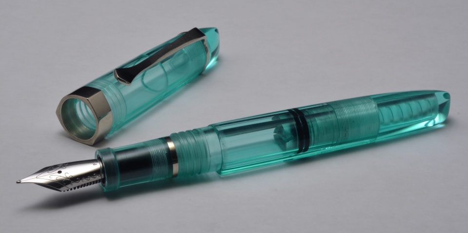

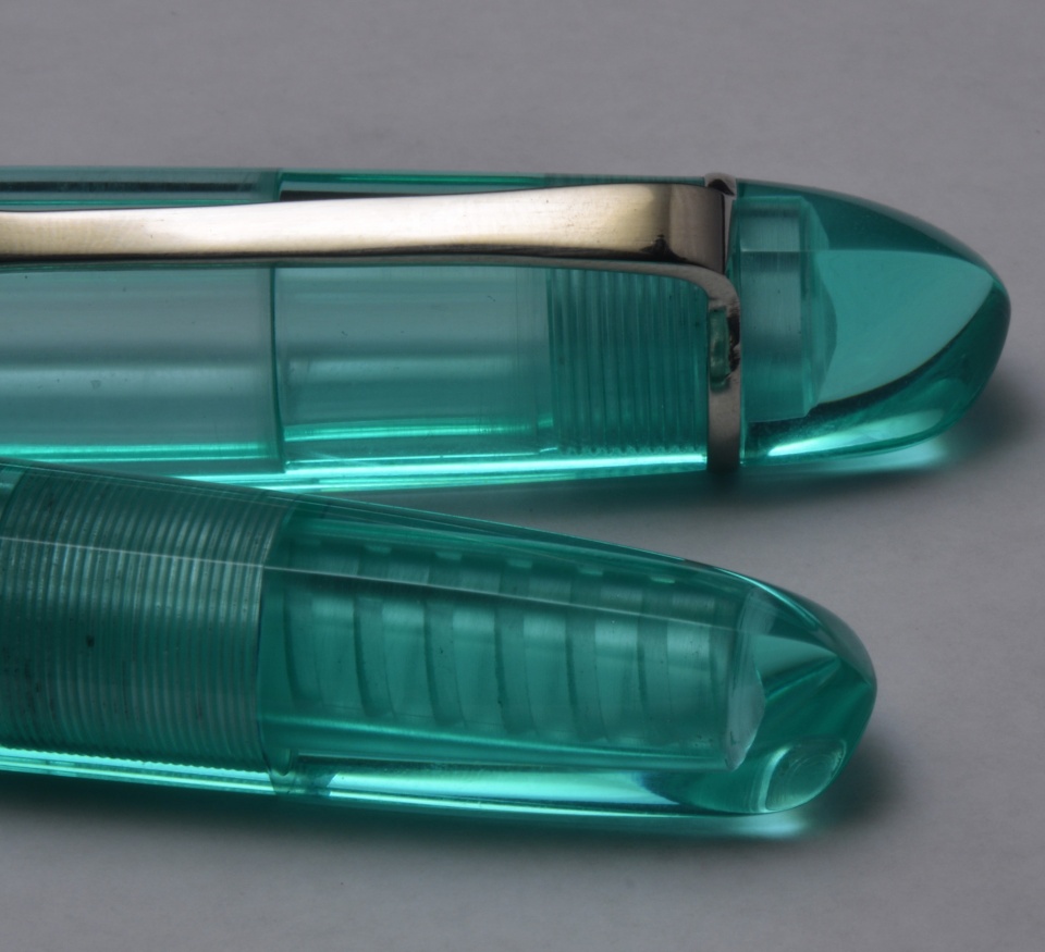

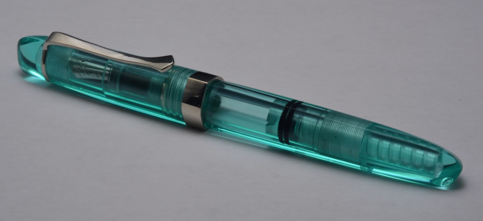

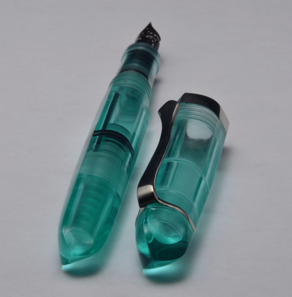

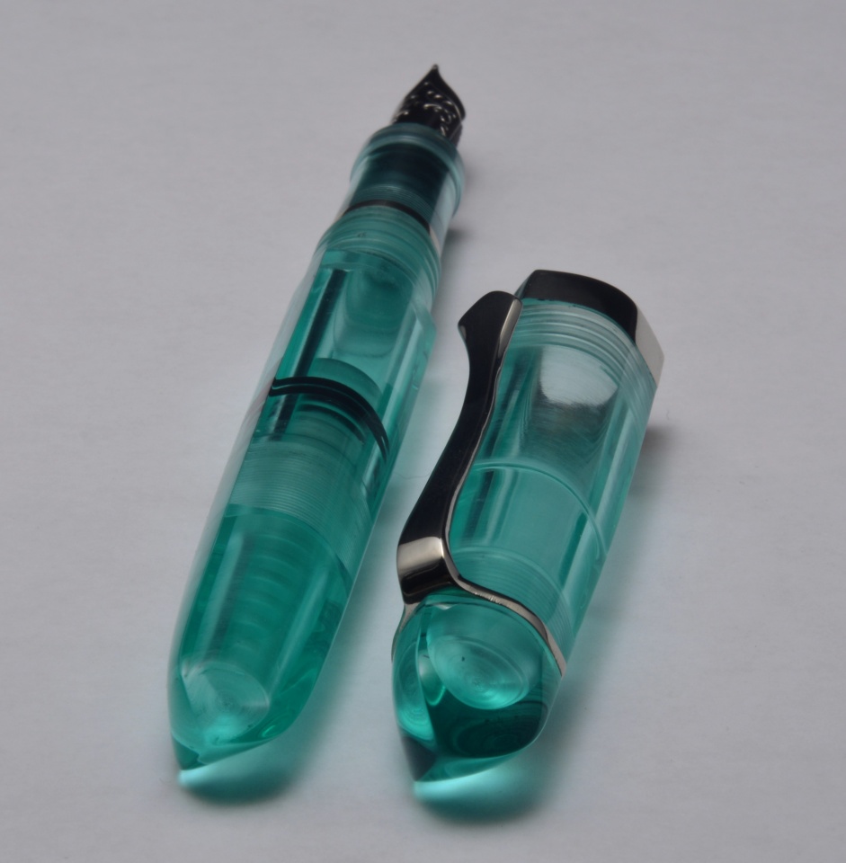

A couple weeks ago I posted my first pen that featured a sculpted rounded triangular cross section.
http://www.penturners.org/forum/f13/exploration-non-round-152805/
This is the next evolution of that pen: A piston fill version that also features a metal cap band. The pen is made entirely from transparent green acrylic, and the cap band and clip are nickel silver. Everything on this pen was handmade except for the nib unit and o-rings on the piston. I'm seriously happy with this pen, and can't wait to send it off to the new owner.

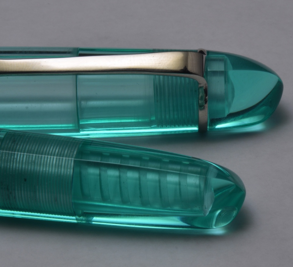

Wow, that's beautiful. How did you cut the piston thread and what is the pitch? My next pen is going to be a syringe filler, how much interference do you have between the o-ring and the bore?

Thanks! Piston thread was cut on the metal lathe. As far as pitch goes...pick the absolute coarsest that you can cut ;)
I don't really know what the interference between o rings and ink reservoir is. I just kind of keep taking material off the grooves in the piston head until I get a good fit.

One thing I don't understand is the impermeability of the black feed / blue section assembly. You just rely on grease?

Hi Pierre,
Are you referring to making the space between the section wall and the feed housing sealed off so ink can't get in there? If so, silicon grease is sufficient when applied to the nib unit threads. Also, the front of the feed housing has an o ring behind the flange, which prevents ink from getting sucked into that space when filling.
