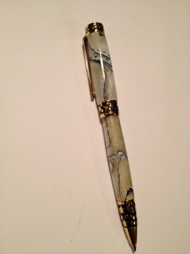

Bobostro61 Member Joined Jan 5, 2013 Messages 577 Location Chicago, IL Feb 3, 2013 #1 Looks like I need to buy some white tubes. The brass tubes really show through on this one. Bummer... Live and learn I guess...
robersonjr Member Joined Jul 29, 2011 Messages 456 Location Yuma, Az Feb 3, 2013 #2 Paint the inside of the tubes, cheaper and really works
Timbo Member Joined Jan 4, 2008 Messages 1,188 Location Kill Devil Hills, NC USA. Feb 3, 2013 #3 I use spray paint. Actually, I find that the primer sticks better than the paint, so I buy that now.
