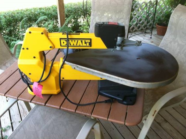

I've found a DEWALT DW788 20-in Variable Speed Scroll Saw for $200.00 and it looks new. Deal or no deal?
Looks to be in great shape. These type deals are not that uncommon. A couple things. How old is it??? Does it run??? If it is a Type 1 it is a great find. If it a later model Type 2 then all bets are off. This is stamped on the motor label. If it is a later made model like a couple years then all the problems have been worked out. I would take a chance on it if it can be vouched for as working and some sort of return policy if not. Make sure the speed control works. One of the problems with them is that they accumalate dust and stop working. They are one of the best mid range saws on the market and will do nicely. They are quiet and if setup properly vibration free. Very easy to change blades. Look at all the room on top.

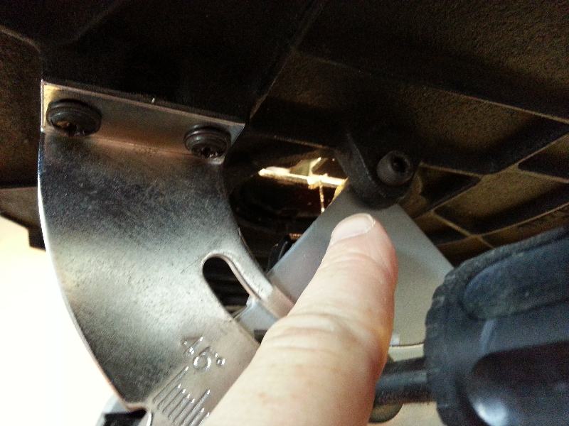

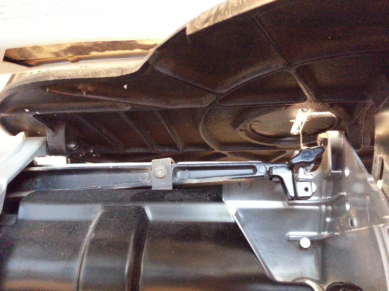

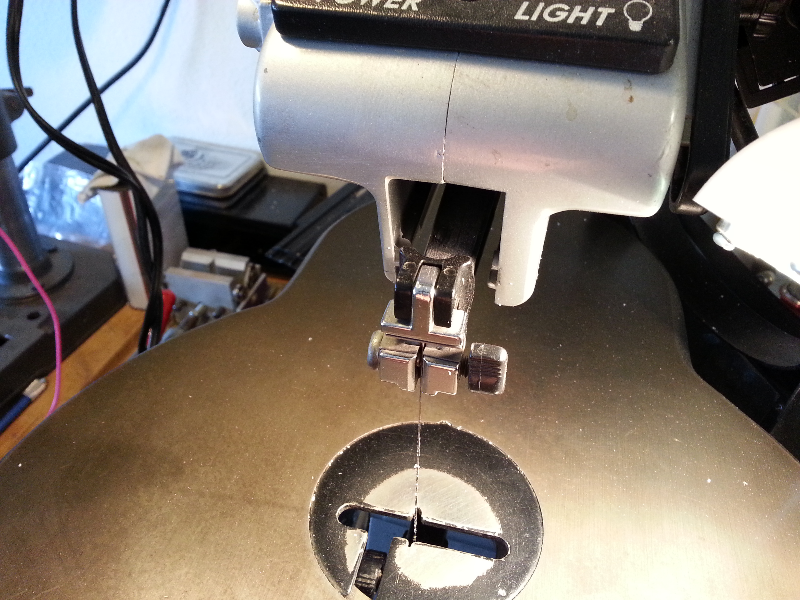

Here are some pictures of my scroll saw. In the first picture you will see that it came stock with the quick change blade holder. The second picture shows how there is a table mount/hinge for added support. Something the Dewalt did not(not sure if that is only the case with certain type#'s). And the last picture shows both of the table mounting bolts. To me, this has been a crucial part of the design that has allowed me to have a sturdy/steady table when cutting my coins. When i used the dewalt, it was not very dependable. If i pay that price on a saw, it better have a good table support. Just my opinion. Maybe my next saw with be the hawk or hegner(whichever is better). Either way, you definitely get what you pay for when you do your homework!

Happy that you like your Dremel. I won't argue either way on any saw because all saws have pros and cons. Would say though that the Dewalt is used tremendously in the Marquetry field of scrolling and that says a mouthful. Sturdy and steady is a valuable asset in all forms of scrolling not just coin cutting for sure. Happy scrolling to all scrollers out there.
