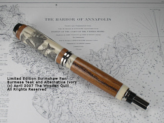

I make a Pen - Limited Edition Called "Thare She Blows" and I use Alternative Ivory (resin) and it works great with the laser.
