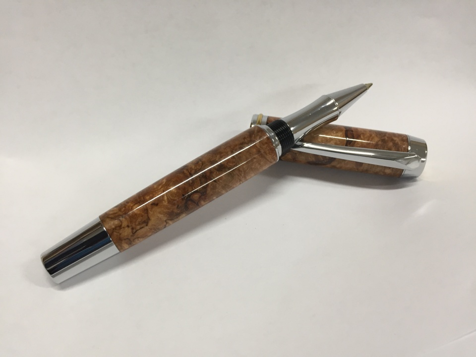

I had the same or similar problem with CA on dark wood. In my case, I took a close examination of my lighter wood pens and realized that all the same scratches were still there, but much harder to see. Attached is my first attempt at a "nice" pen. The finish is absolutely full of scratches. It might hard to tell in the photo, it is hard to tell with the naked eye, but if you know how to look for them, they're plentiful. If the same finish was on a black walnut pen, it would look awful.
To fix the problem, I basically just spend more time with the pads. Stop frequently, especially with the rougher grits, and look for scratches. Do not step up to a finer grit until you remove the scratches. If you have a deep scratch, step down a grit and sand it until you remove it. By the time you get through the first 3 or 4 grits, you shouldn't be able to see any obvious scratches. Then, you should be able move onto the finer grits and give it a good polish.
During my troubleshooting, I purchased a different brand of pads to test and I had similar results. It turned out to be my technique. My biggest hurdle was, learning that scratches need to be removed with the rougher grits, rather than trying to "work through the scratches" with a finer grit. Unfortunately, it means each pen takes more time, but they ultimately look a lot better. Hopefully, this information helps. I was pulling my hair out for weeks, trying to figure out why only my dark wood pens looked like crap, when it turned out they all did. :biggrin:
