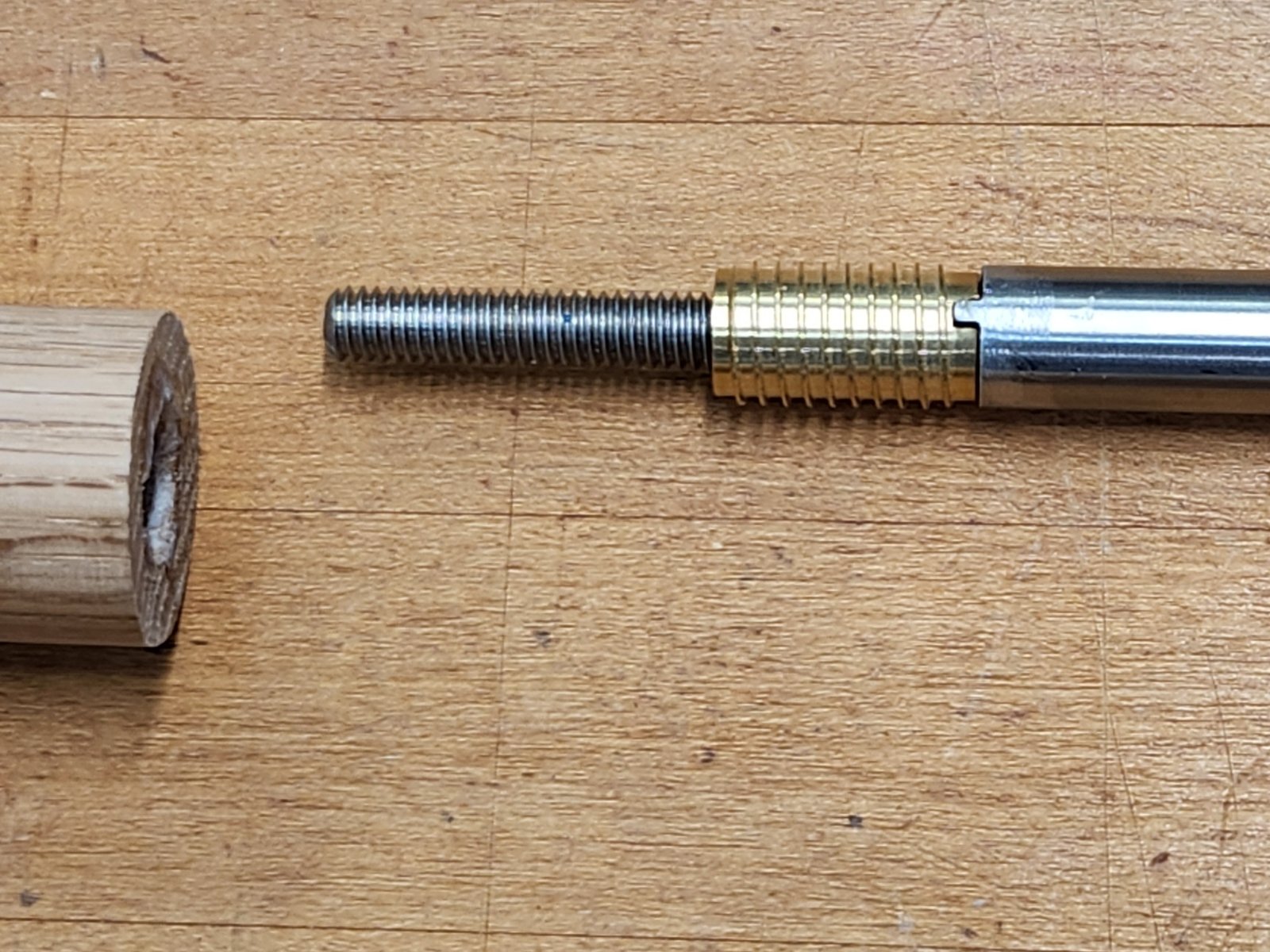

I recently carved the end of 1/2OD x 5/16ID stainless tubing to use as an insert driver. A similar threaded rod inside it all served to keep perfect alignment into the turned handle. I threaded the rod just past the insert depth to keep everything true.
It's not pen work, but maybe it will be helpful to someone.
