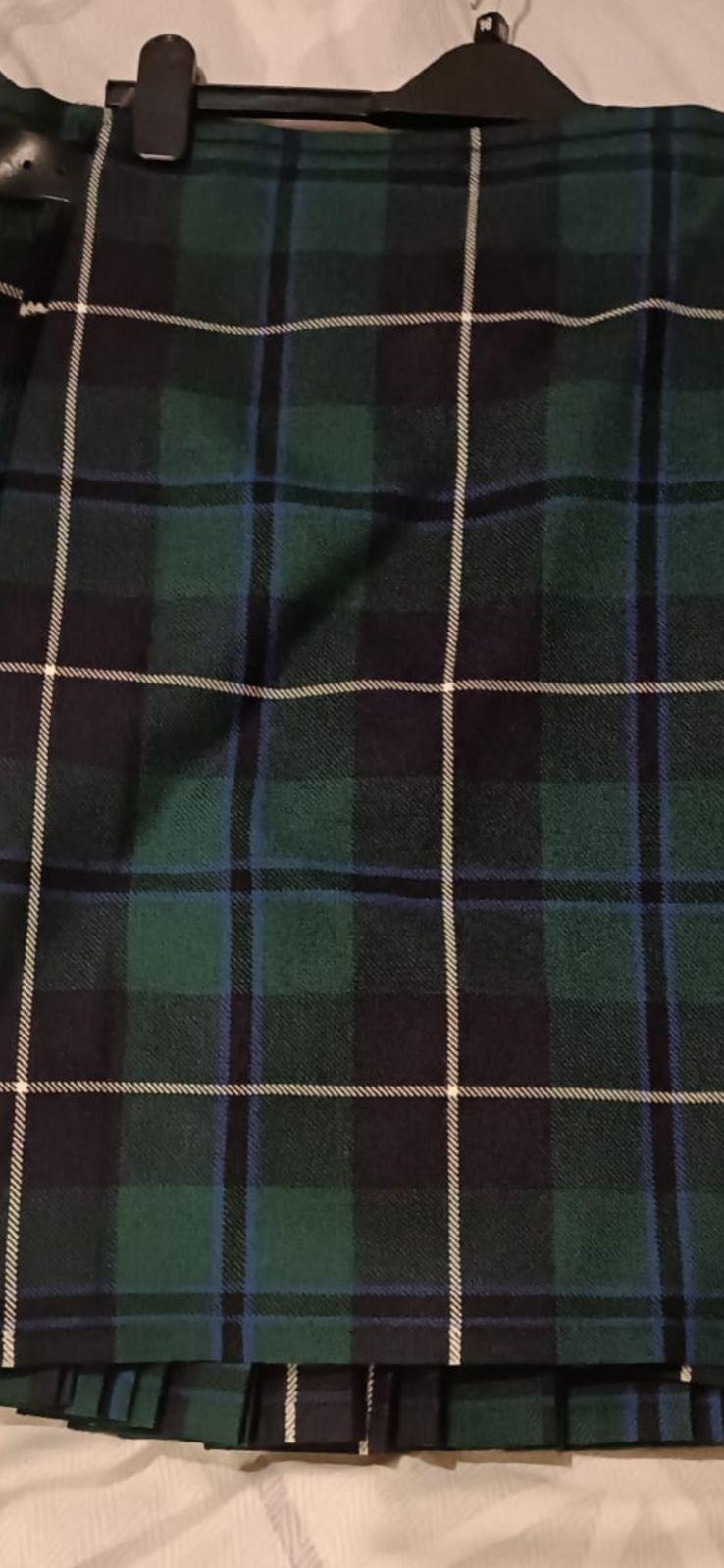

Those are all Douglas tartans. You can usually find dress modern, dress ancient, hunting both modern and ancient. The difference is the modern tartans are dyed with modern, more vintage colors while the ancient/hunting ones are more muted, replicating the primitive dyes available to the weavers at the time. For example, this would be a modern tartan:

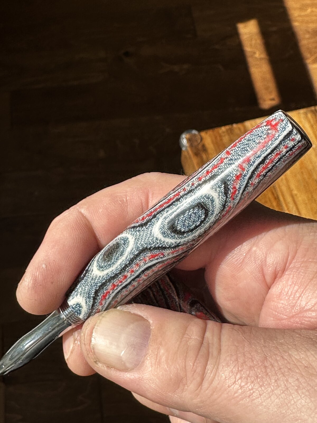

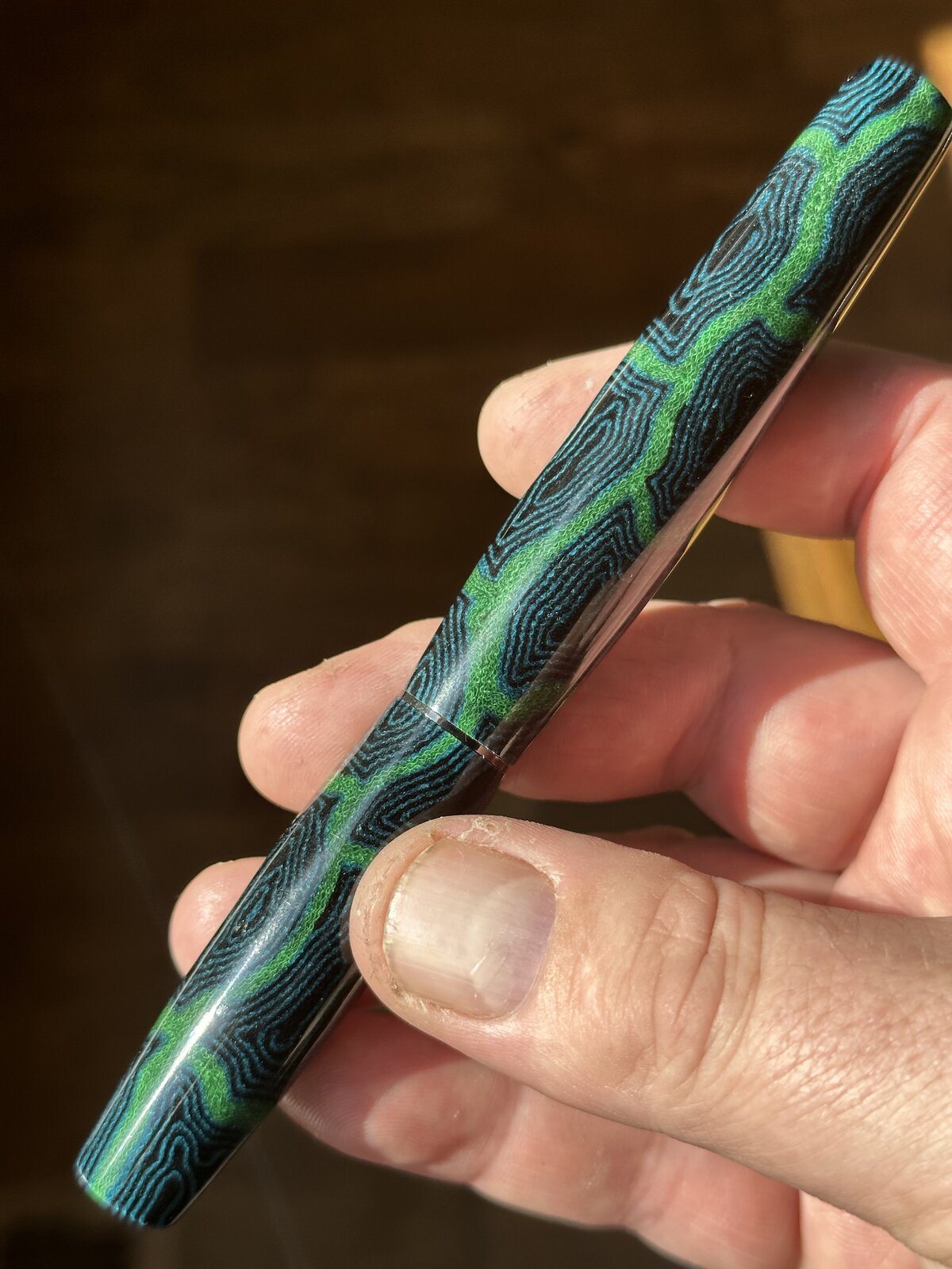

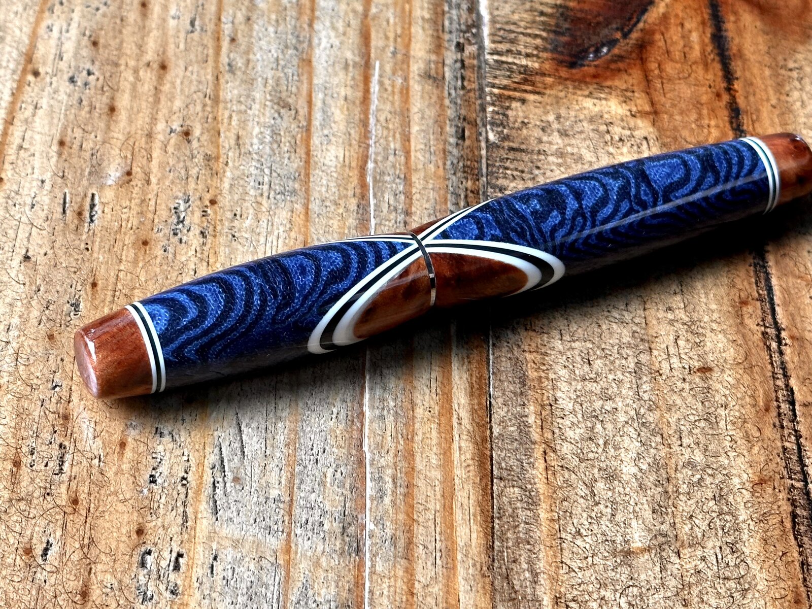

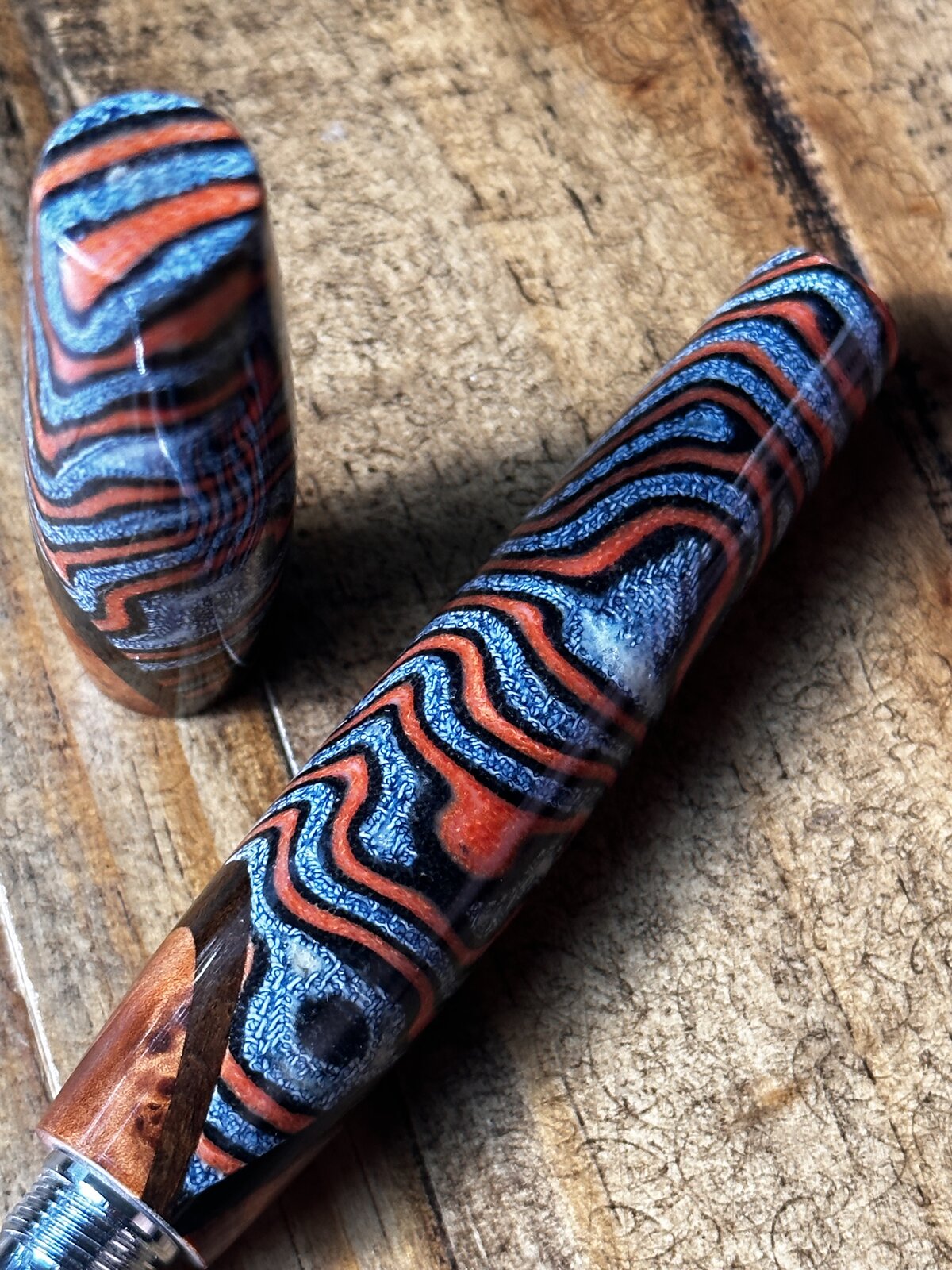

Have you consider a micarta blank with this color or even with this fabric? You can achieve many different patterns. I am adding pictures of some blanks I did. Cheers
