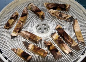

pics of mulberry blanks
Here are the first few blanks I cut from the mulberry. They were cut from a small knob I sliced off the side of a limb. I put them in the dehydrator to speed dry. Usually takes about 4 days.
Thanks Sharon for confirming the dehydrator for drying wood. I had considered this for a long time.Beautiful wood.
I dried the blanks for 4 days. First day no heat, then 100 degrees for 3 days, running 24hrs a day.
I turned the first one today. It was perfectly dry all the way through. (sawdust from drilling was dry).
These were 3/4 inch blanks. With 1 inch blanks, I dry them about a week. I have about a hundred 1" blanks in there now.

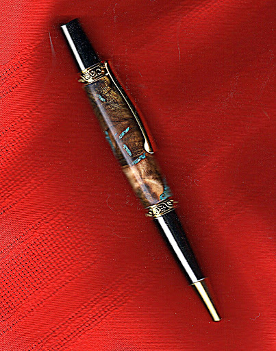

Here is the first pen made from one of the blanks shown above. Mulberry with turquoise infill on a TN Gold and gunmetal LeRoi special
