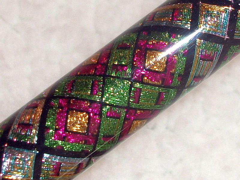

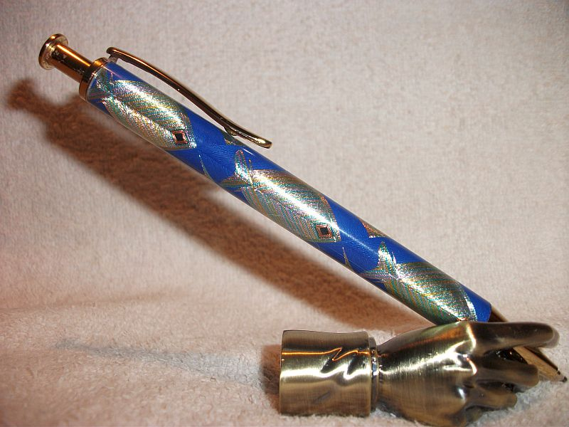

Looking for honest critique of my work. Two yrs in a row my submissions have circled the drain during the bash.Is it my pictures or my workmanship?Thank you for your feedback and thanks for looking.
Dale your work is awesome. I'm thinking many voted for your entries, I certainly did. Your metallic thread entry was amazing. It may be that there is a lack of understanding about how your blanks are made, who knows, please keep up the good work and thanks for sharing.
Rod
Have to say this one is on the membership. Nothing wrong with your workmanship for there are a handful here that can even play in the arena you are playing in. Your presentation was excellent and lighting was spot on. What I believe is as the one I think you entered the segmenting contest did not belong there. Now ask me what catagory I do not know but probably Advanced kit or something like that. You acceptance into that catagory falls on moderator of the contest so Maybe ask as a general question after the Bash is over the mass members here where they think something like this belongs so you know next time. There usually is a review of the Bash my Mike or if one of the other leaders wants to take on.
But you entry in the IAP category was spot on and as I said I believe the membership dropped the ball on this one hands down. I say that because that group of pens is a show of what is being done here at the IAP. To my knowledge there is not one thread tying pen in that collection and that is a ashame. There should be a representation to this artfield in pen making. My opinion and will stand behind it. Thanks for showing and maybe you can just donate it it if you prefer so that it can be seen by many over the years. I too believe not enough people know of this art. There are far more new members here that do not even know what the IAP pen collection is let alone what it takes to do what you do.
Dale, your pen is truly outstanding !! . . Awesome, as Rod said above !! . . I voted for your contest entry.
But our community is very small, and proper recognition for every aspect of pen-making cannot be made within the BASH contest structure, which has to "appeal to the masses" in a manner of speaking.
If there were a contest specifically for pens made with thread art, how many entries would there be ? . Even if the contest scope were broadened ?
I think people vote for design styles that they quickly relate to and with which they are fairly conversant in their daily activities and observations.
And, I think that people like you ... and me ... have to be content with a few words of recognition from "the few who understand" what we do.
So, keep up the good work, and keep entering the contests. . There are rewards other than getting First, Second, or Third prize !!
Your blank making is something I cant even wrap

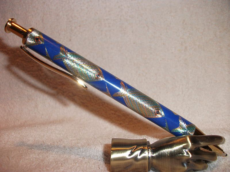

My head around, pun intended. The lighting in your photos could be better. There is a strong shadow that is distracting. Maybe a non descriptive holder also.
The fish motif I like but it is too monochromatic. It took me a minute to really see what was going on. Try making one that is more graphic, maybe look at color theory info. You could end up with a more dramatic and easily recognizable design.

Seeing that photo now for the first time , I very much regret not getting around to voting in that contest . An absolutely outstanding pen ! . The mass membership sometimes seems to be a herd following the leadership of a few who make very nice pens out of exotic woods , but tend to ignore different but equally nice material growing outside their back doors .
Agree that the shadow is too strong . The bright spot on the clip in the second photo is also distracting . To my eye , the colours work the way you have them .

Patrick, I see what you mean about the shadow,I am going to try getting better at taking pictures with the info Sylvanite has in the library.I chose to use the varigated thread over solid colors to give each fish slightly different coloring instead of them all being identical.I don't know much about art so choosing color combinations is difficult for me, but I will continue to work on it.

Adding my 2 cents to the comments above. Please don't take them harshly, I know that my tone for commenting is perceived as"too direct" sometimes but they are in a friendly tone.
The artistry is certainly there, but pens are meant to be touched and handled. I've had plenty of pens in my hands made with wood and various other material, so I understand how they feel. It is harder for me to connect to your pen, never held one, never looked closely or examined one. So yes, lack of familiarity with the technique and the end product makes it harder to appreciate your pens.

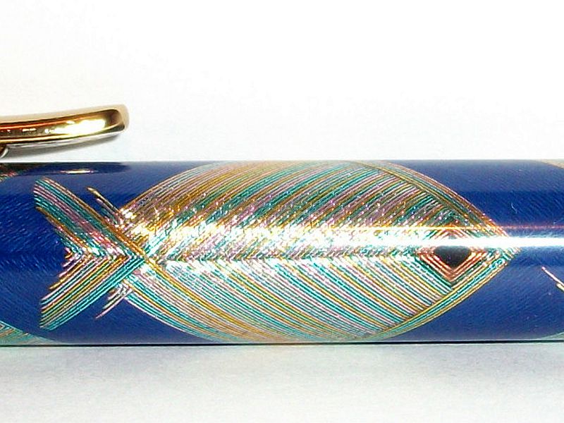

I believe some of these issues could be fixed by seriously improving the pictures. From the ones you submitted I see no details in the threading, I don't see the intricacy of the work. Close-up details would be a good start. Lighting is pretty bad, generating highlights and shadows that are very distracting. The background is not helping either, can't decide if it's a dirty rag or some kind of fleece material. And the severed hand that holds the pen is distracting as well. See here, my comments go not to your entry itself, yet your pen should be the center of attention. I'm not sure what would be the way to a fix, maybe find a photographer friend that has a good macro lens. This would be especially useful if at some point you wanted to sell your awesome creations.
Thank you for the feedback Fred, Yes the backround is a fleece throw.Gonna start putting more effort into picture taking,I don't understand any of the terminology so it'll be tough but I will work on it.I'll will include a closeup pic in the future so the individual threads can be seen.Using size A thread wrapped tight looks like it was painted on with no magnification, maybe thats why it hard to distingwish,I have used larger diameter thread when I first started doing this but it looks like rope in comparison.Gonna work on the photography for the future

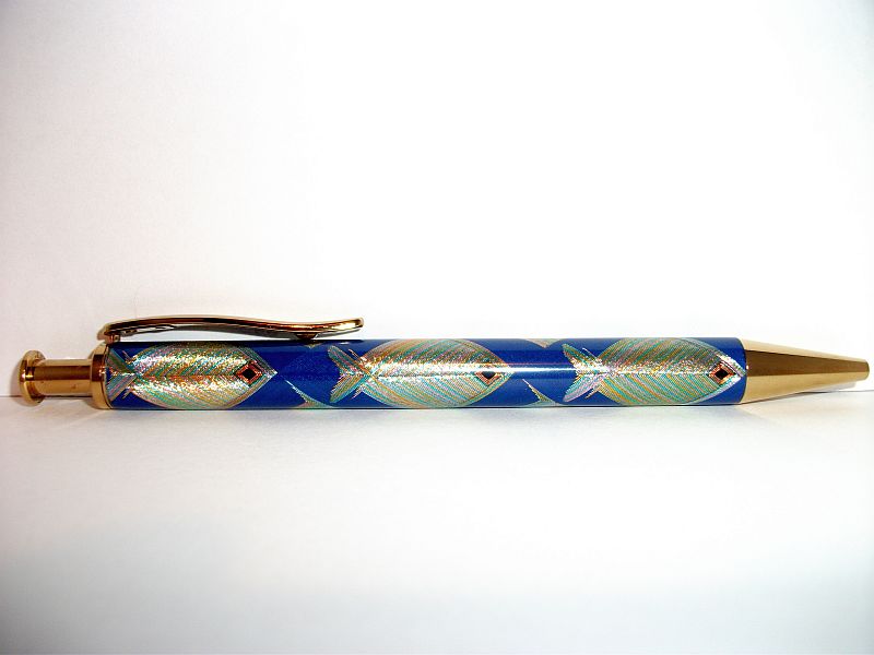

I took what you guys siad about pictures and tried again.I had a cardboard box,lined the back bottom and sides with computer paper.Laid the pen by itself against the back and took a pic with auto settings.Camera is a fujifilm J38.I also was able to zoom in on a small area of each pen.I hope this makes the details easier to see.Couldn't take a new pic of the other one, recipient already has it.
Very informative to see details, including one of these in future posts really helps to bring out the complexity of your work. The camera seems to be was is commonly referred to as a "point and shoot" camera, which often is designed for general photo taking and harder to control for situations like the pictures you are trying to take. Where is the light coming from? Can you move it? I think next you should try to take pictures that avoid direct light reflection (those bright light streaks in the middle of the pen), either by moving the light or by moving the camera slightly (up or down or sideways), or adding a light diffuser to your light source (like a translucent piece of cloth or plastic).
Huge difference. Stay with that. See you already improved and your so called question or rant turned into a positive.
Dale -
Those pics look better already.
As far as colors, you don't have to get into it too deep. Look into color wheels and their use. Basically you want contrasting, complimentary colors. What I think this one lacks. Think of your image as a decal or sign. It needs to be quickly understood.
The light is coming from the camera flash.I'll do some practicing with holding the camera at different angles as well as moving the pens around and see if I can get a better angle to avoid reflecting the flash.

Many of the patterns I've done are modified versions of patterns created on computer by Adamir Romano. Regularly have to adjust thread count and spacing to get it to fit the tube dimentions. It will be quite the undertaking and possibly boring to read because the elaborate patterns don't look like anything until they're 95% done.I will try though to make it understandable as I can with my 6th grade education.
