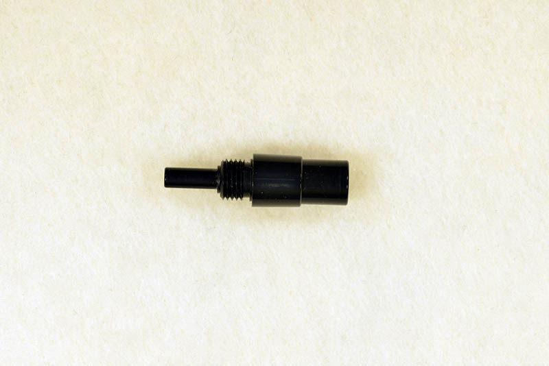

As Dan said, M7mm x 0.75mm x 1 is the SKM-88 thread size. I just did the threading for one a couple of days ago and can vouch for that specification.
That is an easy tap and die size to get quite cheaply. I got a set from a local tool store not long ago off the shelf (not special order) ... cost under $10 for the tap and the die was not much more ... tap made in China (no name), die made in Poland (TMX brand) both HSS.

thanks to all for the size, I used to have thread gages when I was working for NAPA but that was 20+ years ago

thanks more4dan and magpens for the info, I used to have thread gages when I worked For NAPA 20+ years ago
