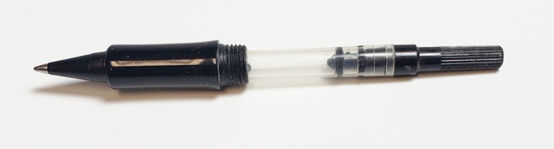

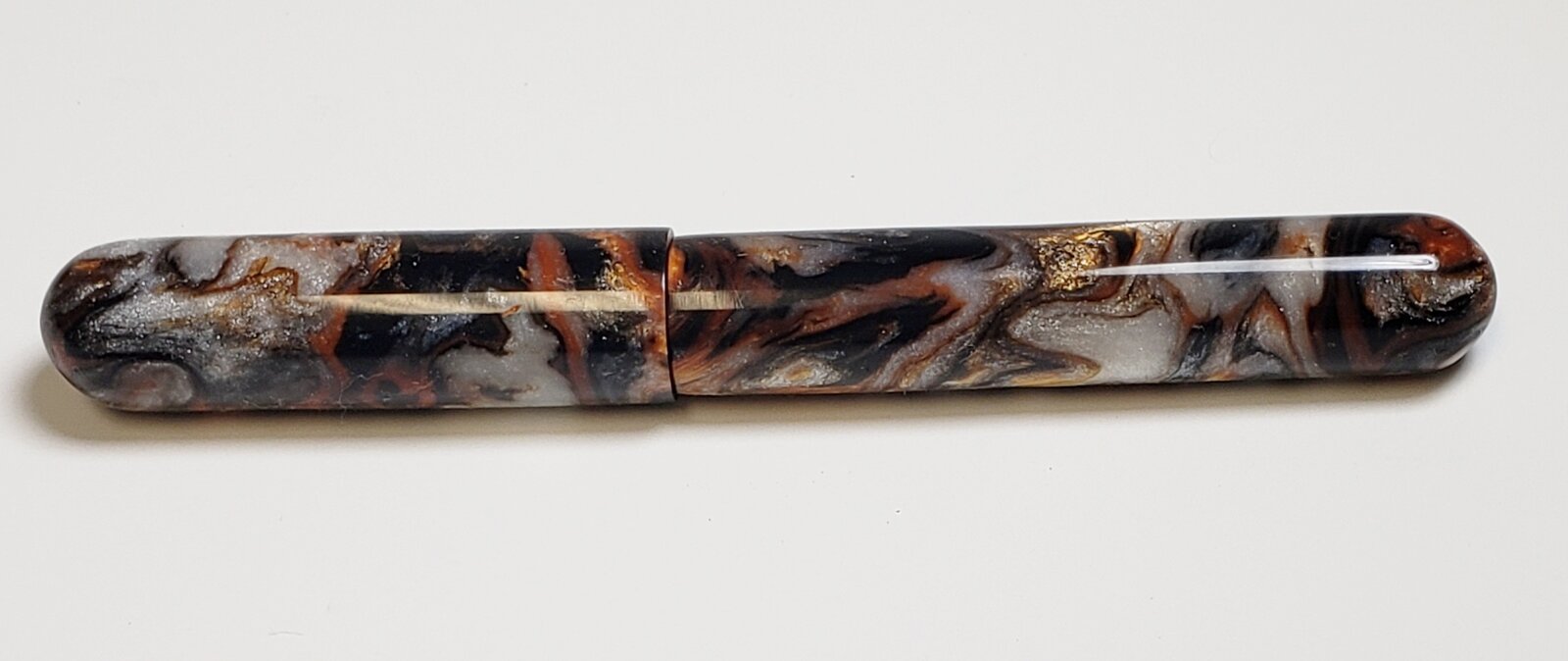

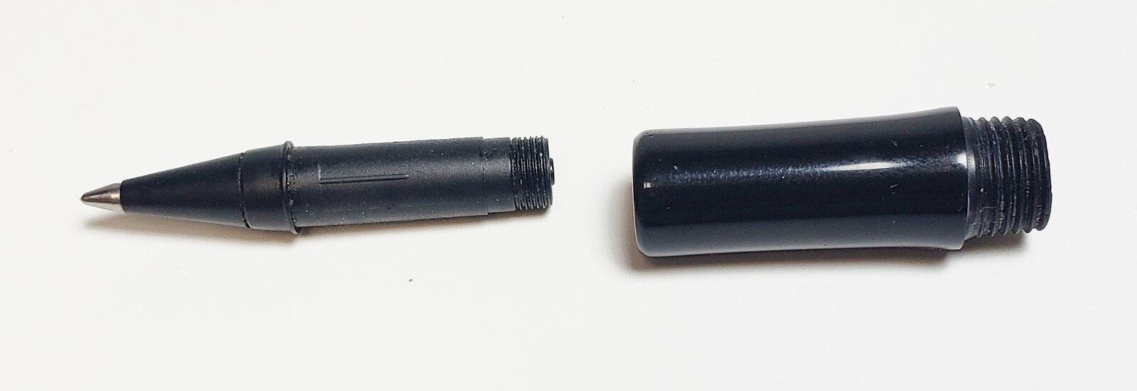

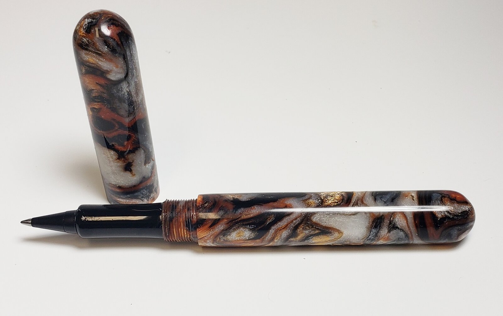

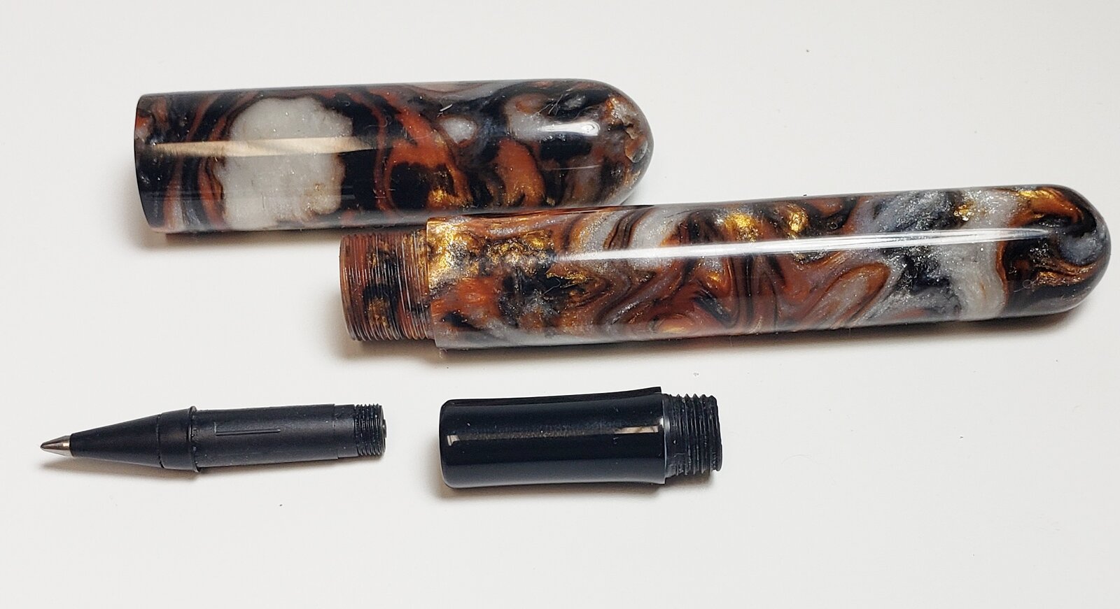

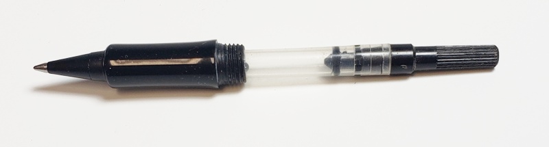

This pen uses the Schmidt Rolling Righter cartridge system. Ink supply is either a cartridge or converter.
Material is from Eugenio Soto at muttblanks.com and the section is made by me using Alumilite Clear Slow.
Cap: dia .72 length 2.65
Barrel dia .66. Length 3.32
Cap threads M14x.8 TL
Section M10x1

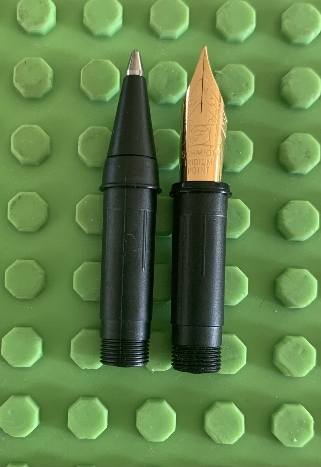

Well done.
My first plays with kitless were with the Rolling Righter because the tap to cut the section thread is the same one Schmidt uses for their #5 fountain pen feed, giving you the option of using either in the same pen.
I have never used Schmidt #5 nib units so it is good to know they are interchangeable. I knew the thread pitch was the same but had no idea they were interchangeable. File away for future use. Thanks Pete.
