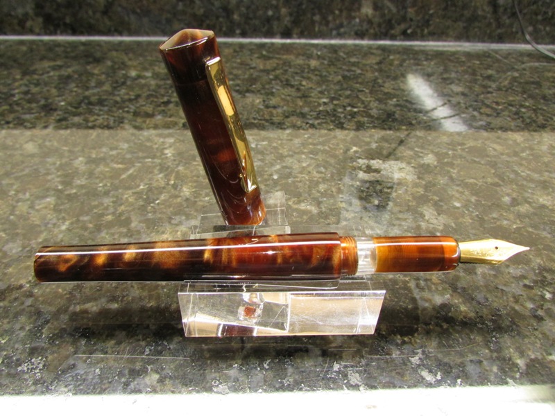

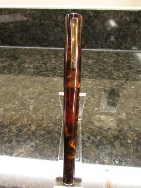

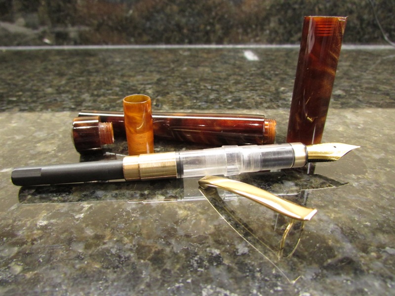

Here is my first attempt with a Schmidt Piston Filler unit. The most difficult part was the section cover which is almost paper thin where it threads onto the ink window.
Cap to barrel threads M12 X .8 triple start
Section cover and body to piston unit M10 X .5
Weight filled 28.9 g
Length capped 6"
Length uncapped 5 3/4 "
Length posted 7 1/4"
Barrel diameter at widest point 14.66 mm
Cap diameter 15.64 mm
Section cover at widest point 11.1 mm
Comments welcome.
