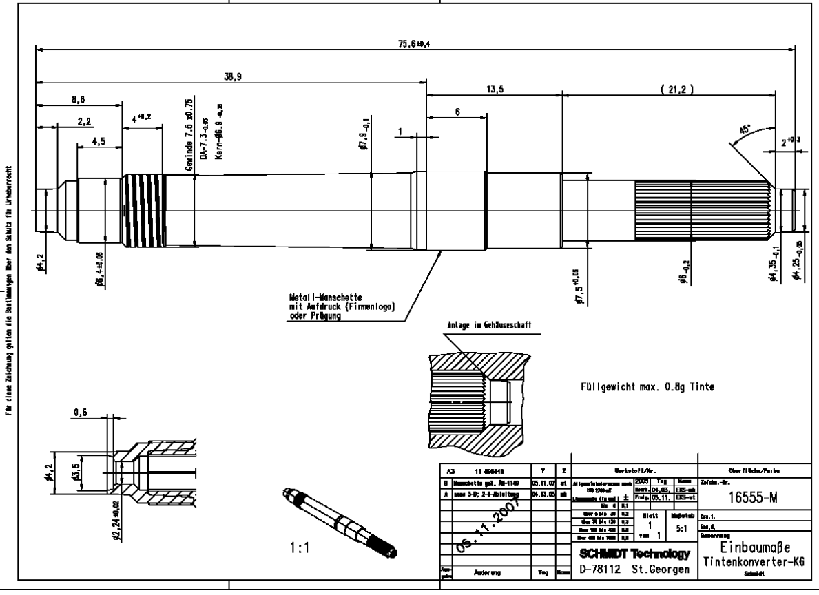

Can anyone confirm that the Schmidt K6 converter uses M7.5 x 0.75 threads? I have now tried two different crap taps from Amazon and eBay, but neither seems to fit. Neither is stamped, so I am guessing the taps are junk or just the wrong size. Does anyone use another, close, more readily available tap for this converter?

Yes, M7.5x.75 is correct. I got mine from Richard Greenwald back when.
Thank you. I found another to try on Amazon. I'll give it a shot.

I single point mine, so I don't really know what limit/fit of tap would work best. I do know that the thread isn't typical metric 60 degree. The root is truncated and requires a larger drill than what one would calculate for an M7.5x.75. The way I make mine is to cut the section to accept a cartridge or K5 converter and then cut the threads for the K6.
Yes, the 7.5 x 0.75 measurements are correct. It's usually not difficult to find this tool.
