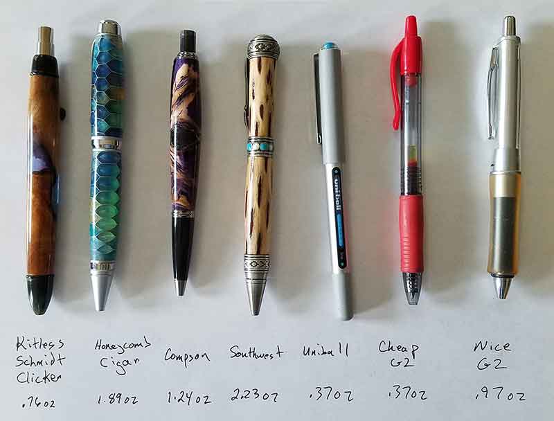

budnder
Dec 28, 2015
527
Chicago/Tucson
Out of curiosity, I went into the wife's pen cup, which has her "daily use" pens. Some of them I made, some are purchased - she is agnostic as to their origin or cost - it goes into the cup if she likes using it. She likes clickers and only tolerates twist pens. So here's a pic of what's in the cup by weight:
