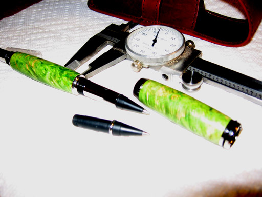

Dean -- I am adding a couple of photos
One is the Baron with the nib unit installed - I did not install the trim ring yesterday.
2nd picture shows a second nib unit with the trim ring from the Fountain Pen nib installed. It was a tight fit, but installed with finger pressure. The small flange on teh nib unit is visibile in the 1st photo, and acts as a stop with the trim ring installed.
When we change ink, I will move the trim ring over but having made one or two spreading messes with ink, and packing to get the ferry, I will pass on the opportunity this time.
Still write like a dream --

Russianwolf said:
admittedly it looks better on the Baron than Jrs as the black threads balance the black tip.
In general, I don't like the black threads, but I agree with you this looks pretty good.

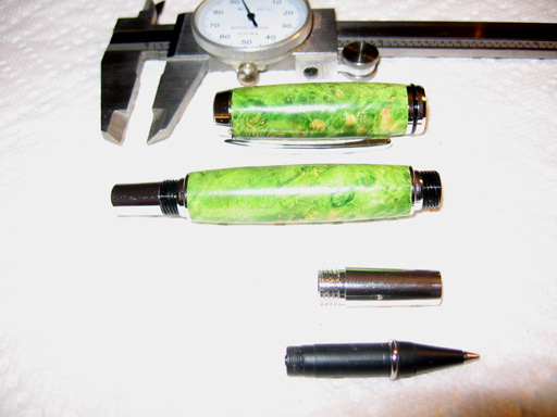

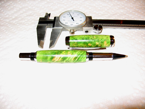

Additional Baron Photos
Dean - I was not sure what you were asking for in the additional photos -
I checked and this was the last Baron FP I had in stock. Lots of rollerball versions
one photo has the pieces aligned -- nib replacement with the trim ring from the fountainpen nib installed (I hands are ink stained of course, but nothing worse)
The Baron front end for fountain pen - round metal -- for roller balls this is a faceted piece
Baron Body -- same for FP and RB - change the tip and change the form
Cap for the pen
2nd photo is the assembled pen with the trim ring from the FP nib installed
I am headed to the Desert Woodturners Roundup and think I will take this one and the desk base along for the Gallery -- should generate some discussion (presumes I can get if from my spouse.
P.S. The ink cartridge is down about 1/4 to 1/3 of the length at this point - so not a huge amount of ink to start this working.

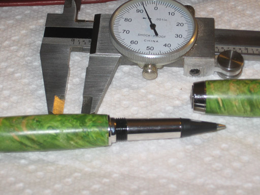

As I promised earlier here are the photos.
This first photo is of a Rollerball Converter after it has been put in a Jr Gent II fountain pen nib holder that had it's threads chased with the M6.4 x .5 tap. The photo is undoctored and the threads were not wiped off.
Here is the Rollerball converter in the Jr Gent II fountain pen nib holder. Notice the ring on the converter is seated full to the metal. This screws in and seats perfectly.
This last photo is of a brand new converter on the left, the one in the center is the one that was in the two photos above and the one on the right is a new Heritance nib and feed which is also a M6.4 x .5 thread.
I have not tried to put the original nib back into the holder but don't really feel a need to with the Heritance nib and feed holder. By simply chasing the threads of the Jr Gent II nib holder, I can now offer my Jr series pens in either fountain pen or rollerball that uses fountain pen ink. I can also offer both for the same pen. Thank you Ken for bringing up the thread chasing idea which had never occurred to me. Now there is simply no thread issue with these by simply hand turning a tap in the feed holder. It literally took no more than a minute to do this by hand. Also thank you Ken for testing this on the Baron/Navigator type pens which we also had not considered. Expect a big thank you with your order we are shipping tomorrow.

Sounds better but has anybody measured the diameter of the original fountain pen part verses the rollerball part. I'm still betting its slightly smaller and riding the threads instead of enaging them.
While I am not 100% sure of what you are asking a measurement for, I can tell you this. When taking digital calipers and measuring downwards of the thread section of both pieces (so as to not get caught inside a thread portion and mess up a measurement) there is only a very minimal difference - one which researchers would consider within normal tolerance.
The original fountain pen measures .249 and the converter measures .248. This should not be a problem especially for a chased component.

Dennis and Mike -- I stuck the dial calipers on the stock nib for the baron and it was 0.002 smaller -- but that is within the variability of the dial calipers and I did not have the time to dig out micrometers and try for a better meaurement.
I would expect the stock nib assembly to be a bit more loose and not be as completly engaged in the threads.
I am viewing this as moving into the grey zone of semi-custom work and parts may not be as generally interchangable. One of the rationale for chasing threads is that the pieces are coming from separate manufacturing streams and the probability of all going together as if by magic is likely a low number.
