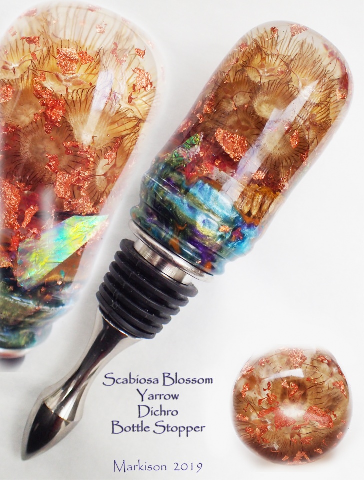

More botany.

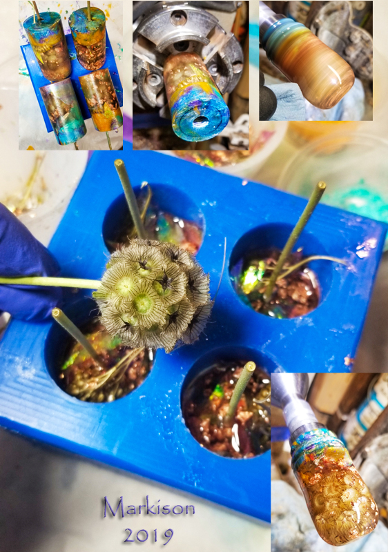

Steps:
Initial casting done by slowly submerging the Scabiosa blossom, some yellow yarrow, and dichro film half way down into the 2/3's full (PR resin/copper flakes)Stoner Mold Release-sprayed PTown Subbie 4 stopper mold; 50psi for 2 hours.
Second casting was done with mica powder-colored PR/copper flakes/more dichro - filled to the top; 50psi overnight (second opaque casting done to conceal the drilled/tapped hole).
Easily unmolded by pulling up the blossom stalk.
Drilled, then tapped on the lathe.
Turned and polished as usual:
attachment.php
attachment.php
Happy Sunday to all - Bob

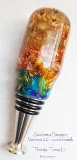

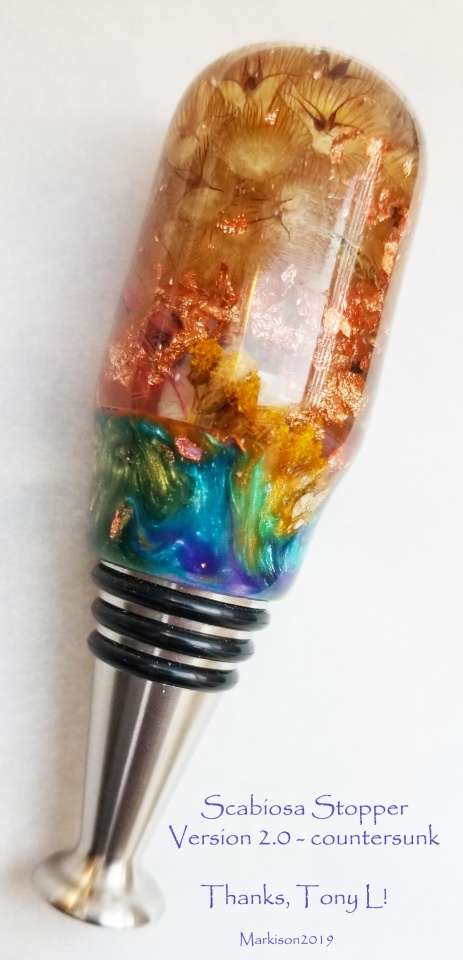

Special thanks to Tony L, who kindly suggested countersinking the bottom for better over all appearance - here's Scabiosa Stopper version 2.0:
attachment.php
I am continuously and humbly grateful for the kindness, experience, and generosity of this forum's members.
Thanks again, Tony L - Bob
you are welcome, and looks great, but I don't want to appropriate credit. It was Ruth Niles that gave me the idea. I think it gives it a more finished, unified, look.
