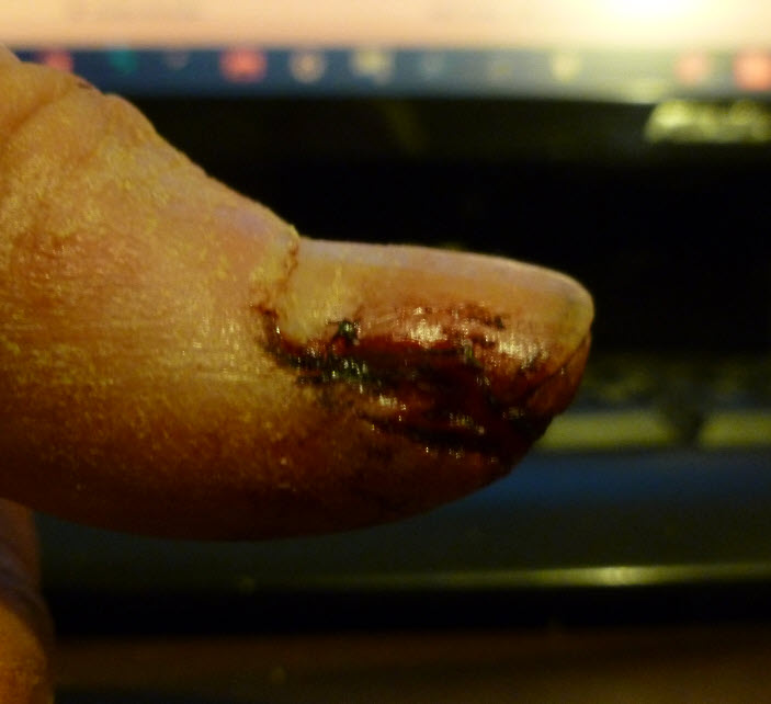

For the longest time I wanted a Sawstop and thanks to my good wife's generosity I got one about 18 months ago. Mind you when you can get 30% off it is hard to say no! To no surprise it is an amazing saw, much better than anything that I had ever owned. My wife's motive was that I might continue to keep all of my digits, which of course I subscribe to. Indeed the safety system does work including when you accidentally contact something metallic (rats!). Oh well, off to the store for another cartridge. However, the first time that I foolishly (impatience is not good in woodworking) touched the blade the blade stopped but unlike all of the Sawstop videos the blade did not drop below the table thus taking a huge chunk out of the end of my left thumb. It took 4 weeks to heal and it still plagues me at times. So I scoured the manual and found the get out of jail clause "the safety system helps to prevent injury". It does not say prevents. After much discussion with Sawstop, who always supply a new cartridge when it "saves" a serious injury (not sure about their definition of serious), it became clear what had happened. The blade drops below the table using the angular momentum of the blade. It all makes sense BUT what happens if the blade is not running at full speed? Below a certain speed it will not drop down. I had stopped the saw and it was slowing down when I reached for a cut off piece (yes, I no silly f$^&) - hard lesson learned and never to be repeated! So you have been warned. The Sawstop is a great saw. I have never had to make any adjustments since I got it. It just keeps on cutting clean and straight!
When in the local stores that sell Sawstop I asked about the safety system and of course they trot out the Sawstop mantra and show me the videos. There was not a single store that knew about what happened to me. It is hardly surprising that Sawstop don't show a video where someone actually gets hurt. Ok not likely to lose a digit but what I got was way more than a small nick, which is what they will tell you.
Wow, that looks really nasty! At least you did not actually lose the digit! Thanks for the heads up though...man, it is sometimes all too easy to be stupid around cutting tools...
I did a really stupid thing myself not too long ago...maybe about 3 months back. I was having an issue with the belt in my Laguna Revo 1524, and it seemed like something was stuck in the belt. So, idiot that is me, I took a cut of some 3M white pad, and held it for a moment against the back of the belt, while the lathe was on at the lowest speed for that belt setting (~300rpm). I don't honestly know what I was thinking, I loved physics when in school and know this stuff, and should have known beforehand exactly what was going to happen. For some reason I thought I could hold the pad there while the belt scraped against it, which is of course not what happened. It instantly got yanked down, and...my index finger of my right hand went down with it. I reflexively snapped my hand away, but not before the tip of my index finger just barely got caught between the wheel and the belt.
At first I thought I'd miraculously gotten away scott free...as my entire hand could have been pulled in and completely mangled, ending my career as a software engineer and my new stint as a woodworker. It didn't take long before I realized I didn't quite get off scott free...the entire tip of my index finger turned purple within an hour, and was very painful for weeks. I did end up having to program with one hand on the keyboard for a while, or more like 1.5 hands. I am actually still dealing with it...the crushed part of my fingernail is still growing out, and my finger is still healing. Interestingly, I expected the entire nail to fall off...instead however, parts of it have fragmented off bit by bit, and a new surface is finally emerging. It is much thicker than it used to be though...and, I don't know if that will ever change... Feels odd, and there is still a small but deep ache in the tip of that finger at times.
Regardless, the healing process is a very long drawn out, ongoing one. That episode, as close as I got to probably losing my entire hand, taught me an entirely new level of respect for these machines. I'm careful on a whole new level now, and don't think I'll ever lose the respect I now have for these skin-shredding, bone-mangling machines. I suspect I'll never use a bandsaw or a table saw without some kind of handle to move the wood, so I can keep my hands far, far away from any blades. The fear of losing a digit (or worse!) is deeply ingrained now. (Maybe some of us just have to learn it all the hard way?) For a moment I truly wondered how I'd not just lost my entire hand, mangled beyond repair as it was yanked into, and around, and around and around, that darn pulley...

I am truly sorry to hear about @NGLJ's injury. I hope that by now it is healing well, and whatever discomfort remains continues to fade.
I would like to see a more detailed description of how the accident happened in an effort to help us avoid it. I got the impression that the blade was slowing, you reached for the cutoff, and then the brake triggered, but the blade did not go down. Is that right?
Here are some questions that I wonder about:
The blade was slowing, but was it still turning pretty fast, or closer to the stopping point?
Where did your finger contact the blade?
Was the blade guard installed?
The blade must have stopped slower than usual. Do you have photos of the brake and blade?
