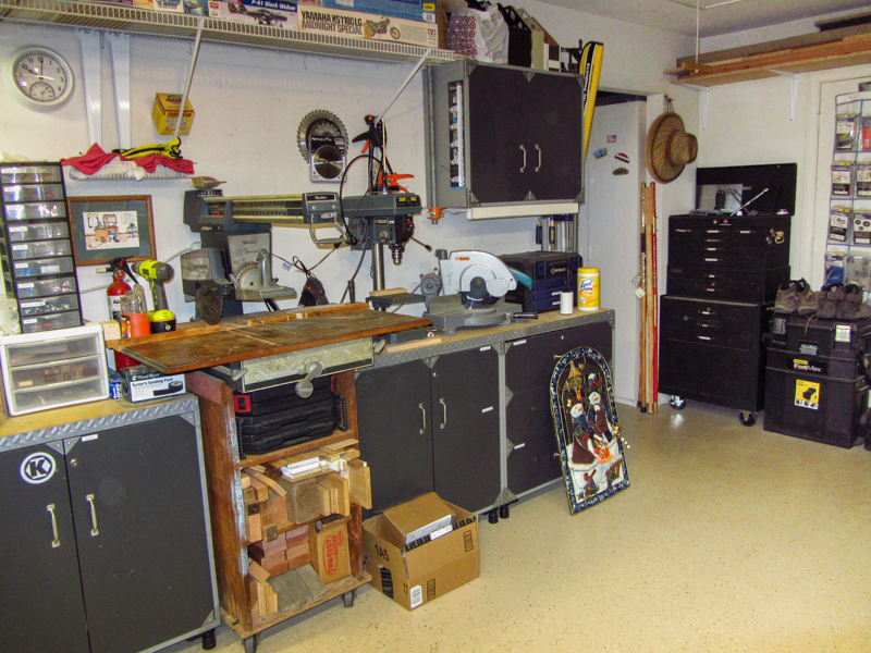

I was using an old radial arm saw that came from my dad and is probably 40 years old. The table and back stop probably had more cuts in them than solid material! :eek:

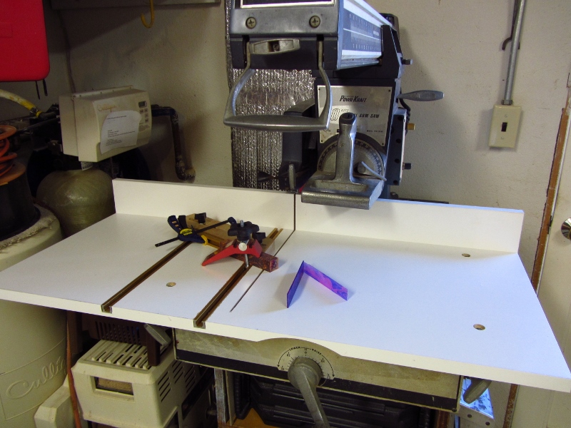

I decided to see what I could do to improve that without breaking the bank. Here is what I came up with:
attachment.php

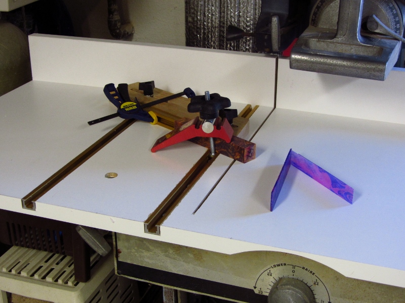

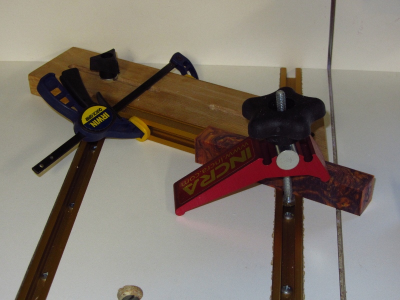

For about $50 in materials I replaced the table and backboard with melamine, added some Incra T-track and hold down clamps, and an adjustable board for angle cuts.
attachment.php

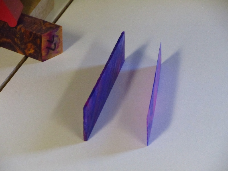

Here is a sample of how fine I can now make cuts:
attachment.php
