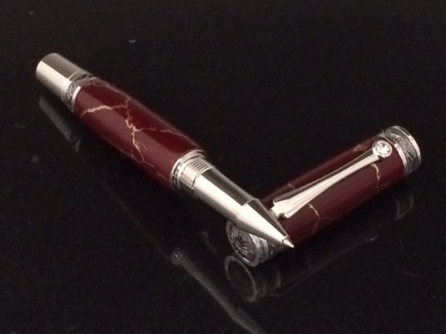

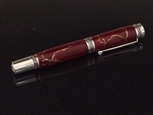

Here's a Majestic kit with a red with gold matrix try-stone blank that I turned this morning (rainy Saturday - good time to be in the shop).
I do have a question. I noticed that on the Majestic kits, the rollerball tip and the fountain pen tips are interchangeable. This does not work on the Jr. Statesman pen kits. Does anyone know where you can buy just the rollerball and fountain pen parts of the pens? I'd like to make them and offer the person the option of using it as a rollerball or as a fountain pen. Any help would be greatly appreciated.
Comments & critiques welcome.

Outstanding pen, the blank is a great fit with the kit, it looks as though it was made just for that kit. Your fit and finish is spot on.
Hi John, great looking pen! Here is a link to the discussion on Jr II series threads in case you missed it.
http://www.penturners.org/forum/f14/gent-statesman-jrnib-compatibility-not-118668/
In the past they were interchangeable - in the future maybe, If you have some older kits, they will interchange. I don't think you will find a source for the sections only - and if you did, would they fit the coupler you installed?
While not something you would want to do on the fly, it is fairly easy to knock out the coupler/RB section and replace with a coupler/FP section. If you charge $30 for a FP upgrade with a Bock nib, you will at least make it worth your time until CSUSA gets their threads uncrossed.
