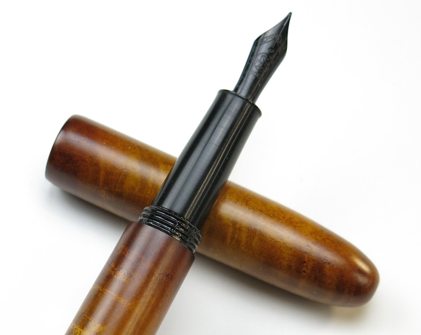

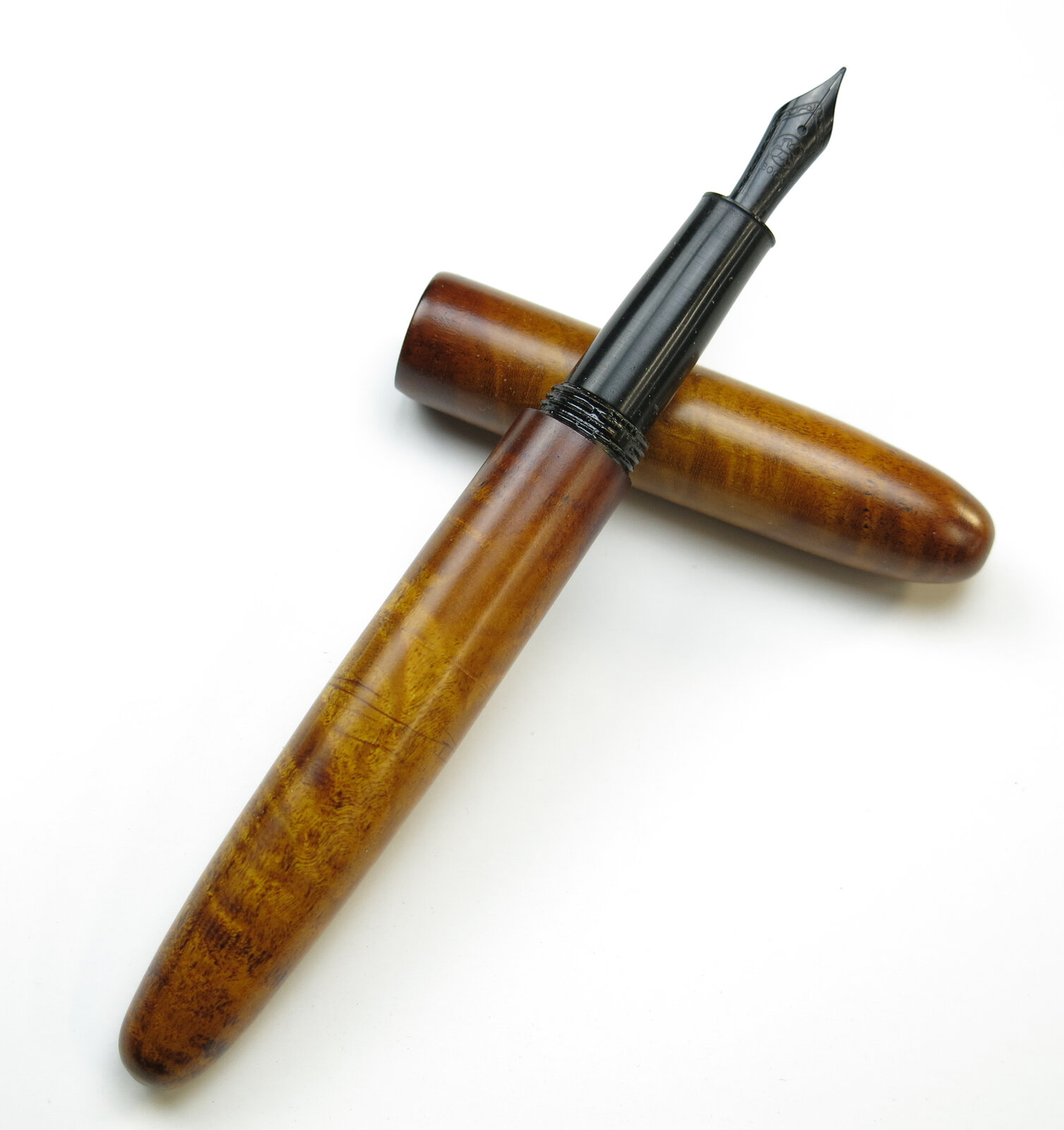

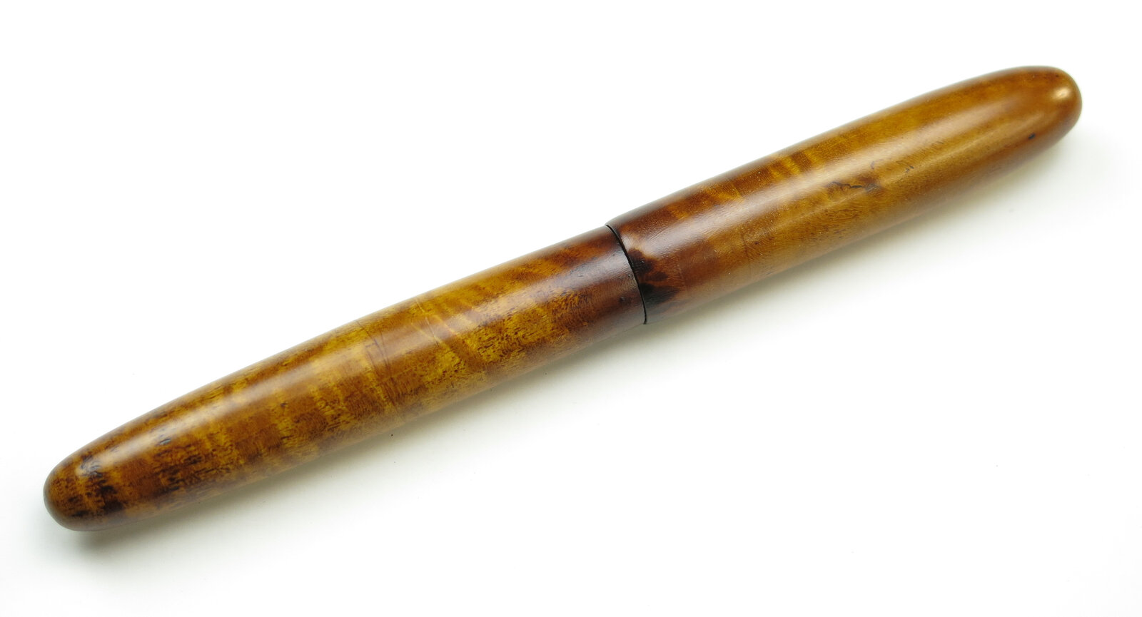

Ceylon satinwood with African Blackwood section, fuki-urushi finish
Very nice, I like it a lot.
When I first saw it , I thought the section and threads were black Ebonite, but after I read your description, I see it's African Blackwood. Are the cap threads on the section , and in the cap, both cut in wood ?
Thanks. Cap, barrel and section threads all cut in wood using thread mill jig on the metal lathe.
thats beautiful. I love the satin finish , doesn't detract from the workmanship at all and draws the eye along the profile.
A lot of work and love has gone into that pen.
Well done
Beautiful pen. I have always wondered how you would fill a fountain pen with a wood section. Is the finish sufficient to protect against the ink, or is the pen filled using cartridges?
Thanks. It's got a Schimidt piston converter; can also use universal standard ink cartridges. The urushi finish is highly resistant to almost everything except maybe a lot of UV exposure. The inside of the pen is also moderately protected also with a thin coat of urushi.
That is great. This makes me want to get into urushi.
Dictum in Germany has got a limited selection of urushi supplies and lacquer. The prices are high though; would probably be cheaper to source directly from Japan, even with shipping costs. The type of urushi I mostly use for fuki-urushi technique (Kijome) is expensive but definitely cheaper from Japan. Right now most Japanese suppliers aren't shipping to the US, but not sure about Europe.
