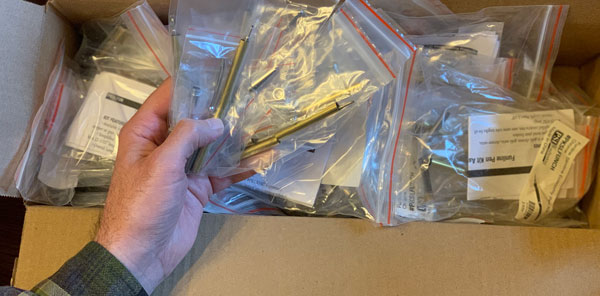

Extracting all the pen parts from their individual bags takes forever. I definitely waste time and create a lot of garbage.

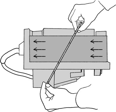

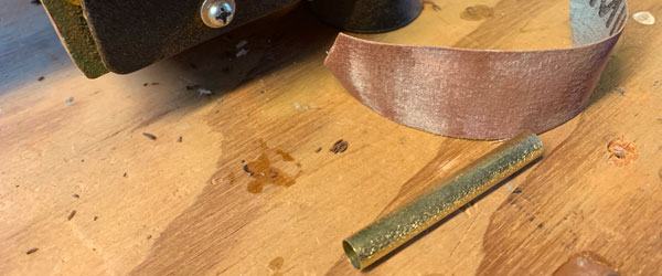

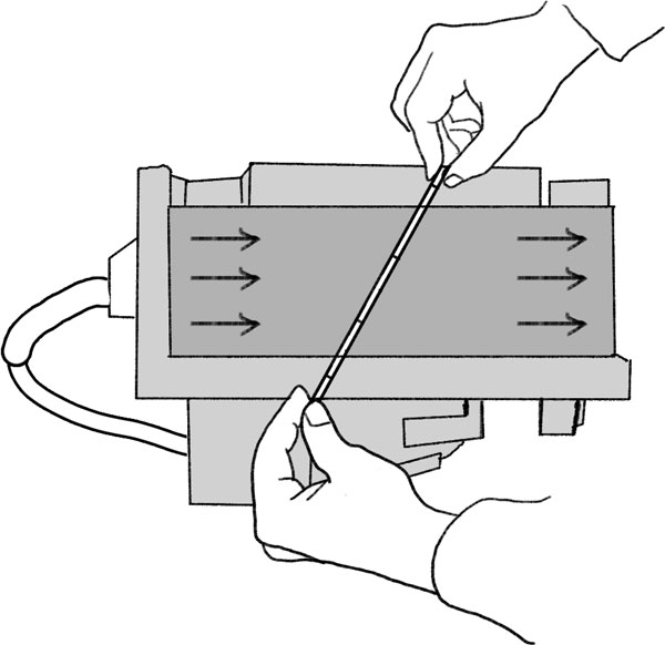

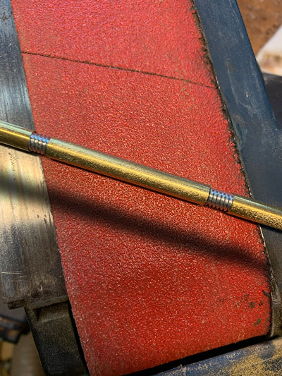

Here's my process
(Not rocket surgery, just how I do it.)

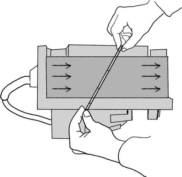

1. Turn my portable belt sander upside down.

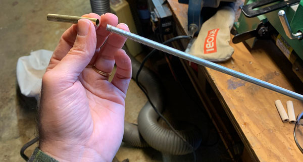

2. Load an old mandrel (or better, a 36" long 1/8" rod from HD) with lots of tubes.

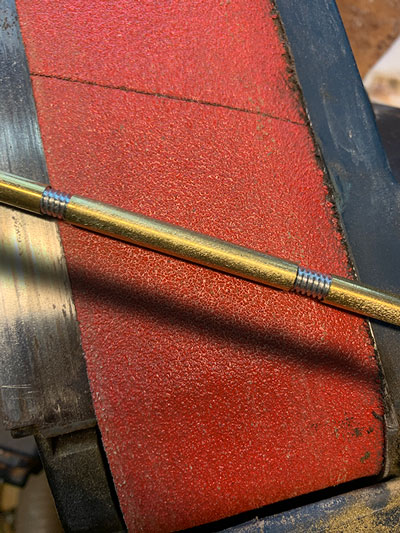

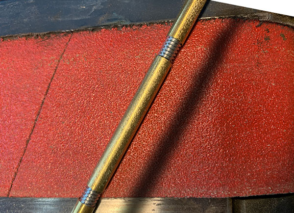

3. Holding the rod diagonal to the direction of the running belt, the tubes turn themselves and get a good scuff.
4. It takes no time to fall into a rhythm and work through all the tubes in one sitting.
