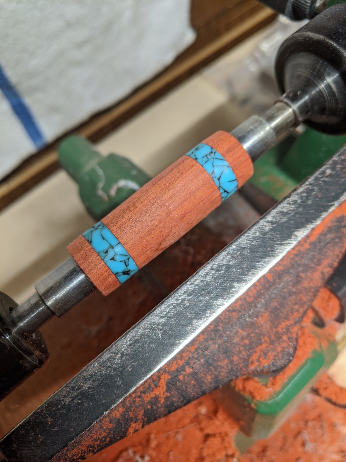

JettLake Member Joined Apr 3, 2019 Messages 23 May 4, 2020 #1 My first segmented pen. Do I need to worry about sanding Bloodwood with an acrylic? Attachments IMG_20200504_190612.jpg 261.7 KB · Views: 203
Displaced Canadian Member Joined Aug 5, 2009 Messages 3,250 Location Millersburg, OR May 4, 2020 #2 Not as much as some. I found with light and dark wood it works best if you have to sand to final shape to take a light pass with a skew after sanding.
mick Member Joined Mar 13, 2005 Messages 2,608 Location Decatur AL, USA May 5, 2020 #3 You'll have not problem with that. In the future when you segment light and dark woods together put a couple of coats of thin CA on before you start sanding. This has always worked for me. Good luck! Sent from my SM-G955U using Tapatalk

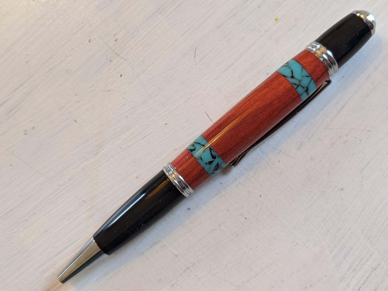

JettLake Member Joined Apr 3, 2019 Messages 23 May 6, 2020 #4 It turned out fine. I overthink alot. Attachments IMG_20200506_192207.jpg 183.2 KB · Views: 193
mark james IAP Collection, Curator Joined Sep 6, 2012 Messages 13,707 Location Strongsville, Ohio May 6, 2020 #5 Very nice work on the segmenting! Stay healthy
