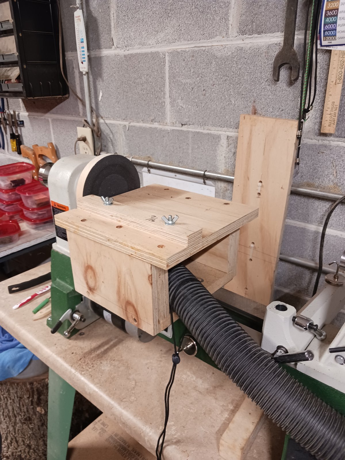

I use a barrel trimmer and have had no problems over the years...except no checking how to sharpen the trimmer. Had to buy a new one. I do have a sanding station that goes on the lather but not for pen blanks. I do plan on using it for segmented blanks. Photo attached.

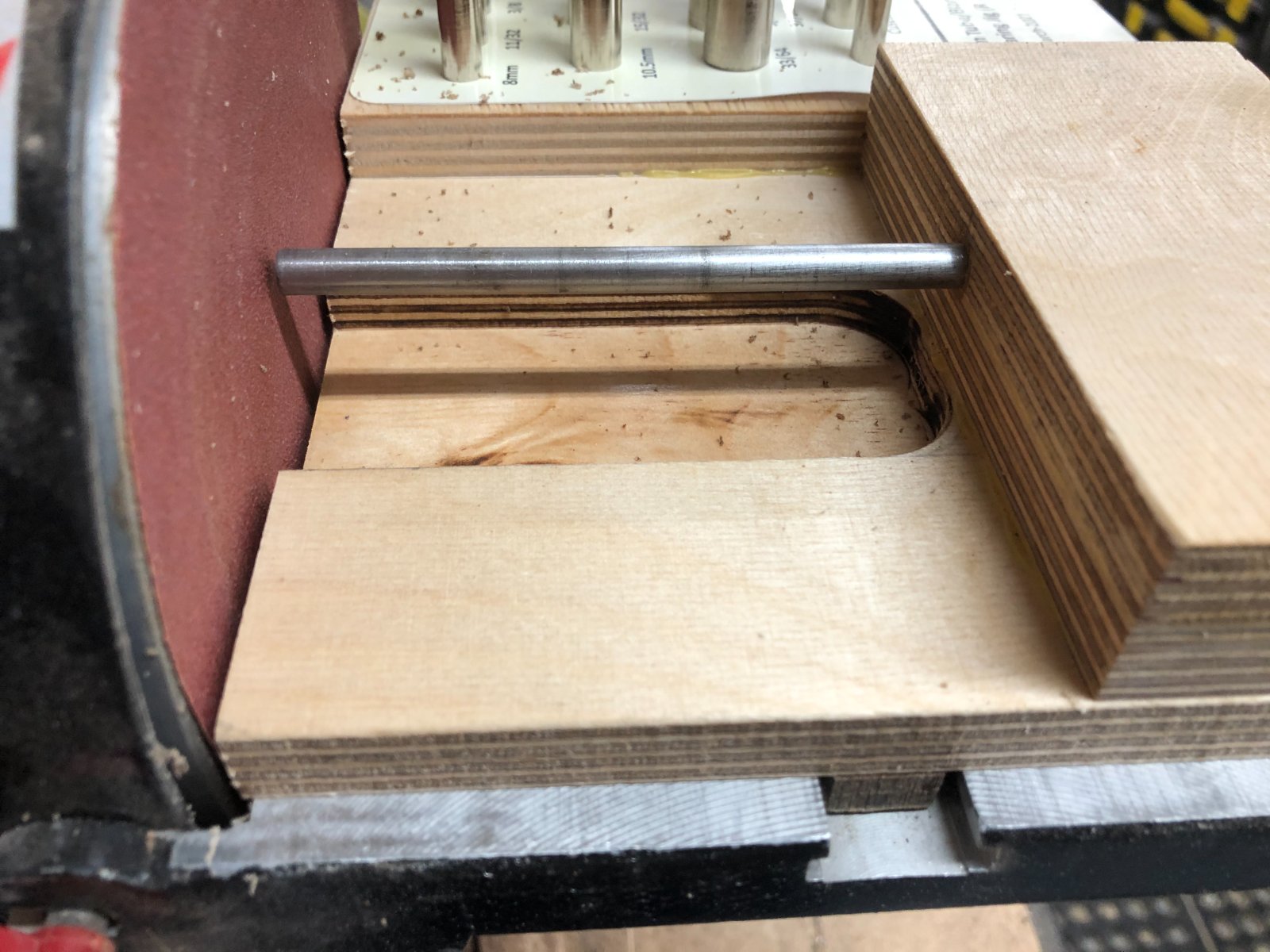

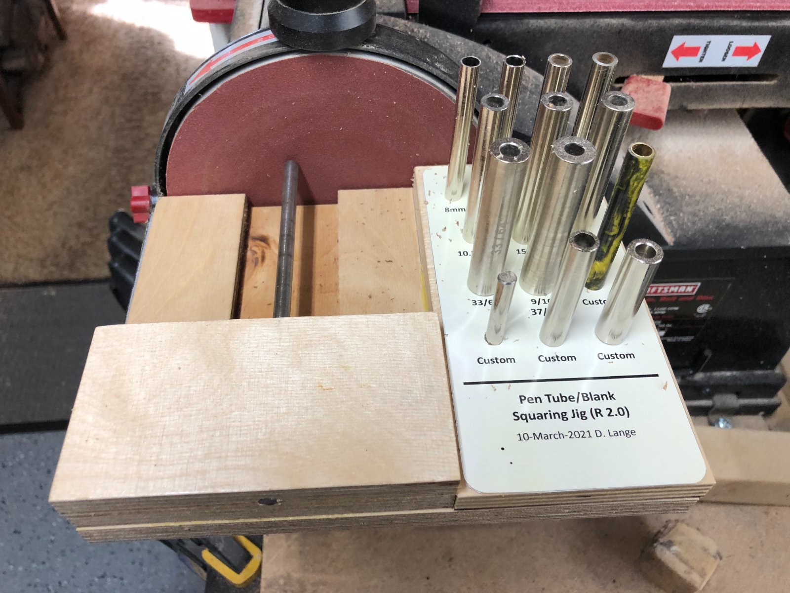

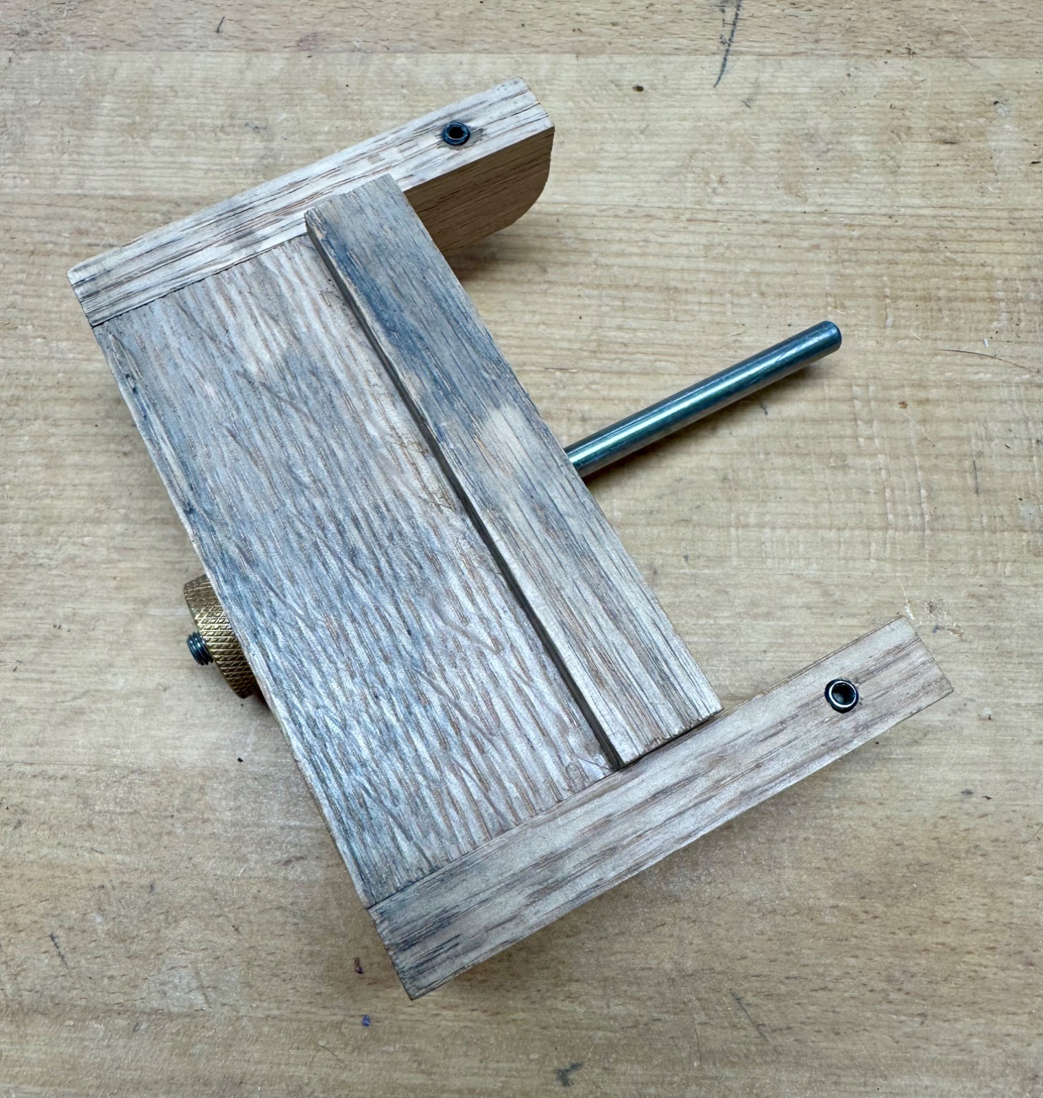

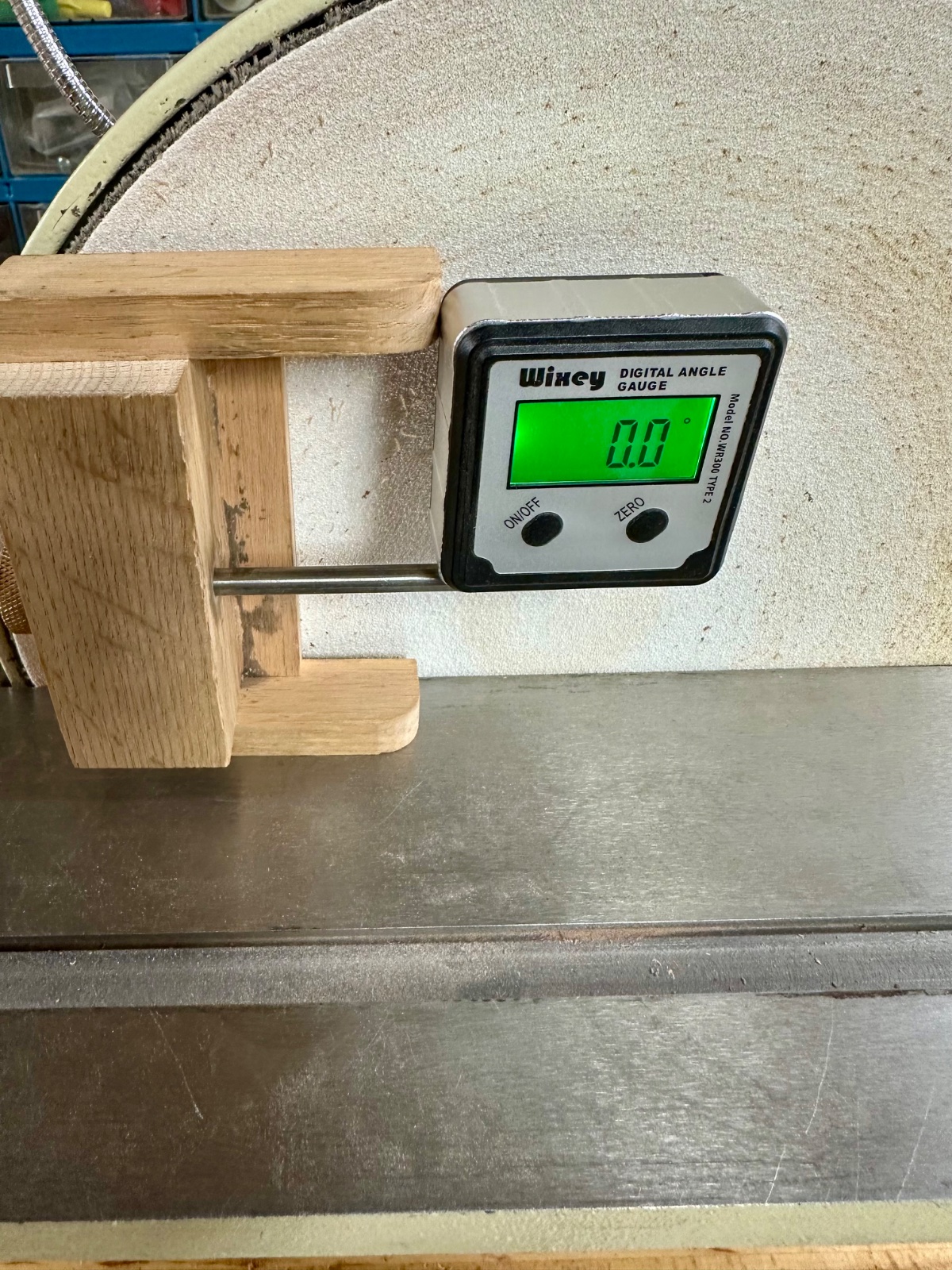

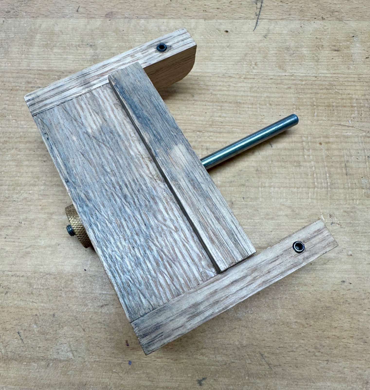

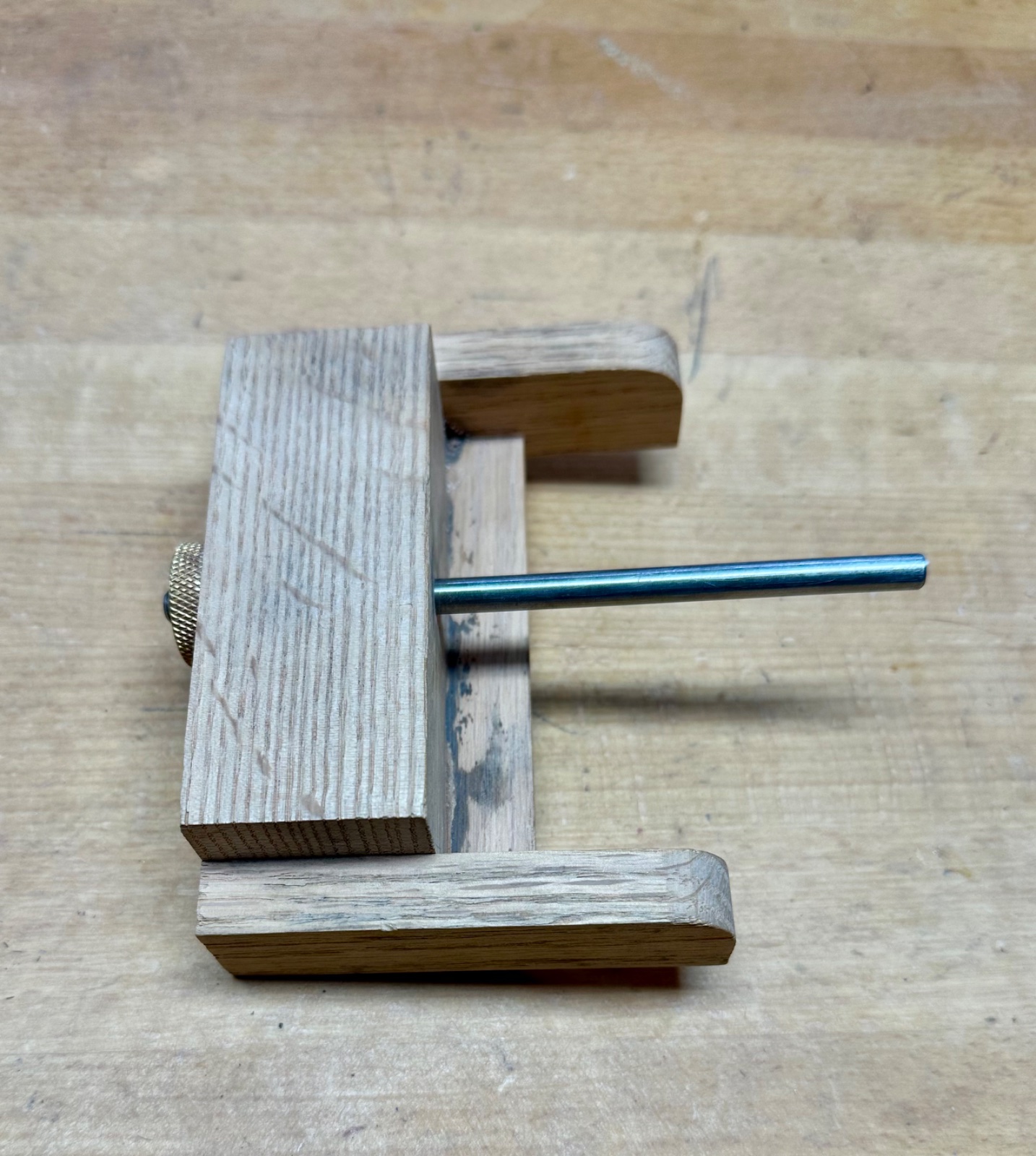

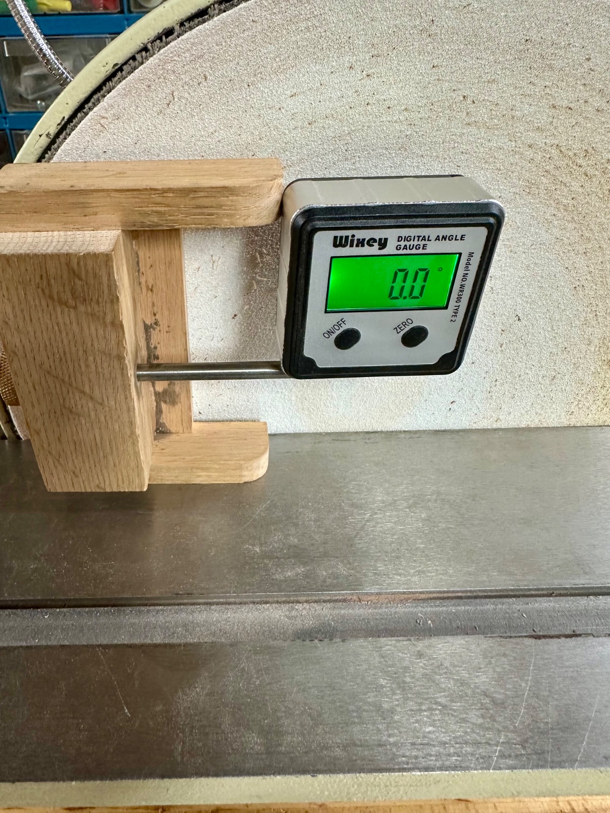

I started out with the Universal Pen Blank Squaring Jig from PSI. It clamped (bolted) to the fence guide on my sander, but I was not happy with the amount of slop in the miter bar on my stock sanding guide, so I built my own jig with a much tighter miter bar. (Note that the PSI jig worked good - it was my sander's miter slot and bar that were problematic).
I based my jig on the PSI design and used a piece of "D" Drill Rod for the shaft. I also I added a holder for my set of Barrel Trimming Sleeves. I make any custom sized sleeves using a 7mm tube and a scrap piece of blank material tuned down to the appropriate size. A couple of pictures follow. - Dave
(PS I think there are several squaring jig designs in the Resource Library also).

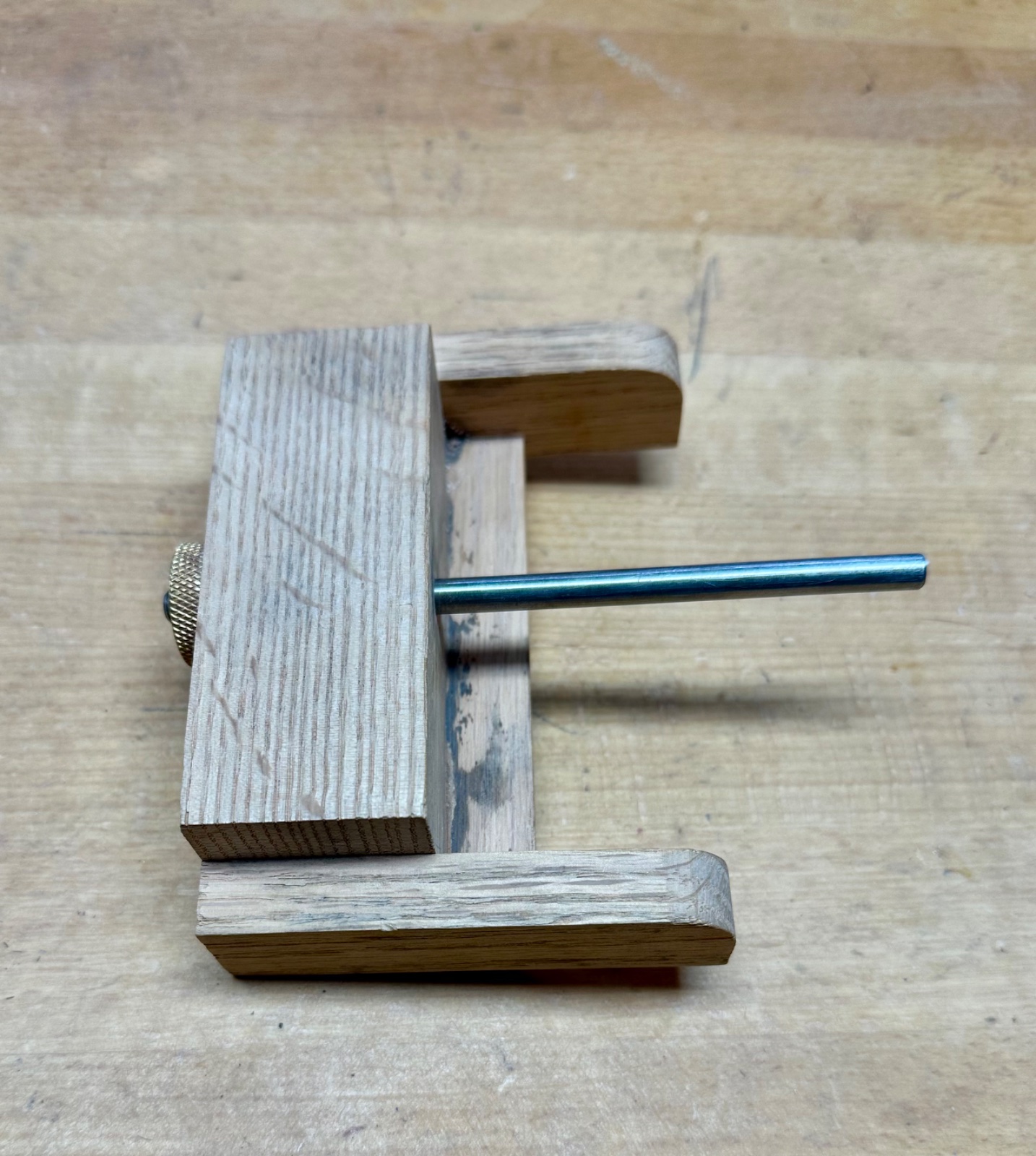

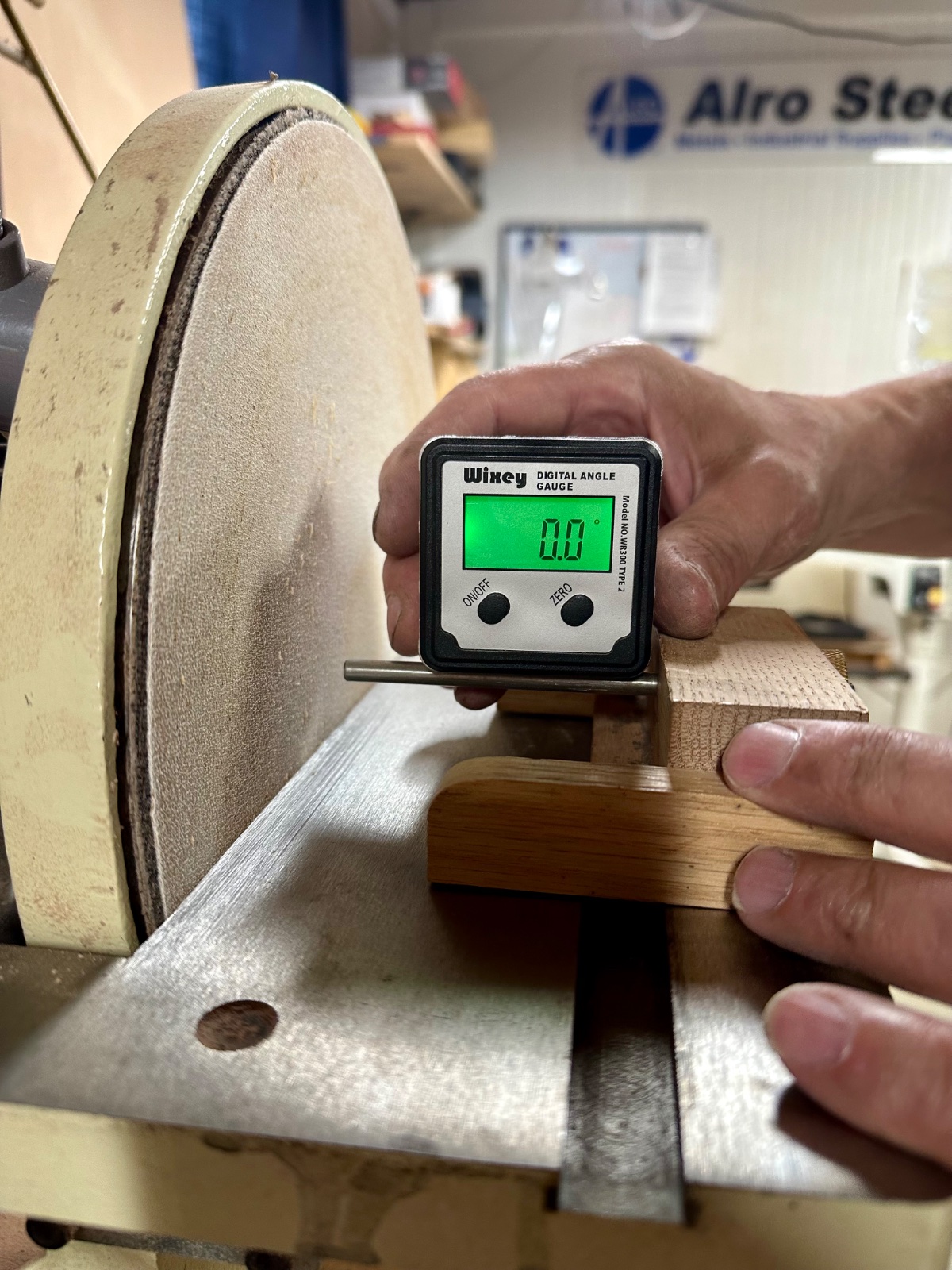

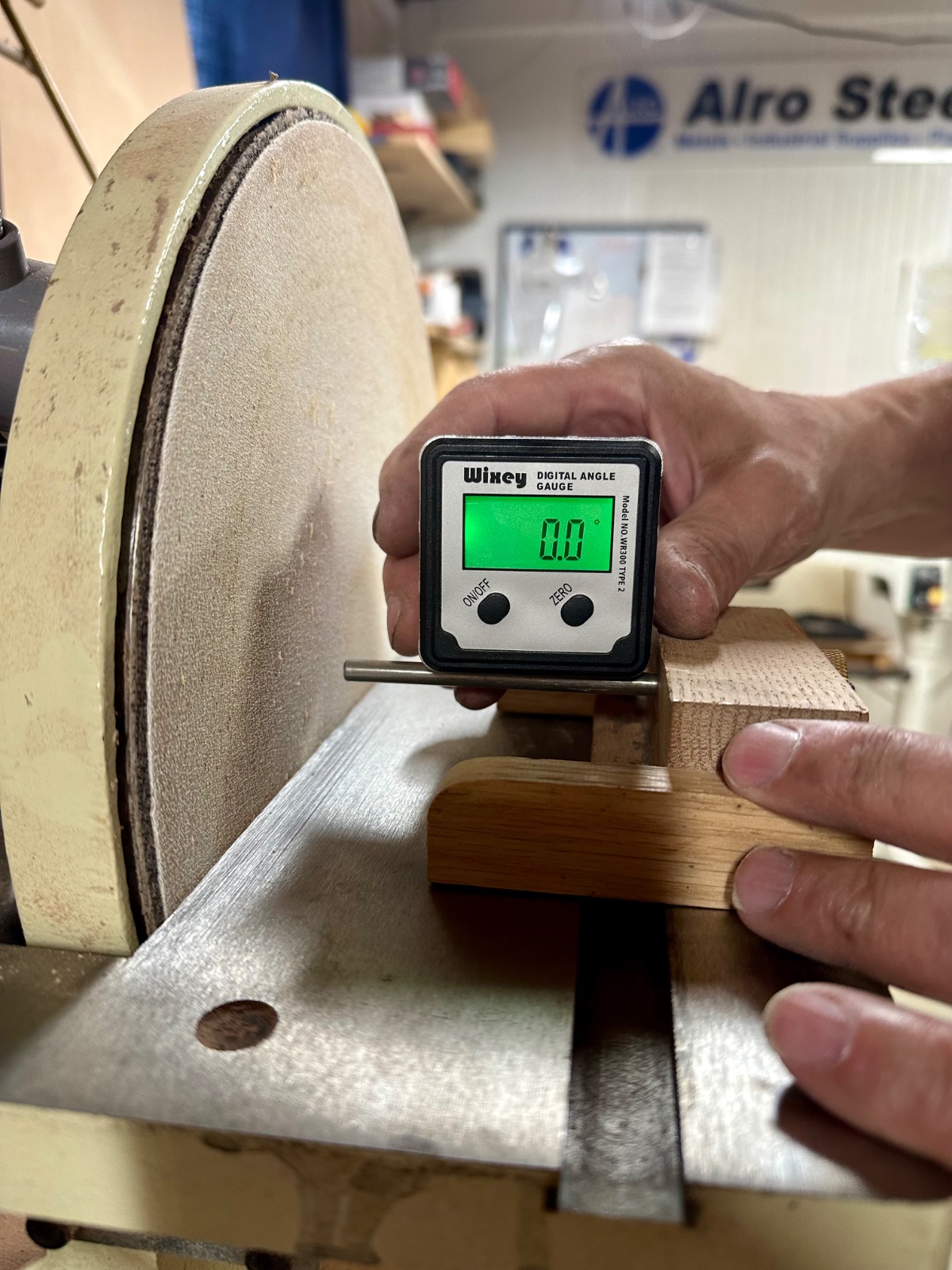

Bob, here's what I use. The set screws in the bottom let me adjust the level. The knurled ring on the back does nothing except keep me from losing it. It just slides in my disc sander slot. For some reason I cannot reply yo your PM.

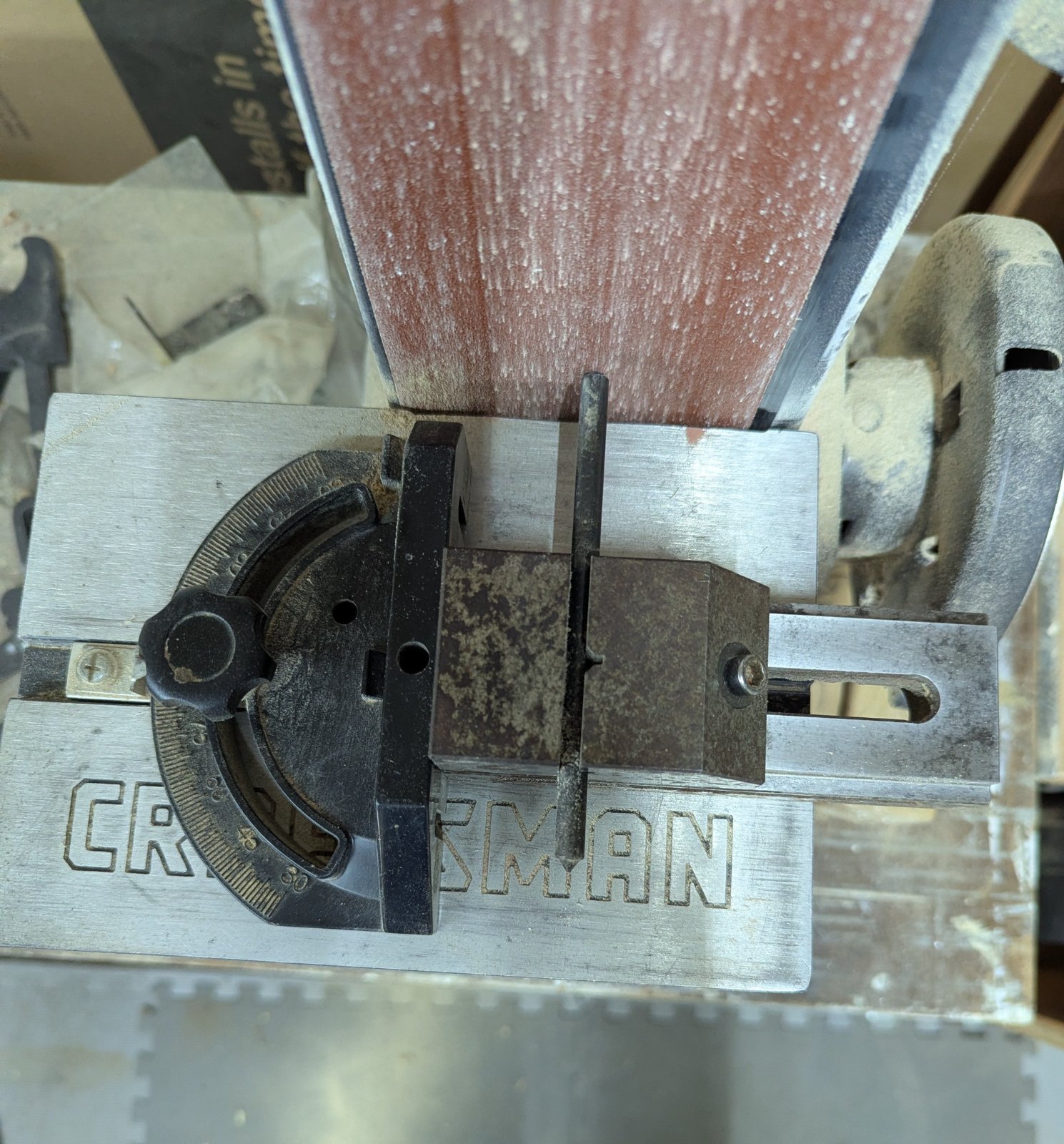

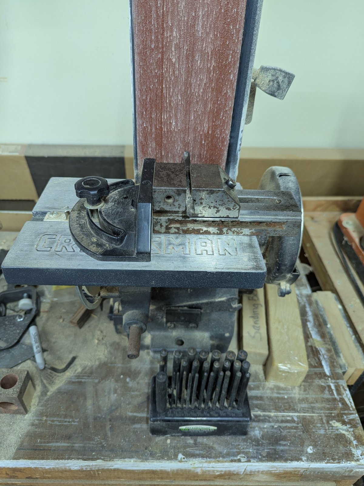

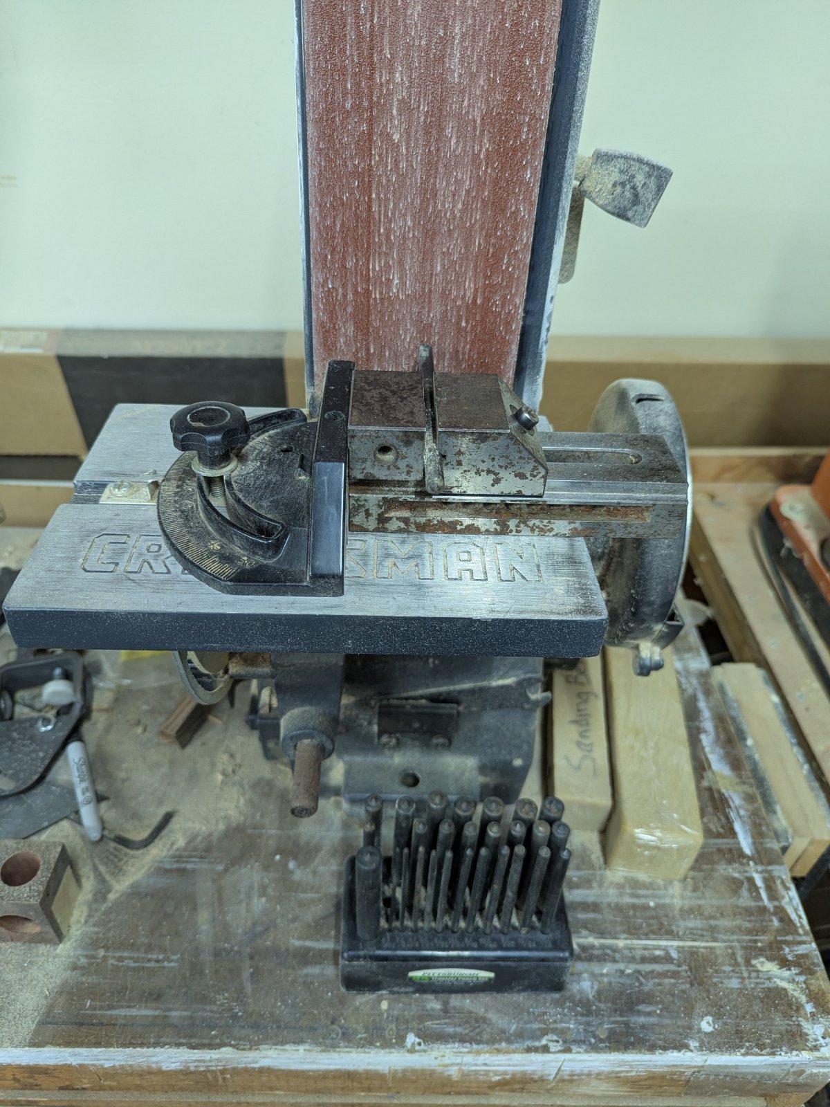

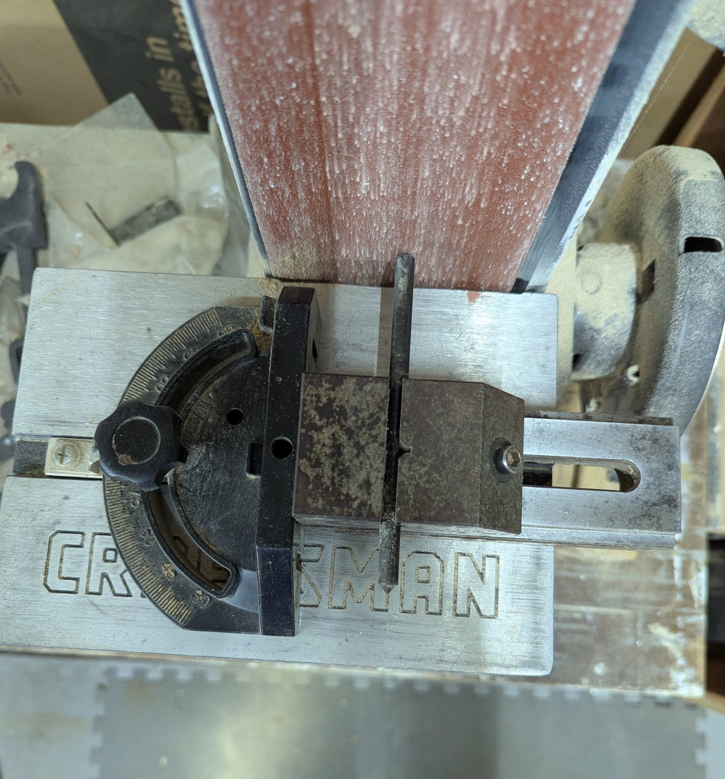

When I worked as a Machinist I acquired a few pieces of equipment, one of which is a die makers vise. Then as a Woodworker I have a benchtop belt sander. I use the vise butted up against the square and belt sander with a set of center punches I bought from HF to sand my barrel ends square, rotating the blank while advancing it into the belt. Checking the end from time to time seeing how close I am to the tube. Once the tube has been reached I can here the sound change and I know to stop.
