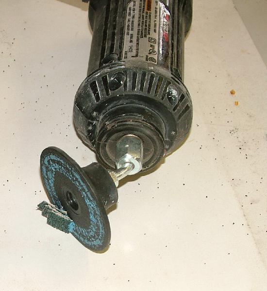

I've been using this.. but my finishes aren't coming out so good..
I use my high speed Genevieve System from Woodcraft and couldn't be happier with the results. pricey - YES - but the time saved is amazing. Contours are a breeze to get silky smooth.

Yes, power sand with the lathe running at a slow speed while using an electric drill with sanding discs. It greatly reduces the time needed for sanding. I also change the direction the lathe is turning with each successive grit. This helps to get a smoother surface and it is easier to see when all of the scratches from the previous grit have been removed.
On the walls of the bowls I have been using the flap wheels in a drill. 60, 120, and 240 then finish by hand 320. The bottom corner of the flap wheel can be broken down by sanding it on a disk grinder wheel to better follow the bottom curve of a bowl. For the bottom I use flat discs and pads. If you make your own most Army surplus stores carry 1, 2, and 3 inch velcro and a sleeping mat works for the pad.
