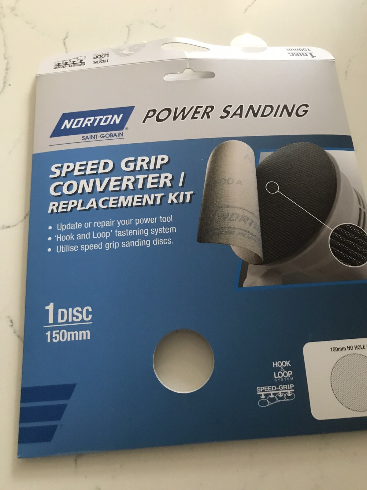

I sent a photo of a disc conversion that I used. Had the same problem
