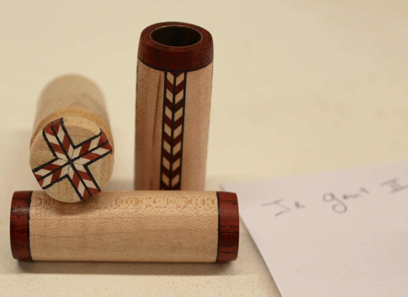

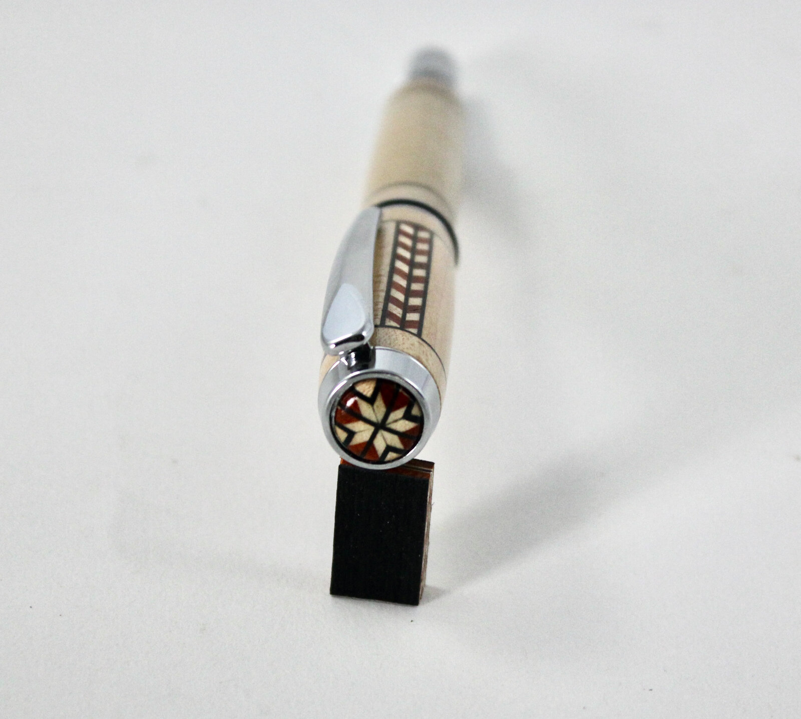

Issues with Padauk/Maple sound familiar and makes sense. I actually have had good success with Myland's Sanding Sealer - it is intended for this! Your experience may be different than mine which is pen scale based.
These are small scale Padauk and Maple - and Sanding sealer, and no bleed-out.:
