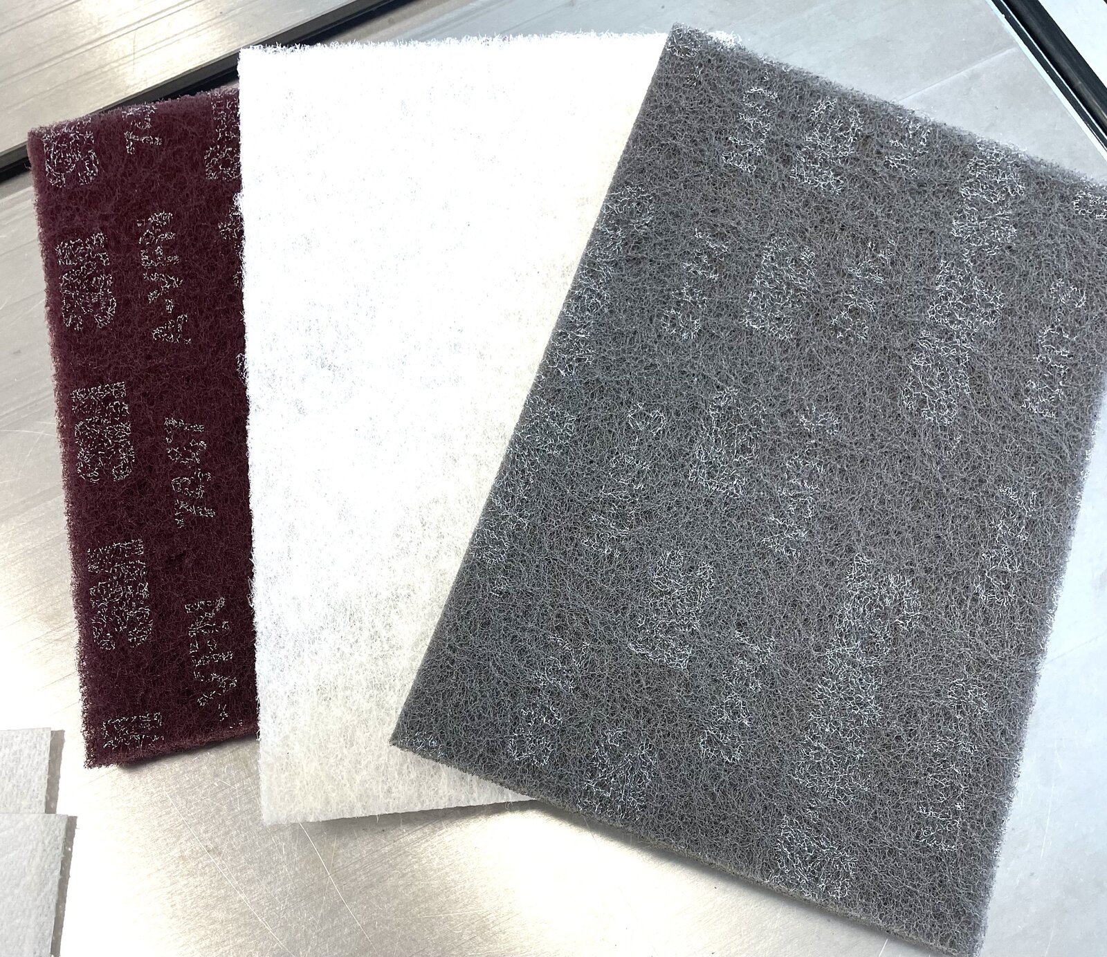

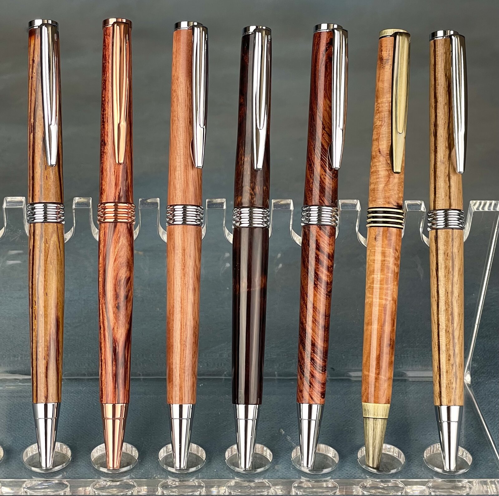

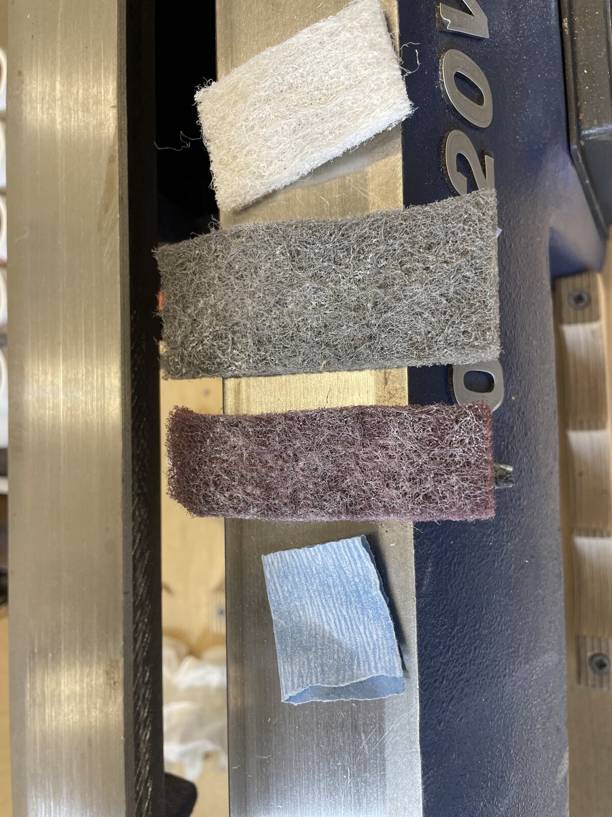

I just finished the pens shown below. They were sanded by 400 grit sandpaper after turning and rubbed with the three Scotch Brite pads shown below. You can see they have been used a bit. After cleaning with DNA and allowed to dry they received 4 coats of 5 cps thin CA and 8 coats of 50 cps CA. They were again sanded with the same four objects: 400 grit Norton 3X sandpaper and the three colors of Scotch Brite (red, gray and white). I then buff the blanks for a few seconds using Beale buffs #1 and #2. The pens as usual pleased me and will definitely sell.
I buy the generic pads from Amazon in the large sheets shown in the first photo and cut them to size. Easy peazy and dependable.

They are used for small and larger turnings like stoppers. These Scotch Brite have sanded 20-30 pens each. Sandpaper poops out after 3-5 pens.

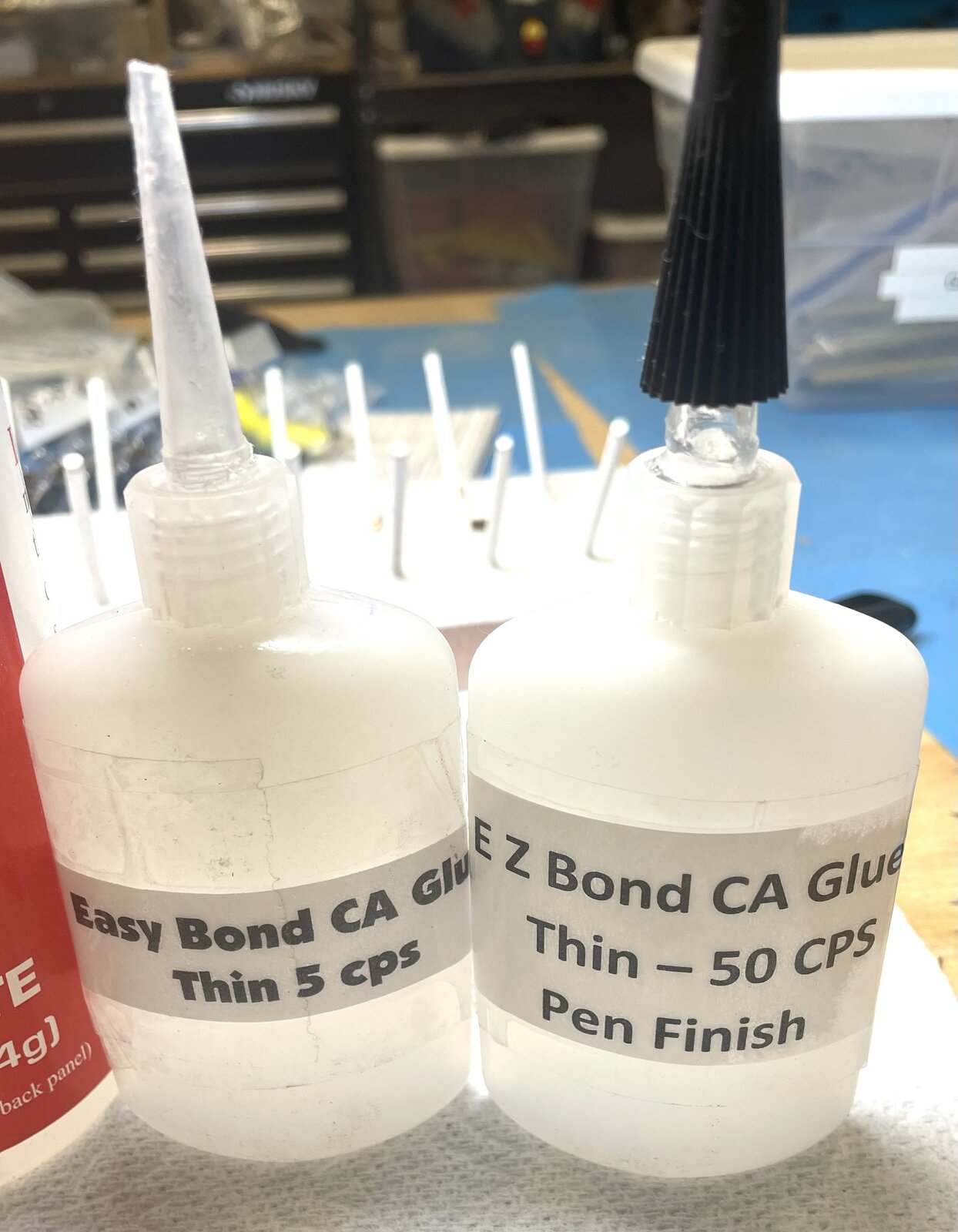

1. I apply CA with small pieces of Scott blue towel. I buy CA wholesale by the quart and don't worry. For a $150 pen CA costs are inconsequential to me.

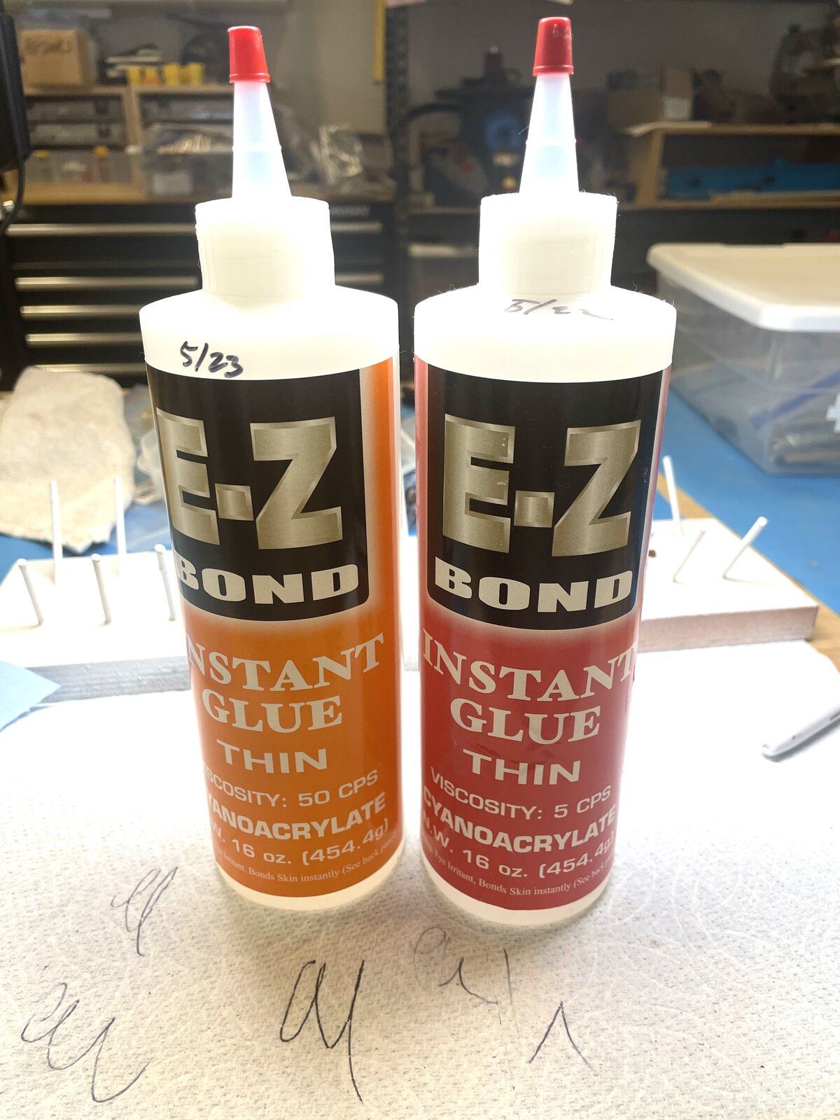

This is the size bottles (16 oz) I buy when shopping for CA. I then fill small ones while keeping the big bottles under refrigeration. It lasts for years though I go through CA pretty fast. It's far cheaper- enough so CA costs have become inconsequential.
I buy directly from E-Z Bond at wholesale prices.
