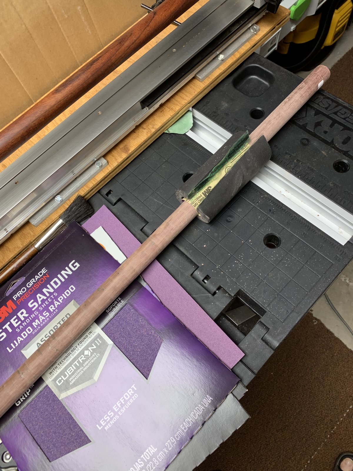

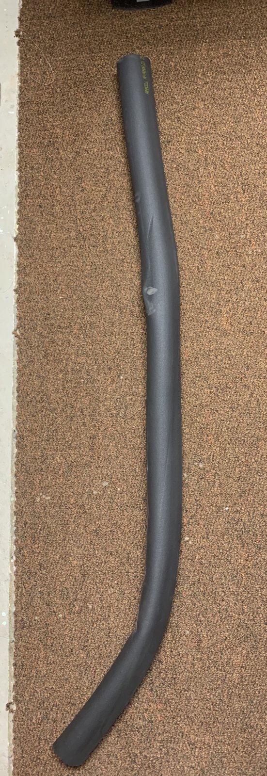

I made a beach & moan post on my Wood for Cane thread. Not in love with sanding a long dowel. JT suggested thinking my way through. Use my head? Never thought of that. I put a piece of pipe wrap on a non slip sandpaper and it definitely helps. Would like to see how others do little things to make sanding easier. Thanks.

Very good work around. Many times doing repetitive things requires imagination to overcome boredom and fatigue especially when doing the same thing over and over. Sometimes it needs to be addressed for health reasons too. But if sanding one item we probably just hand sand it and be done with it. Many ways to get things done. Good job.

Interesting jig. If I could cut a piece of PCV in half I'd sandwich the sandpaper and foam between them... apply pressure/hold together by hand or use rubber bands.
I made a foam rubber sanding pad that fit in a piece of 2" PVC pipe. I only used about 6" of pipe, and about 2/3's of the circumference. Leaving it open on one side for dust extraction. It was almost like your pipe insulation gadget. I would guess they work the same. Very slow speed on the lathe for turning the dowel, and moving the sander gadget constantly from one end to the other.
If I need to do some flattening first I us a piece of aluminum flat bar with some sticky back sandpaper on it with the lathe turning around 1000 rpm until its flat and true. For the bulk of the sanding on a dowel like you have here I would grab my dewalt random orbital sander. With the dowel turning about 500 rpm and light pressure on the sander. Just keeping in mind not to start with to course of a grit as it will take alot of material way very quickly. Maybe a 220 grit to start and then up to 600 grit. Then finish by hand sanding with the grain. That is where I would use your wonderful creation with the pipe insulation of witch is a great idea.

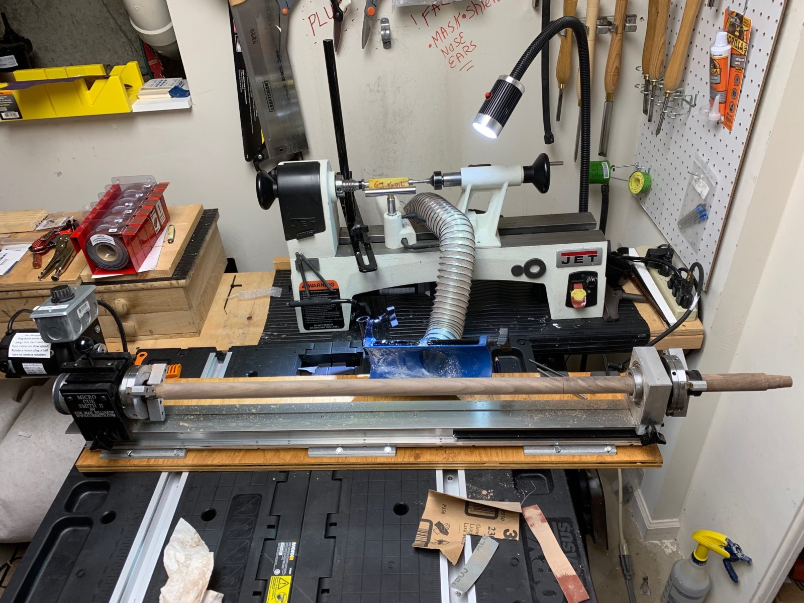

just got this. It has an extension... 48"total
It looks like you have plenty of length with that. Just out of curiosity I saw that in a previous post of yours who makes it or is it homemade.
Disregard I just zoomed it on your picture and could read the name plate.
I have 2 Taig lathes. The one shown is by Chris Hightower. A Micro ll large bore. It is portable 36"+12" extension. He is known as Cue Man Billiard Products. He also makes a Cane lathe. In additional I have a 48" large bore by MidAmericaPool. I'm slowly learning to use both for other than cue repair. Both are more capable than I am. It's great for boring a ring blank. I feel like I'm cheating.
