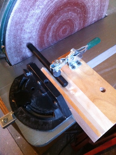

Are you talking about something like this?

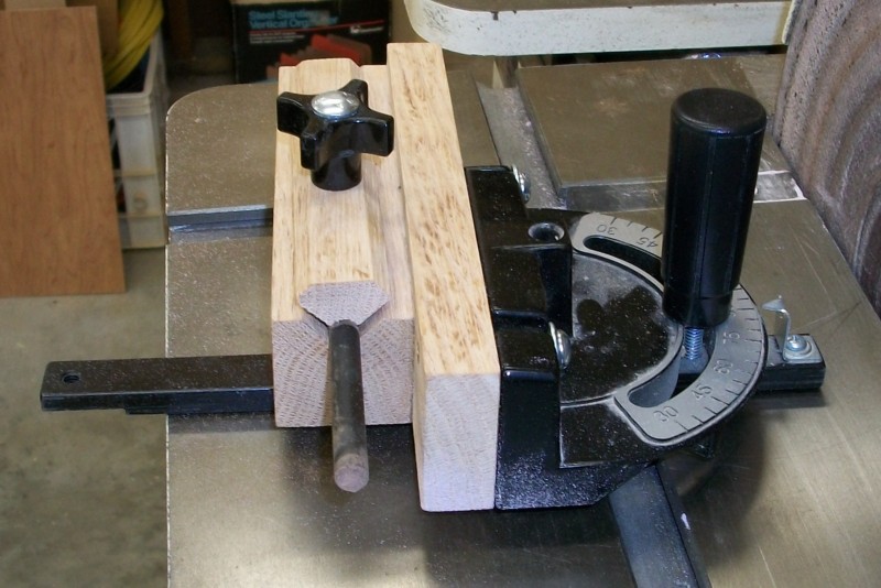

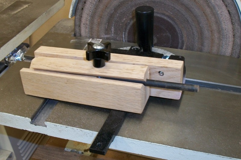

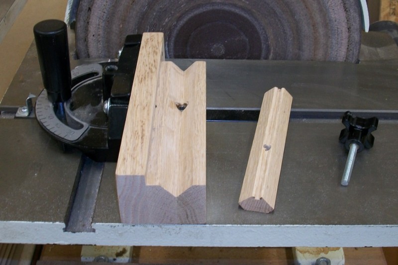

After seeing a discussion about blank squaring jigs on IAP a few days ago, I grabbed a few pieces of scrap and made one. As you can see in the photos, there are four pieces of wood. I used red oak because I have a good bit of it. I cut one piece to a width equal to my miter gauge height and about 8" long. For the "V" groove, I beveled the edge of a piece of oak, cut equal lengths and glued them together. Then, I glued those to the piece that attaches to the miter gauge. I cut another piece of wood to act as a clamp in concert with a knob and bolt.
I drilled holes for two threaded inserts to match the miter gauge slots and one hole in the "V" groove for a knob and bolt to tighten the clamp onto a rod. I already had a set of punches from HF, so there are sizes to match all the pen tubes.
After choosing the appropriate punch, it slides into the holder. The clamp gets tightened and I'm ready to square a blank.

Those are nice, what would something like that cost to make and who could I get to do it?

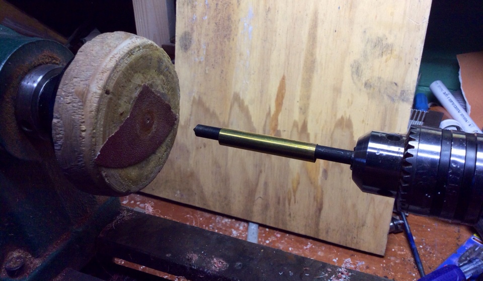

Without a table on your sander, you will need to build one. It would be much easier to sand on your lathe. It's how I trim all blanks, before and after finishing(when using CA). Here is a quick photo I snapped of my setup. You probably have everything to make one. Hope this helps.

You've got some torn grain on your sanding block. ;-)
