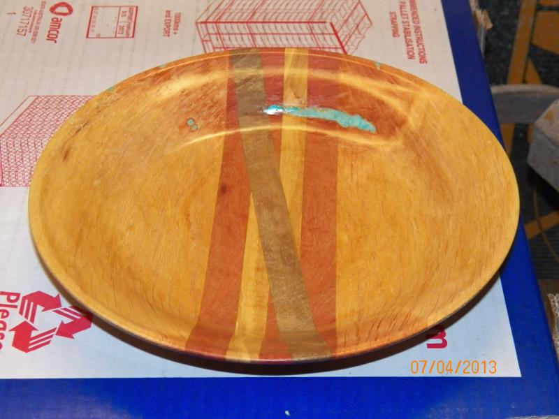

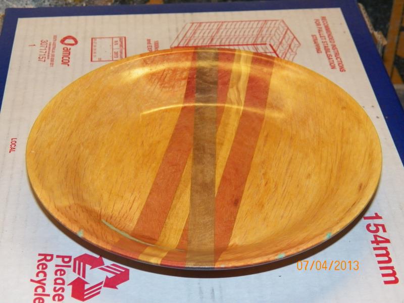

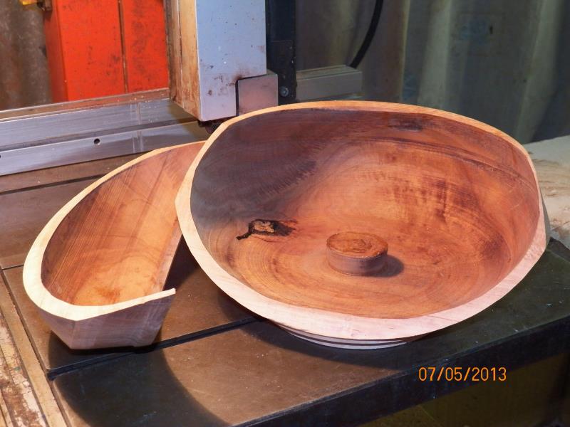

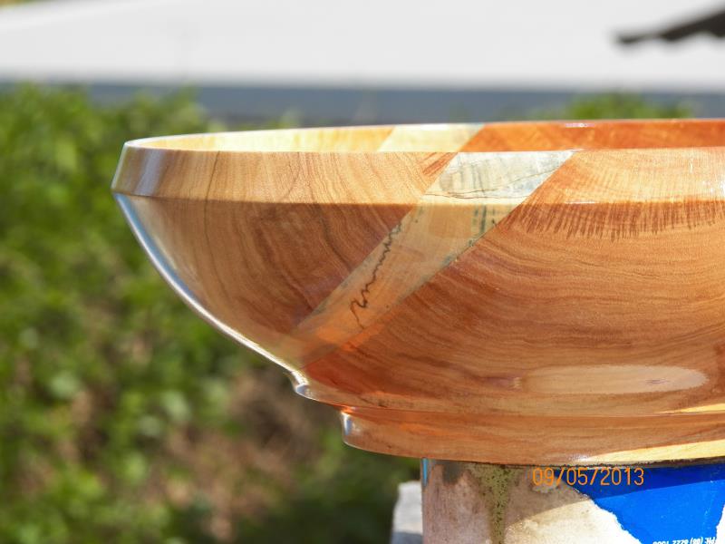

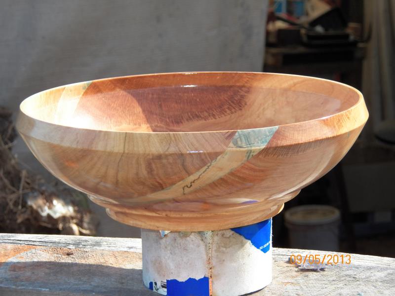

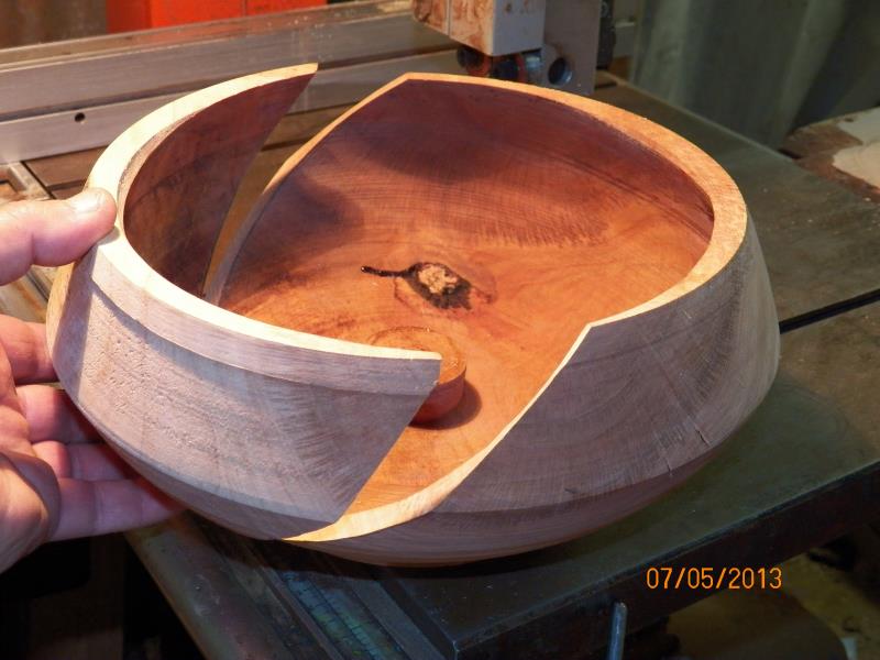

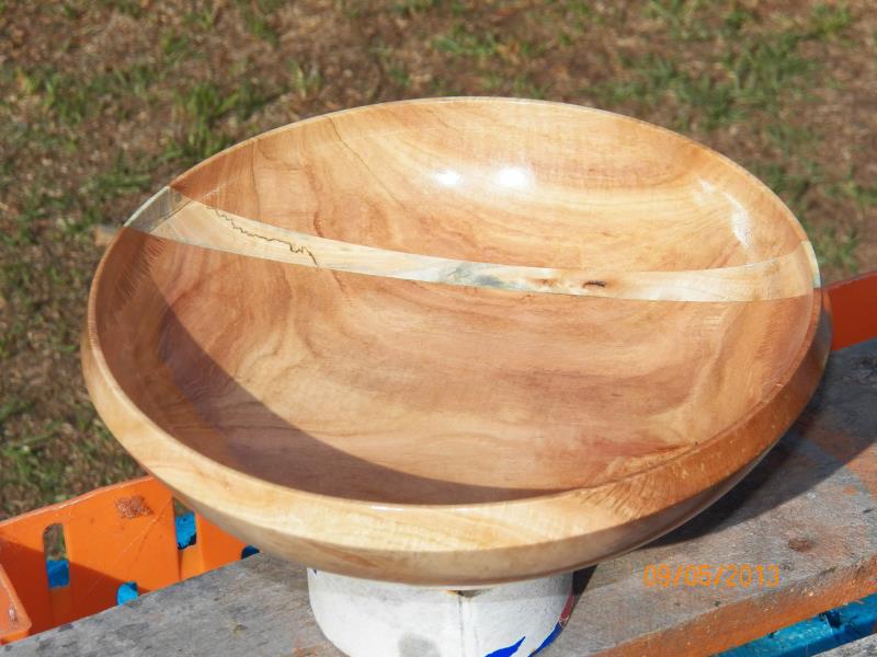

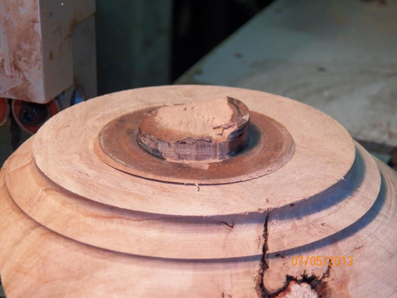

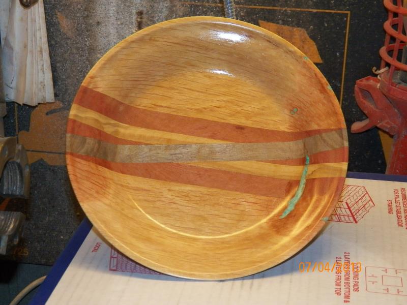

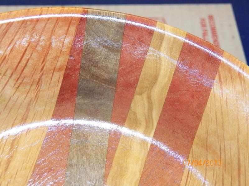

I have shown here many bowls and other pieces I've made, many more are not shown however, there are a few that I think pertinent to this thread sentiment so, not going too far back, here is one that I finished a few weeks back, the wood is the Australian Casuarina and this piece was turned green (day after the tree was cut) about 18 months ago, it was sealed with Fungishield and put a side.

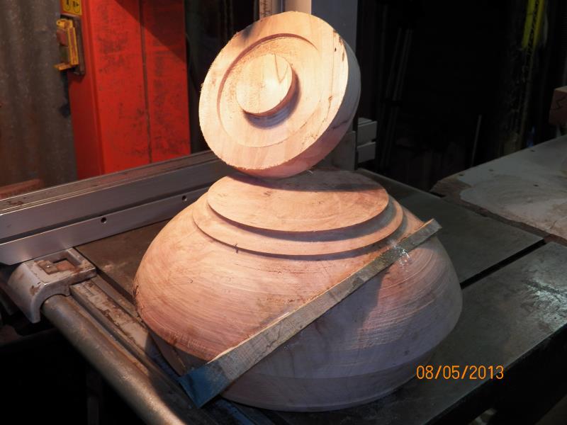

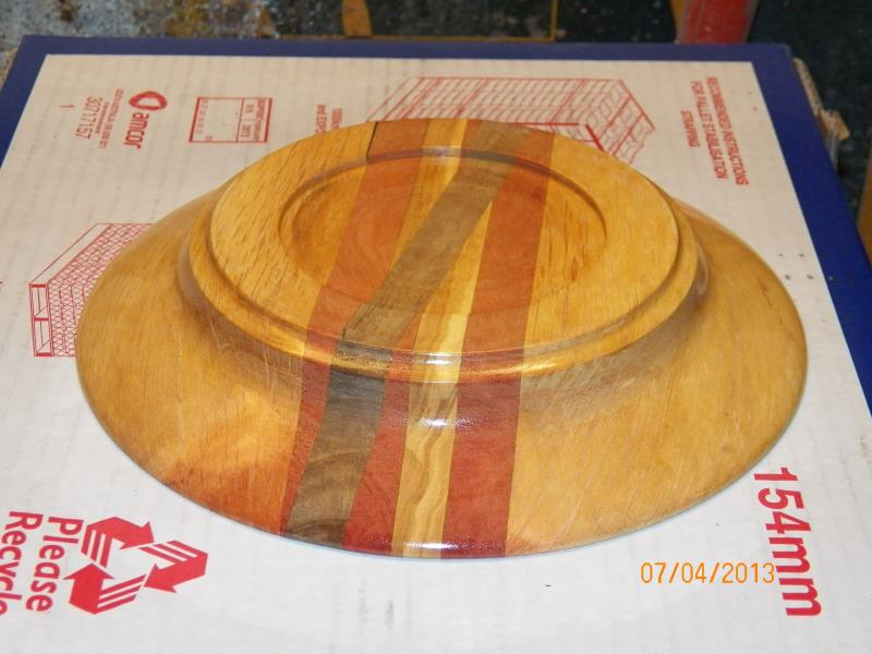

When I saw it a few months back I couldn't believe how much out of round that piece was, cracks weren't the problem the oval shape was. Well, how much out of round...??? just look at the amount of wood segmented in there, there is how oval it was. I used Red Gum root and Olive wood first, and then Walnut to cross the pattern, this is what I endup with.

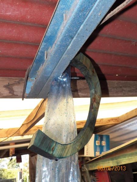

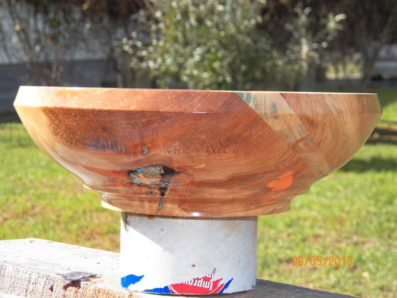

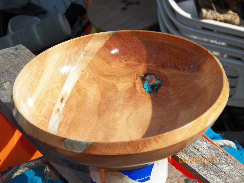

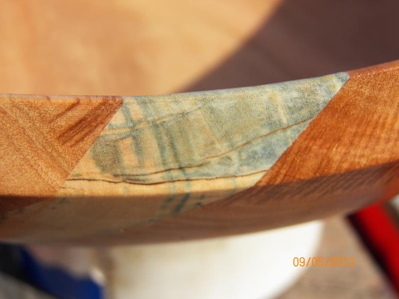

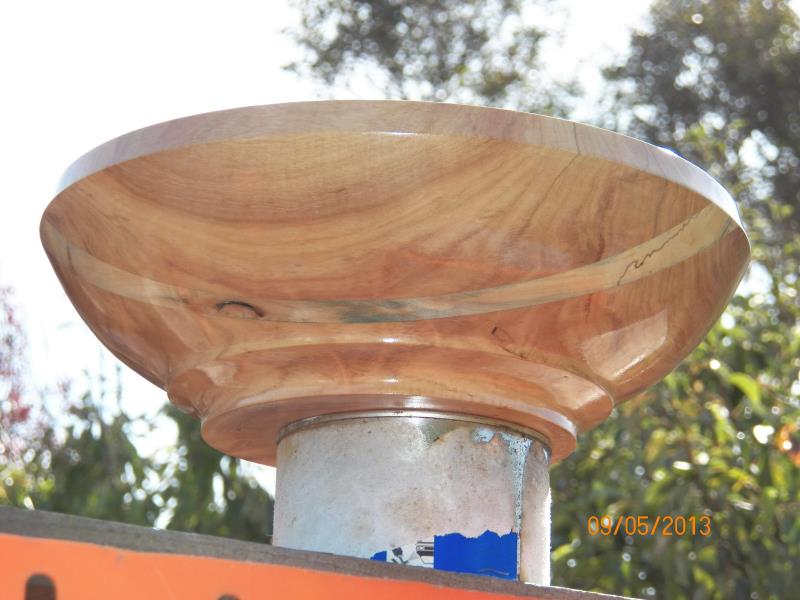

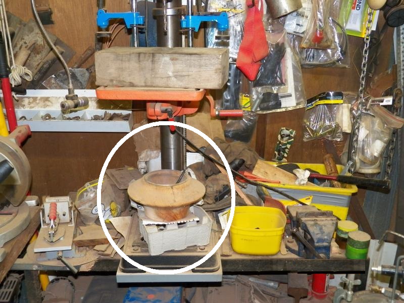

Here is the last I've done, a couple of days ago, the wood is Sugar Gum and the segment is made from Tortuosa Willow that I stabilised blue but, unable to fit it in the vacuum chamber, I simply used a 1lt of blue stained Cactus Juice and a heavy duty plastic bag, strapping in such way that the liquid covered all the wood.
I looked OK after 20 hours in the solution but I felt a little too light so I knew that the penetration couldn't have been 100%. Vacuum may have dome a much better job but, and as I was turning the segmented piece glued in place, I could see that, as deep as I would go, the less blue I was getting, I little spalting but no much.
It was a shame that the wood didn't take the colour without full vacuum, it would be looking very nice, I had planned to used Turquoise for the flaw filling so it would match OK but still, it looks OK...!:biggrin:

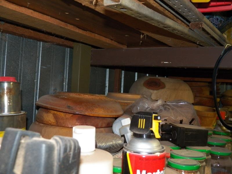

I have many like that some years old, one in particular is a medium size bowl/vessel type made from Majestic Olive wood heartwood, I rough turned it about 7 years ago, it cracked and buckled considerably as most Olive wood would/will, a year later and with the wood dry I gave it another spin that improved its condition but far from acceptable, to me...!
I have had that piece in a place that I see it everyday, is actually serving as a container with some small stuff in it that I use often, I have created a dozen shapes and finishes for it, in my head since however, I am yet to grab it and finish it. I know that I can turn all the flaws and cracks into features, in fact the grain is so beautiful that almost anything would make it look good however, I'm yet to feel the urge to tackle it, one day though...!
