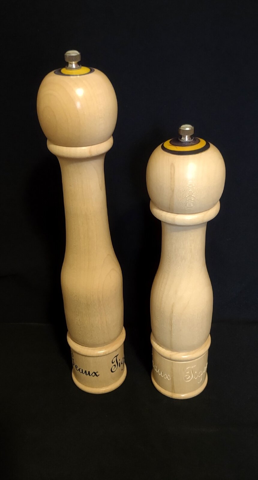

A set of Salt/Peppermills that I made to commemorate the LSU Tigers winning the 2023 National College Baseball World Series. The wood is Maple with a spray lacquer finish. The top is inlayed with a piece of purple and gold laminate and the bottom portion was engraved using a CNC. They are 10" and 12" tall.
