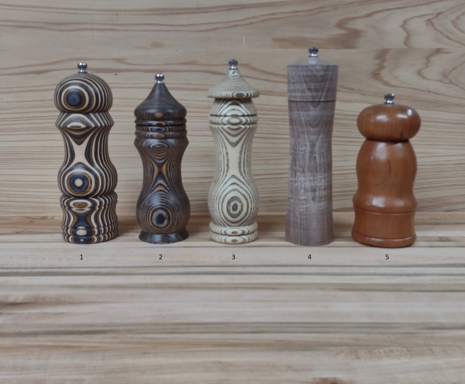

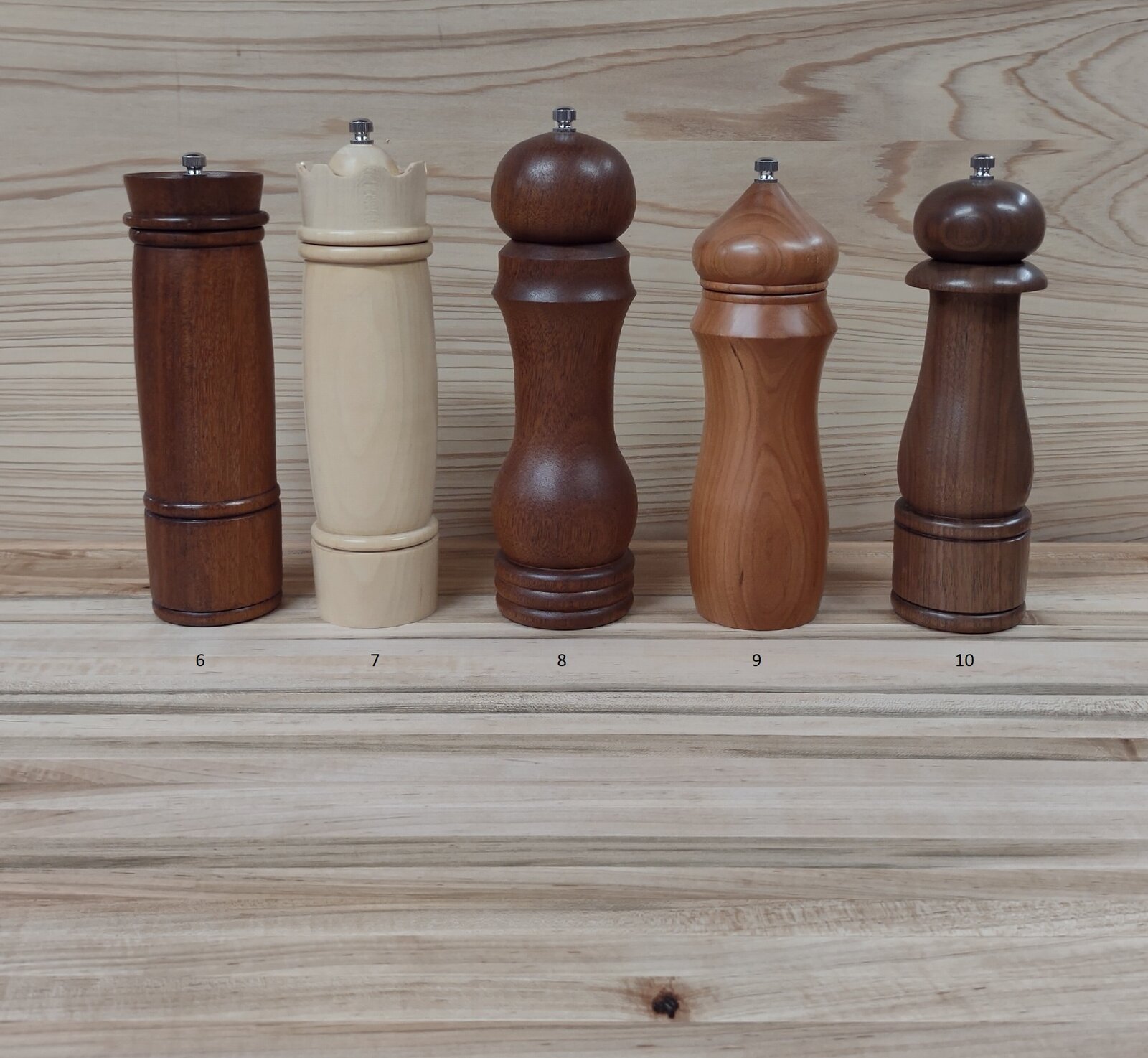

Some recent Salt/Peppermills that I completed. The woods are:
1,2 - Laminated Colorwood
3 - Ash w/ Black Gilders Paste
4 - Walnut w/ White Gilders Paste
5,9 - Cherry
6,8 - Mahogany
7 - Maple
10 - Walnut

Nice work. With traditional style mill kits, how do you keep the holes centered and even? I have run into issues where the top screw on nut does not end up centered in top of the mill. Nost sure what is causing it exactly.

I do the ceramic grinders from Ideal out of Denmark.. they do both salt and pepper very nicely. I only do the crush grind mills... don't really like the standard styles... I think they are too hard to get dimensions just right.

Thanks for all the comments, they are appreciated. These kits do use the ceramic mechanism. I do like the ceramic parts over the metal for the simple fact that they can be used for salt or pepper. Chuck, you are right about the standard style kits, you either have to just right with your measurements, or do what I have done before, cut the grinding shaft off and re-thread the end of it. I prefer the Crushgrind kits, but the store that buys my grinders likes the grinders with the adjustment knob on the top. As to getting the hole centered in the top, I drill my top using a 7mm drill bit, then mount the top on a pen mandrel and turn to size.
