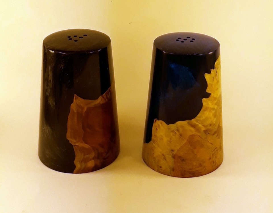

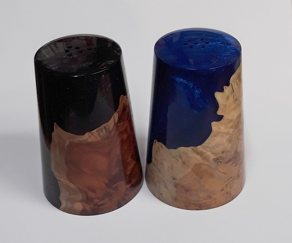

I've had these blanks from George Watkins ( From the Tree ) for ages and my LOML wanted something new on the Christmas dinner table so I made up a pair of salt and pepper shakers. I can't find my camera so just crummy phone pics which don't really show the colours. :redface: Sorry, so two similar pics to try and show the colours.
They are approx 3 inches tall. Pearled black for pepper and pearled blue for salt with burls which I can't remember what they were. :redface:
But you know what they say......Happy wife,.....Happy life.:biggrin:

Is there a kit for these?? Do they have a container?? Looks good for sure. Now make some out of stainless. Gives me an idea. Amazing my mind does not shut off. It is a curse :smile::smile::smile::smile::smile:

JT, no kit...they were solid blanks that George makes mostly for those little lidded boxes he shows here now and then. (With the little Lego man prop)
I bored them out to about 30mm internal diameter and then recessed a fixed plug with a threaded (12mm ) fill hole. All very easy.
