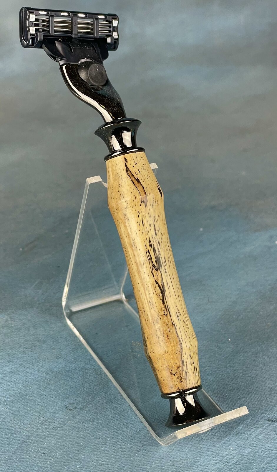

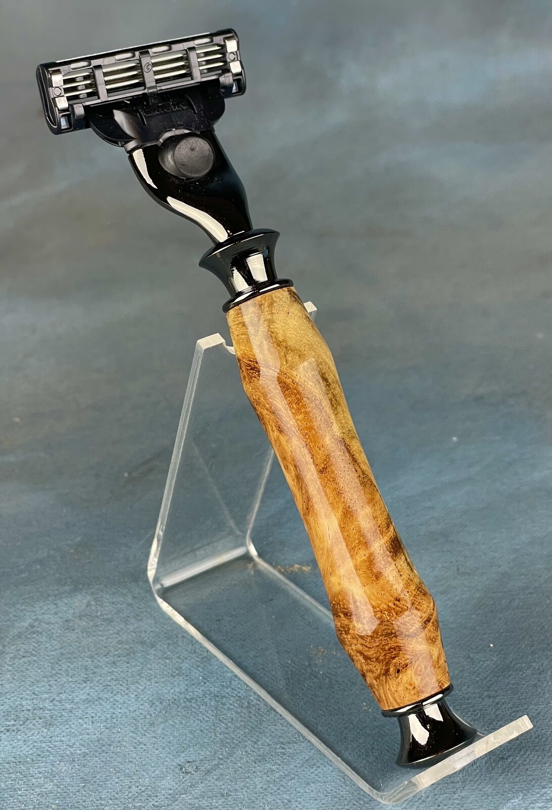

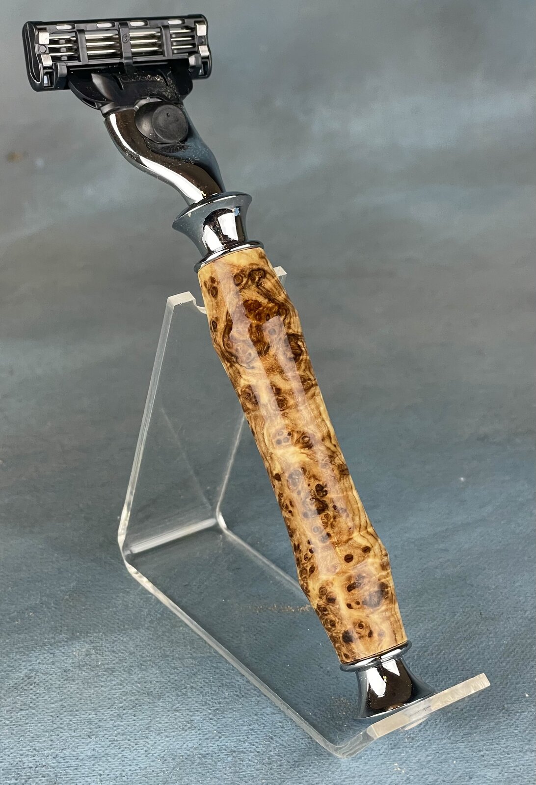

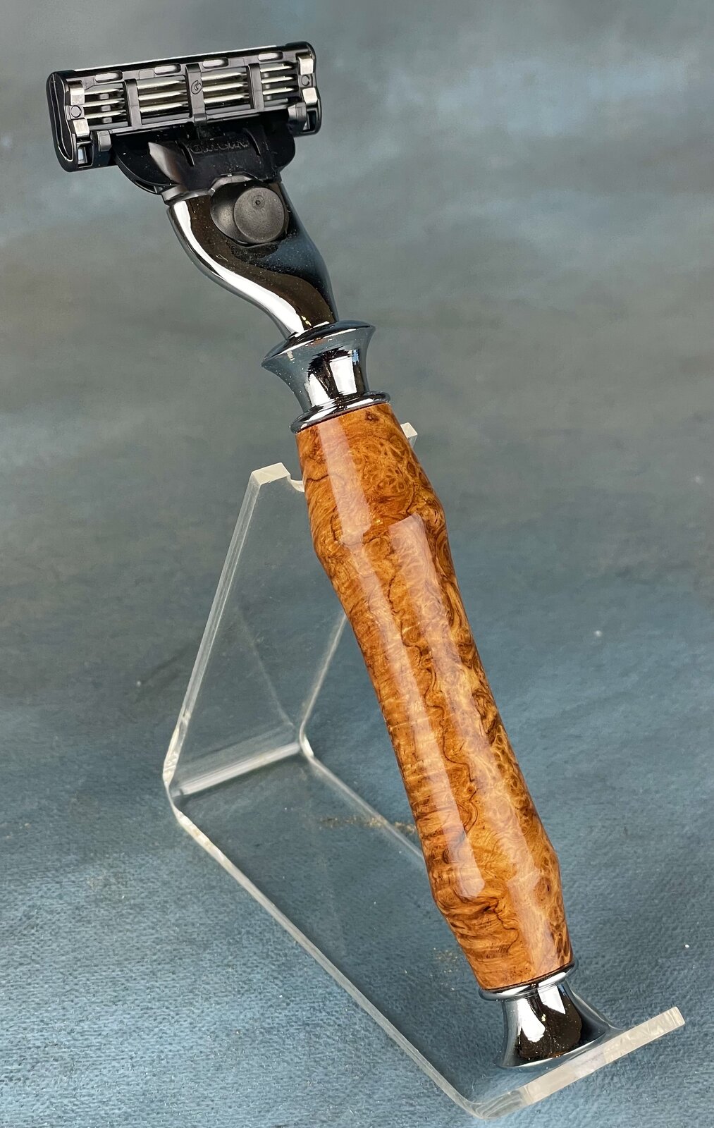

Three sold today so to keep with my philosophy I made four new ones. More figure than shown in photos for each razor.
LtoR
Amboyna burl
Black ash burl
Alamitos burl (Indonesian)
Spalted tamarind
